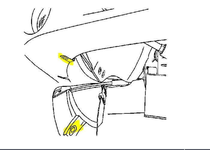

Can i change to fog light bulbs from under the car or do I have to remove the headlights
2005 PONTIAC SUNBIRD
157,000 MILES
QUIKWAL39
There a flap under the fog lights that can be removed but I don't know if that would give me access to the fog light bulbs. Thank you for any advice.

Hi:
To gain access, partially remove the front edge of the front fender liner to gain access to the fog lamps. Take a look at picture 1 and let me know if it helps.

QUIKWAL39
This picture is not familiar to me. There is a horizontal cover under the car with some nuts holding on. I was going to undo these nuts to see what's underneath. Just wondered I can access the fog lamp bulbs from under the car. The video shows removing the main head lights to access the fog lights. It's not clear to me. Thanks.

  • 110,194 POSTS
I may know why the picture doesn't look right. You indicated it is a 2005 Sunbird, but they weren't made in 2005. I assumed that you meant Sunfire.
Let me know the model and year.

QUIKWAL39
Thank you for replying. You are correct that the Pontiac 2005 is a Firebird. I do see a cover
in the wheel well that has several 10mm nuts. Would I get access to the fog lamp bulbs by removing this cover? I plan to replace the low beam bulbs with brighter bulbs so would it be simpler to access the fog light bulbs at that time. I understand how to remove the main headlights and I watched a video on working on the fog lamps after the headlights are removed. I just wondered if it could be done from under the car.
Thanks again. Perhaps the diagram is correct but I'm having trouble matching it to the
underside of the car.

  • 110,194 POSTS
If you remove the inner fender or the splash pan under the fog light, you should be able to access them. Just to confirm, this is a Firebird and not a Sunbird or Sunfire, correct?

QUIKWAL39
Yes it is a SunFire, not a Firebird or a Sunbird. I must be dyslexic. Thanks for the info. I'll check that area.
