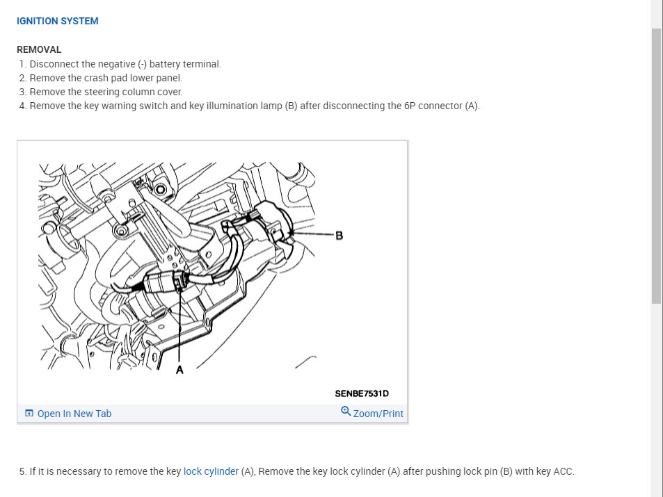

the FOB key will not turn ignition even when inserted into the switch. Assuming that the battery may be dead, the ignition should still turn.
Oct 16, 2014 at 10:47 AM
The key has a transmitter in it, but this is technically not a FOB. FOB stands for Finger Operated Button. So, your system uses a transmitter (chip) that is inside the key which has an ignition lock that needs to be released.
So, if the battery is drained the switch will most likely not unlock the ignition switch.
So, let's start with checking the battery using this guide:
If the battery checks out, then here is a guide that will help with this issue in general:
https://www.2carpros.com/articles/ignition-switch-wont-turn-stuck

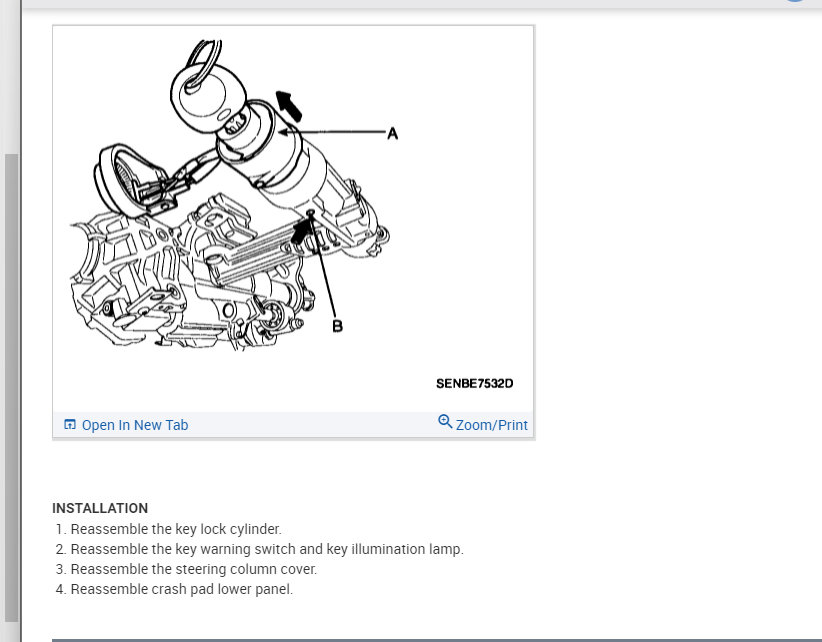

However, I am attaching the info from the manual on how to replace the ignition switch which is what I suspect we are going to have to do.
If you can't turn the key to replace it, then you will have to drill it out in order to get it turned and then replace it.
