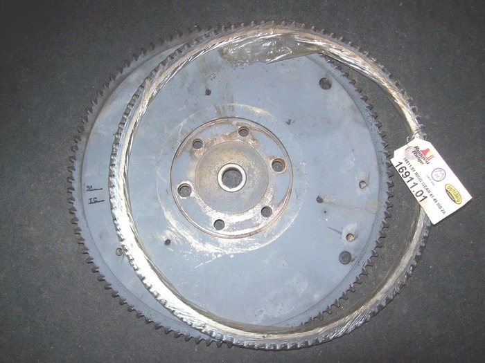

I was about to order a new ring gear for my flywheel, but got concerned about the tooth count. My truck is a 1/2 ton pickup. I am thinking I have 168 tooth ring gear.
The question is, how do I know for sure what tooth count I have without having to pull the old one out and actually counting the teeth?

Remove the starter or any sort of access cover on the bell housing.
With a ratchet or pull bar hooked the harmonic balancer bolt, you or your buddy can rotate the crankshaft at your desired speed (slow and stop!).
Wherever you accessed the teeth, this is where you start counting!
I use a sharpie to mark beside every fifth or tenth tooth, sometimes writing the count there to to prevent confusion.

I looked it up at three online parts stores with the info you provided. The transmission did not influence the results.
All show an outer diameter 14.096 with 168 teeth.
If you are unsure of the history (any possible modifications or swaps in the past) of the vehicle, counting would not hurt.
