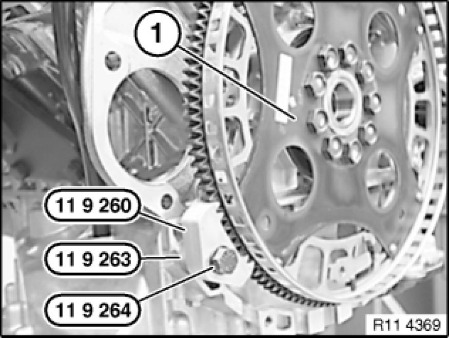

I am trying to mount a new flywheel and it isn't going all the way on the crankshaft flange. is there a special way you have to install it sometimes?

There is an alignment pin that has to be aligned for it to go on. Here are the specific directions for your vehicle. The attached pictures correlate with these directions.
__________________________________________
11 22 500 REMOVING AND INSTALLING/REPLACING FLYWHEEL
11 22 500 - Removing and installing or replacing flywheel (N51)

picture 3
Necessary preliminary tasks:
- Remove transmission See: Manual Transmission/Transaxle > Removal and Replacement > 23 00 019 Removing and Installing Transmission (GS6-37BZ).
- Remove clutch.
picture 4
Block flywheel (1) with special tool 11 9 260, use an old transmission screw for this purpose.

Flywheel (1) is secured with an alignment pin.
Fit new flywheel screws.

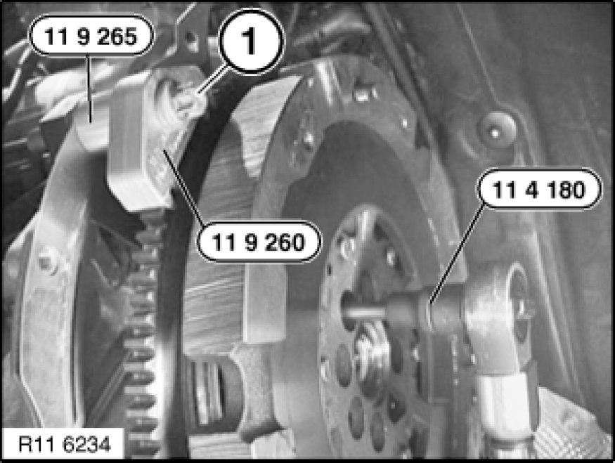

picture 5
Secure flywheel with an old transmission screw (1) and special tools 11 9 260 and 11 9 265.
Installation Note:
Replace aluminium screws.
Release flywheel screws with special tool 11 4 180.
Installation Note:
Flywheel is secured with a dowel pin.
Tightening torque: 11 22 2AZ. See: Flywheel > Mechanical > 11 22 Flywheel
