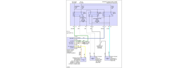

I had the heater on high then the line went all the way up high on my dashboard. i had been driving for about an hour. i heard bubbling noises and i lifted my hood and saw a little smoke from the radiator coolant container and liquid bubbling out and it was leaking orange liquid on the ground. I have had the thermostat replaced about a week ago due to the same problem. if i have a new thermostat, why is my radiator still making my engine overheat?

You should mention which engine this is and you may want to confirm that your cooling fan or fans run once the engine gets hot, because if not, then the temperature will just climb and climb until it overheats.

Usually when the head gasket blows and allows engine coolant to enter the combustion chamber it will blow a lot of white smoke from the tailpipe and will be hard to miss.

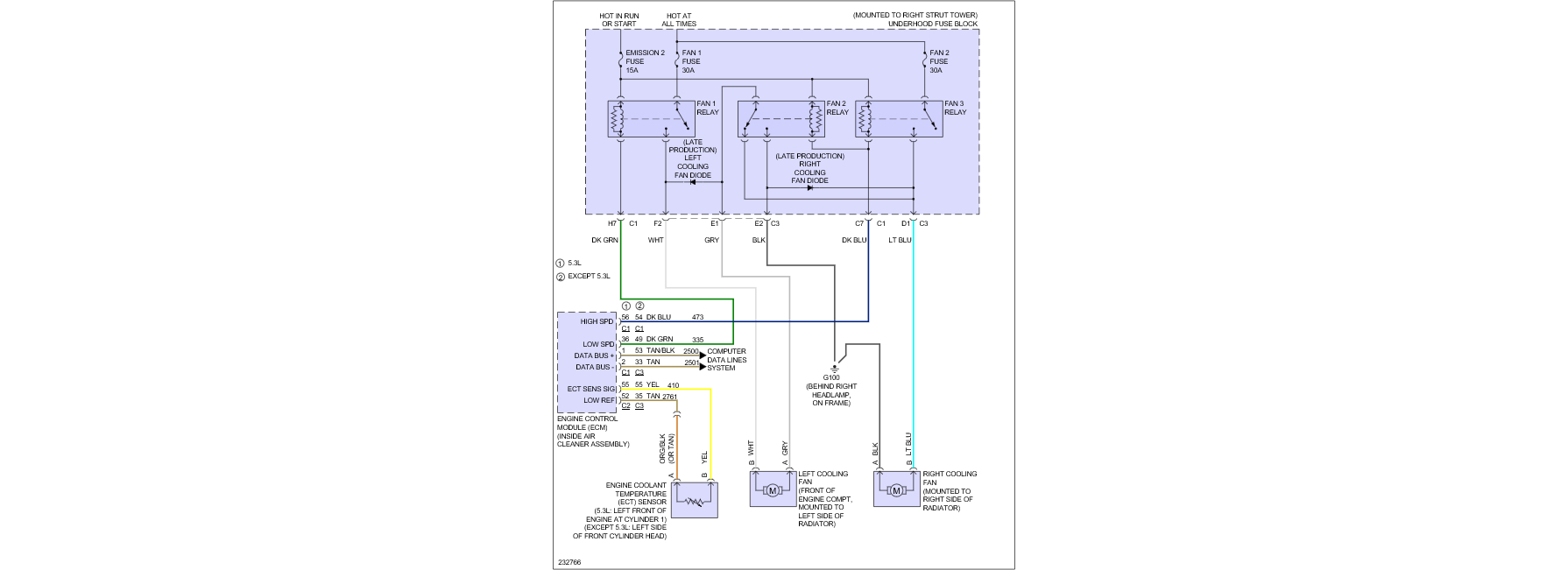

Have you confirmed if the fan/s run or not when it gets hot? If they do not check the cooling fan fuses and you could also have a bad cooling fan relay and there are three relays, fan one, fan two and fan three , plus fuses emission two, fan one and fan two all in the under-hood fuse block.
