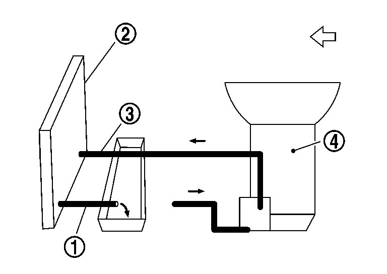

Here are the directions for the procedure. The attached pic correlates with the directions.
Changing CVT Fluid
1.Warm up CVT fluid by driving the vehicle for 10 minutes.
- arrow indicates: Vehicle front
- Radiator (2)
- CVT fluid cooler hose [inlet side (3)]
- Transaxle assembly (4)
2.Drain CVT fluid from CVT fluid cooler hose [outlet side (1)] and refill with new specified NISSAN CVT fluid in the CVT fluid charging pipe with the engine running at idle speed.
3.Refill until new CVT fluid comes out from CVT fluid cooler hose
[outlet side (1)].
NOTE:
About 30 to 50% extra fluid will be required for this procedure.
4.Check fluid level and condition. See: Fluid - CVT > Procedures > Inspection.
CVT fluid: See: Continuously Variable Transmission/Transaxle, CVT > Mechanical > General Specifications
Fluid capacity: See: Continuously Variable Transmission/Transaxle, CVT > Mechanical > General Specifications

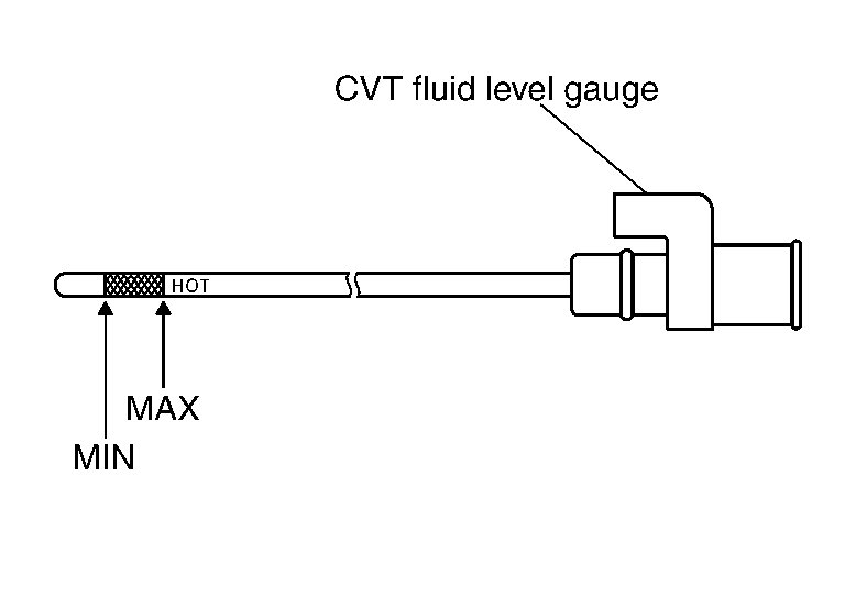

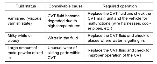

Once you finish, here are the directions for checking the fluid level and condition.
Fluid level should be checked with the fluid warmed up to 50 to 80 C (122 to 176 F). The fluid level check procedure is as follows:
1.Check for fluid leakage.
2.With the engine warmed up, drive the vehicle in an urban area.
When ambient temperature is 20 C (68 F), it takes about 10 minutes for the CVT fluid to warm up to 50
to 80 C (122 to
176 F).
3.Park the vehicle on a level surface.
4.Apply parking brake firmly.
5.With engine at idle, while depressing brake pedal, move CVT shift selector throughout the entire shift range.

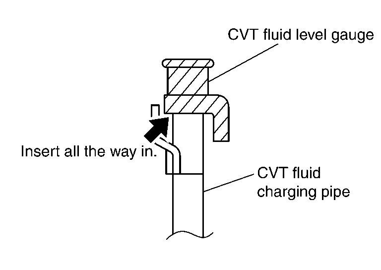

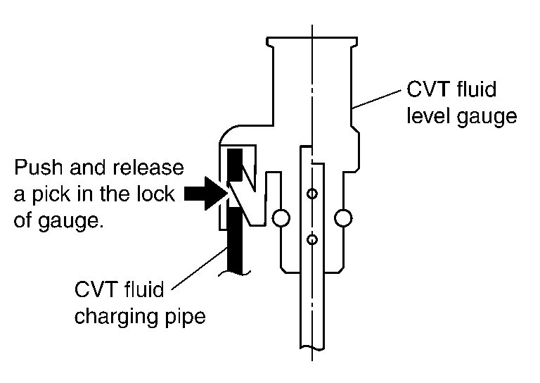

6.Pull out the CVT fluid level gauge from the CVT fluid charging pipe after pressing the tab on the CVT fluid level gauge to release the lock.
7.Wipe fluid off the CVT fluid level gauge. Insert the CVT fluid level gauge rotating 180
from the originally installed position, then securely push the CVT fluid level gauge until it meets the top end of the CVT fluid charging pipe.
CAUTION:
When wiping away the CVT fluid level gauge, always use lint-free paper, not a cloth rag.
8.Place the CVT shift selector in "P" or "N" and make sure the fluid level is within the specified range.
CAUTION:
When reinstalling CVT fluid level gauge, insert it into the
CVT fluid charging pipe and rotate it to the original installation position until it is securely locked.
