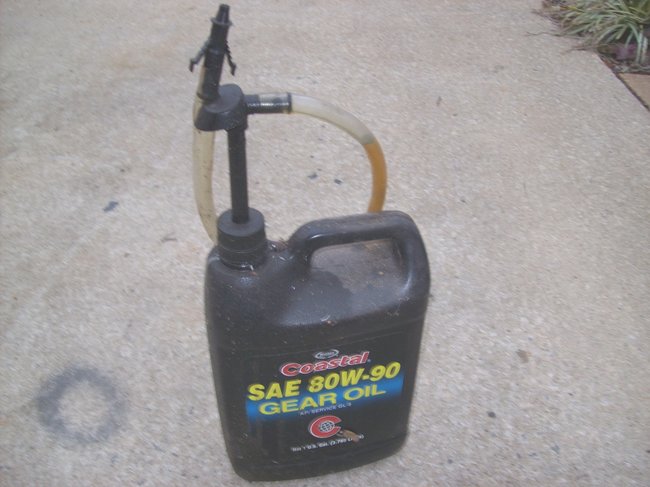

Back then in the 1940's manual transmissions used 90Wt. gear oil.
I also looked up gear oil for a 1938 Bantam Roadster on the net, It used 90 wt. in it's transmission. I'd feel confident with that!
I used the same in my 1977 CJ-5 (also in my previous five CJ-5s too!)
20 some odd years ago, 90 Wt. was a real common thing to find at an auto parts store and even in Walmart.
Now days you have to search for it if that is your desire, or you can use Use 80w-90 GL5 as a substitute. This is what I use in both of my Jeeps.
A few months back I was unable to find Use 80w-90 GL5 on the shelf at Walmart at 2 A.M. to help a friend out in an "emergency" by his standards!
We found this, a little pricey (as packaged/advertised for boat motor gears), but it is 90 wt and if it had been in a plain Jane container it would be much cheaper! My friend bought 3! See link below:
https://www.walmart.com/ip/Mercury-92-858064K01-Marine-SAE-90-High-Performance-Gear-Lube-1-quart/54188322

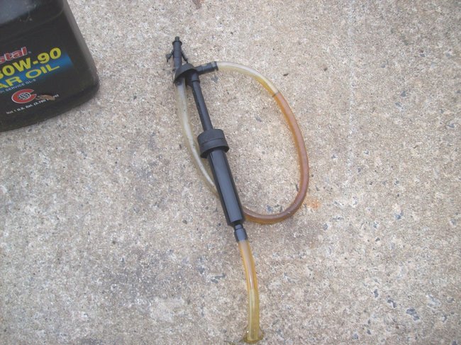

Pouring this stuff from whatever container you get into a cleaned out gallon antifreeze jug and then purchasing a cheap pump from an auto parts store (maybe $7.00) will let you fill up without making a mess!

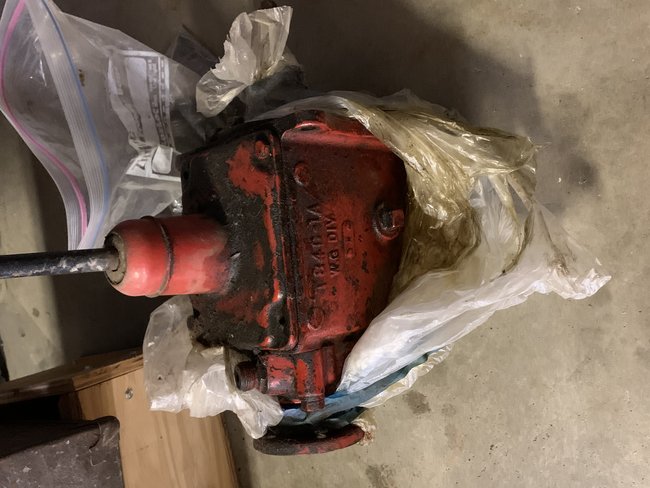

Hi, someone sent me a photo of the Bantam Transmission, by this photo can you tell how and where to add the gear oil.
Thank you, Kenny

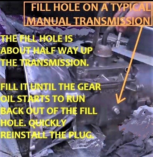

I made you a pic in "MS Paint". See pic below.
Does this make it better to understand?
The fill plug on any manual transmission might be on either side, about halfway up.
Most also have a drain plug either way down low on a side or down on the bottom side. Some even have a magnet made into the drain plug to catch any wear metal shavings so they don't circulate in the transmission.
Purple power (sometimes with a little brushing) and a garden hose sprayer will clean that grease off fast and easy and make it look really good! The ole time regular kind works just fine too.

Mr. Medic, hi, the transmission photo is not from my car, mine is still in my car.
If possible can you take a look at the picture I sent you?
The confusion for me is, if you look at the left side of the photo, there is a large top screw - bolt which may be where the fluid goes in, otherwise what is this top bolt for.
The side bolt maybe where the fluid flows out when it's full.
Please take a second look.
Thank you, Kenny

I was able to jack up the car, I'm all set. Changed the fluid must have been there for ten years or more. Next rear end oil.
Thank you,
Kenny

Gearboxes (transmissions) are not filled up nearer to the top due to fluid expansion and possibly "bogging" the gear movement down. The fluid gets slung by the gears to where it needs to go.
The fill for the rear probably works the same way, around halfway up will be the fill plug.
Keep us posted!
