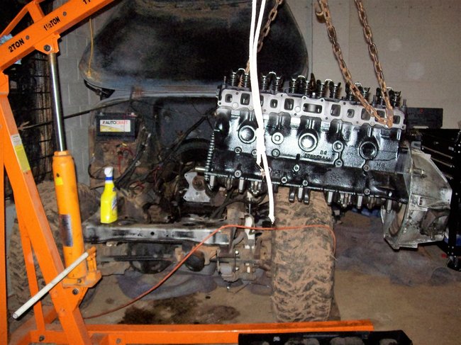

Case in point, I just helped my pal install a crated six cylinder engine in his 1980 Jeep CJ-5. New everything on the engine, barely would run, spitting back through the carburetor. Found that a brand new spark plug was not firing. Found this after hours of searching for the problem, my worrisome pal is now nearly bald from pulling his hair out!
