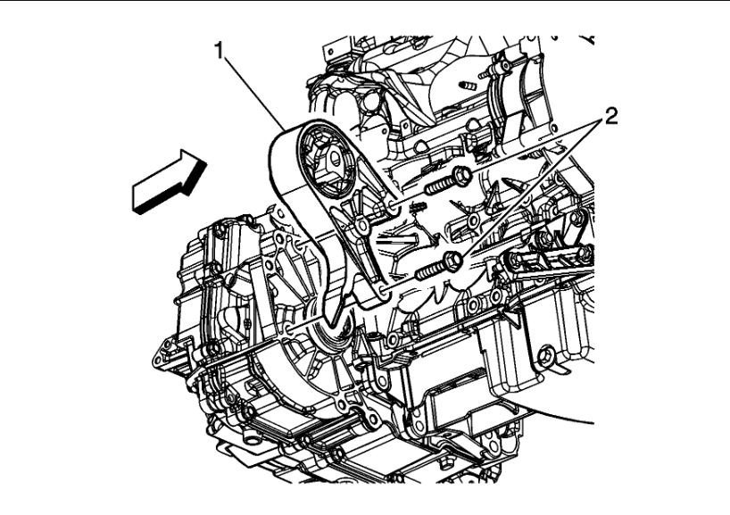

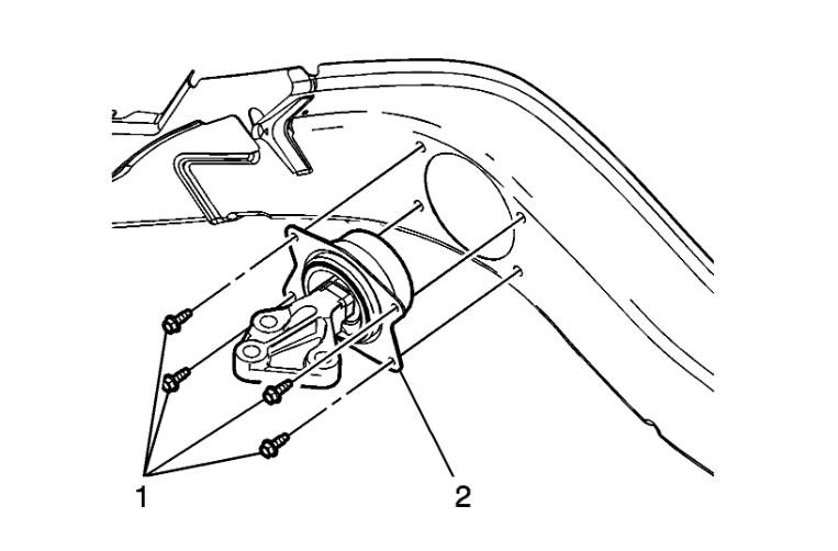

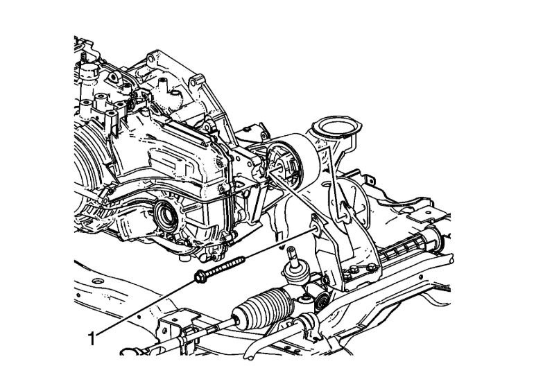

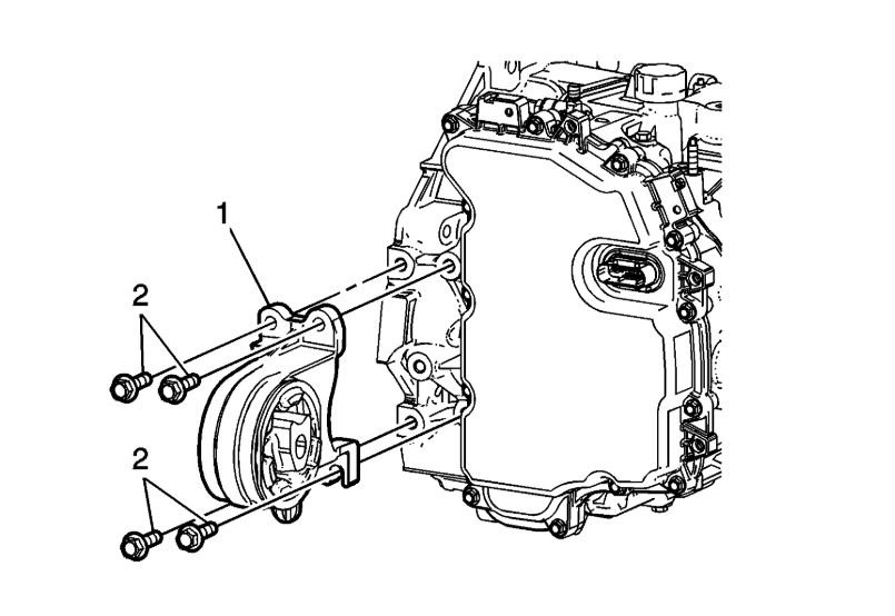

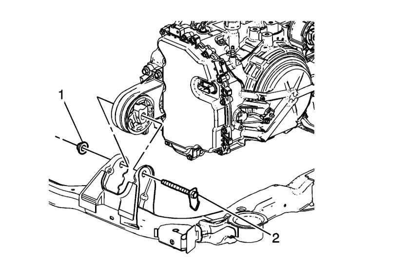

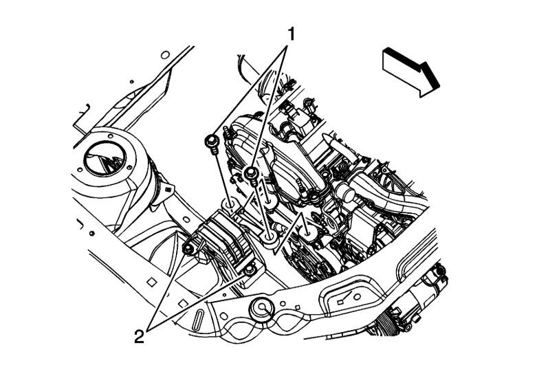

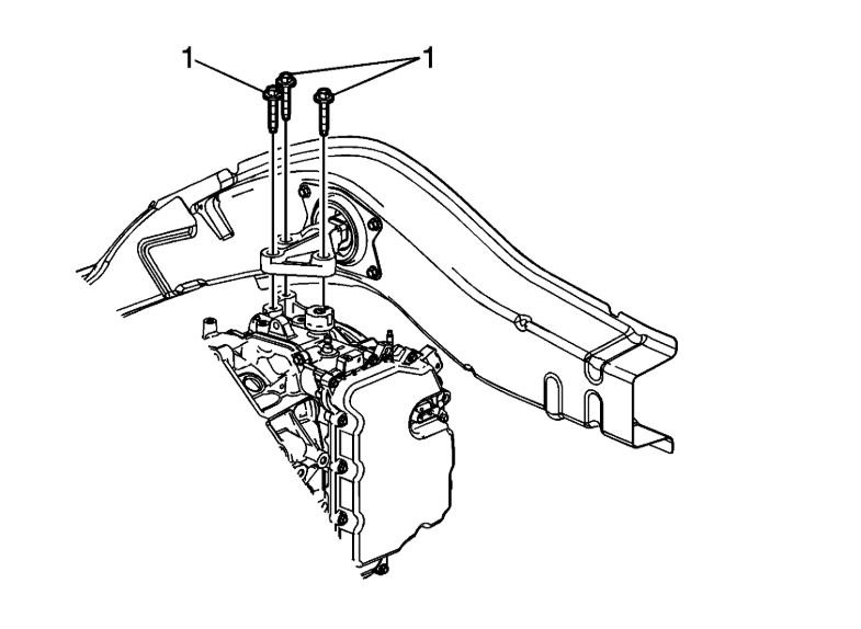

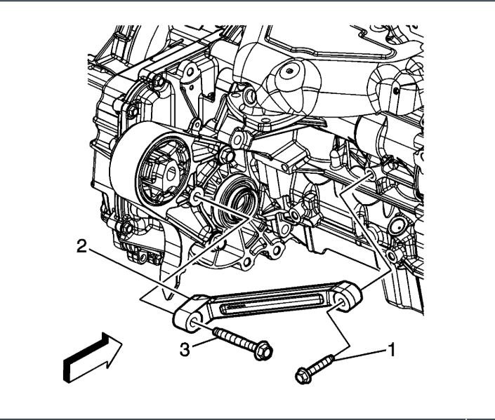

Good evening,
Just wanted to add to Alex response.
A lot of the times, those flex pipes fails from too much movement from the engine. Weak motor mounts will cause the pipe to flex way too much and it fails.
The reason for the pipe is movement of the engine. Since it sits sideways, it moves and if they did not have a flex pipe in the system, a pipe would actually fail.
Jan 30, 2020 at 11:12 AM
CHRISTINE542!
  • 5 POSTS
Thanks Roy. Last time, I did have the motor mount replaced with the flex pipe. This is why I was so surprised this happened again so quickly. It hasn’t even been 1.5 year this time.
Jan 31, 2020 at 1:53 AM
There are several motor mounts on the engine. You have 3 mounts on the transmission and 1 one the engine. Any one of them with too much play can cause this issue.
