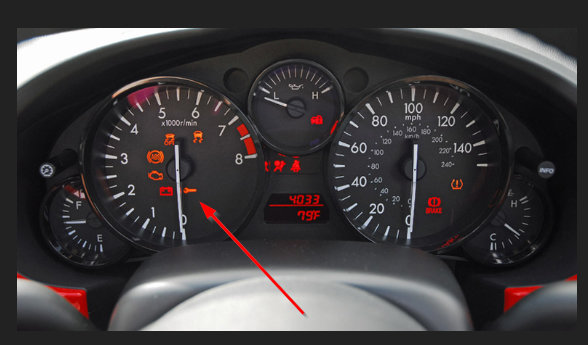

I am attaching a picture below of what I believe is what your cluster looks like.
If the arrow pointing to the key is what the light is that you are seeing, then yes that is normal.
Basically, that is telling you that the theft system is on.

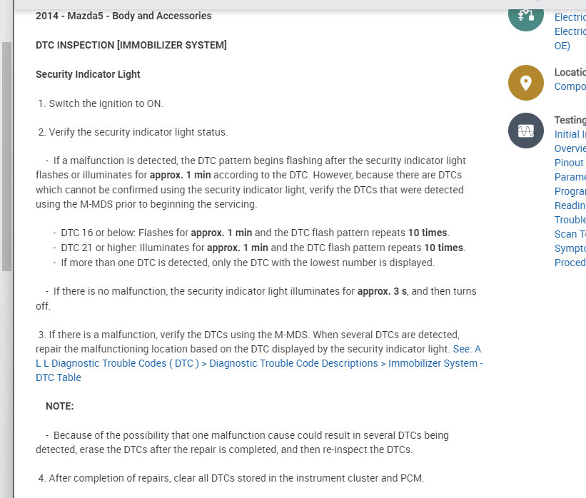

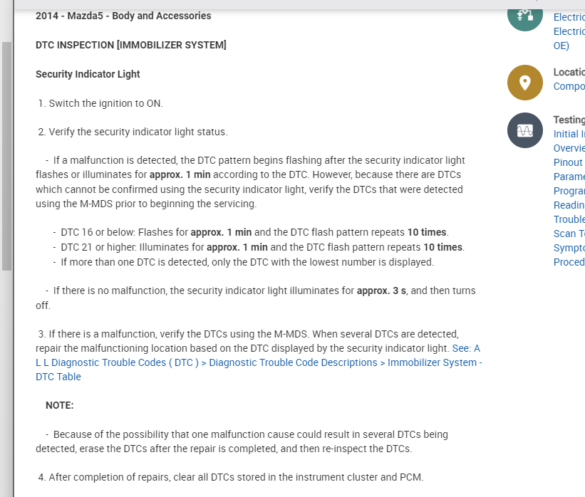

I am also attaching the info about if there is an issue with the system that will help with determining any DTCs.
You can also scan the vehicle for codes.
Lastly please see the info attached and let me know if you can get a picture of this. Thanks
