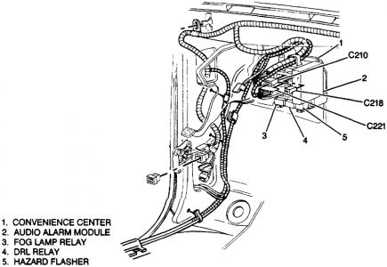

where is the turn signal flasher located?
May 17, 2020 at 4:02 AM (Merged)
  • 75,992 POSTS
Turn/Hazard Flasher-see location below: Convenience Center
https://images.2carpros.com/forum/automotive_pictures/12900_t_32.jpg
