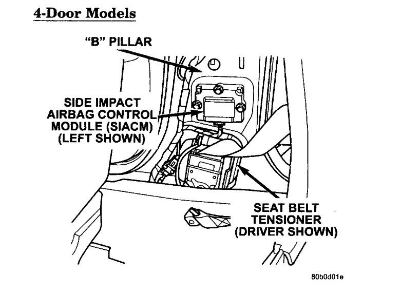

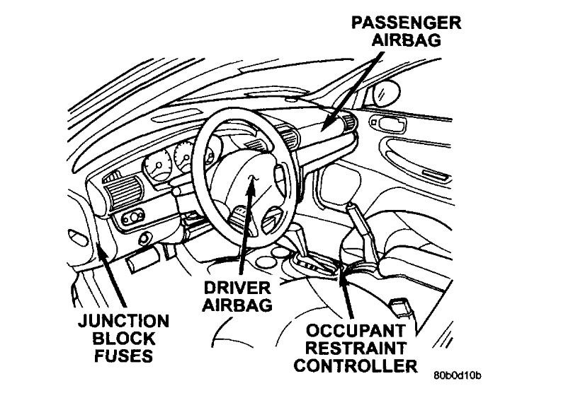

I am fixing a wrecked car. I need to know where the SRS module is so I can replace it, as well as whatever else I need to replace along with the airbags, in order for the airbags to work in case of another wreck.
Apr 21, 2019 at 9:32 AM
Good afternoon,
You will need to replace the module, seat belt pretensioners, and the crash sensors.
Then the dealer will have to program the module for you.
OCCUPANT RESTRAINT CONTROLLER
REMOVAL
1. Disconnect and isolate the battery negative remote cable. Wait two minutes for the capacitor to discharge.
2. For a manual transmission, remove shifter knob and boot.
3. For automatic transmission models, remove shifter knob and unsnap shift indicator bezel.
4. Remove the four attaching screws to floor console.
5. Remove parking brake lever. Refer to Brakes, Parking Brake, Parking Brake Lever, Removal.
6. Remove three mounting nuts to ORC.
7. Disconnect wire harness connectors and remove ORC from mounting studs.
INSTALLATION
CAUTION: Use supplied nuts only.
1. With the battery disconnected, position the ORC (arrow pointing forward) on center tunnel area mounting studs.
2. Connect wire harness connector.
3. Attach the three mounting nuts and tighten to 10 to 14 Nm (85 to 125 in. lbs.) torque.

AIRBAG SYSTEM/OCCUPANT RESTRAINT CONTROLLER SYSTEM
The 2002 Airbag System contain the following components: Occupant Restraint Controller (ORC), Airbag Warning Indicator, Clockspring, Driver and Passenger Dual Squib Airbags, Seat belt Tensioners, Left and Right Side Impact Airbag Control Module (SIACM), and Curtain (roof mounted) Air-bags.
The (ORC)is a new type of Airbag Control Module (ACM) that supports staged airbag deployment. Staged deployment is the ability to trigger airbag system squib inflators all at once or individually as needed to provide the appropriate restraint for the severity of the impact. The ACM has four major functions: PCI Bus communications, on-board diagnostics, impact sensing, and component deployment. The ACM also contains an energy-storage capacitor. This capacitor stores enough electrical energy to deploy the front airbag components for two seconds following a battery disconnect or failure during an impact. The ACM is secured to the floor panel transmission tunnel between the front seats inside the vehicle. The ACM cannot be repaired or adjusted and must be replaced.

SEAT BELT TENSIONER (SBT)
The JR41 4-door driver and front passenger seat belt (retractor) tensioners are mounted to the inboard side of the "B" pillar at the floor. The tensioner is an integral part of the seat belt retractor. At the onset of an impact event the ACM uses the seat belt tensioner to rapidly retracts the seat belt. With the slack removed, the occupant's forward motion in an impact will be reduced as will the likelihood of contacting interior components. The seat belt tensioner cannot be repaired, if damaged or defective it must be replaced. The ACM continuously monitors the resistance of the seat belt tensioner circuits an open or shorted conditions.
The JR27 convertible driver and front passenger seat belt (buckle) tensioners are mounted to the inboard side of the front seats. The seat belt buckle is connected directly to the seat belt tensioner cable. At the onset of an impact event the ACM uses the seat belt tensioner to rapidly retract the seat belt buckles. With the slack removed, the occupant's forward motion in an impact will be reduced as will the likelihood of contacting interior components. The seat belt tensioner cannot be repaired, if damaged or defective it must be replaced. The ACM continuously monitors the resistance of the seat belt tensioner circuits an open or shorted conditions.
SIDE IMPACT AIRBAG CONTROL MODULE (SIACM)
Supplemental driver and passenger curtain airbags provide side impact protection for the occupants. Each side airbag has it's own side impact airbag control module (SIACM)to provide independent impact sensing and deployment. SIACM are located on the left and right B post just above the seat belt retractor. One, same part number, SIACM is used on both side of the vehicle. However, for proper PCI bus operation each SIACM must have a unique module identification. To provide the unique module identification for both, left and right, the SIACM software looks for a ground on cavity #5 of the SIACM connector. If cavity #5 is grounded the SIACM communicates as a left SIACM otherwise it communicates as a right SIACM. The SIACM performs self diagnostics and circuit tests to determine if the system is functioning properly. If the test finds a problem the SIACM will set both active and stored diagnostic trouble codes. If a DTC is active the SIACM will request that the airbag warning lamp be turned on. The results of the system test are transmitted on the PCI Bus to the ACM once each second or on change in lamp state. If the warning lamp status message from the either SIACM contains a lamp on request, the ACM will set an active DTC. At the same time as the DTC is set, the ACM sends a PCI Bus message to the (MIC) requesting the airbag warning indicator be turned on. Observe all ACM warning and caution statements when servicing or handling the SIACM. SIACM are not repairable and must be replaced if they are dropped.
