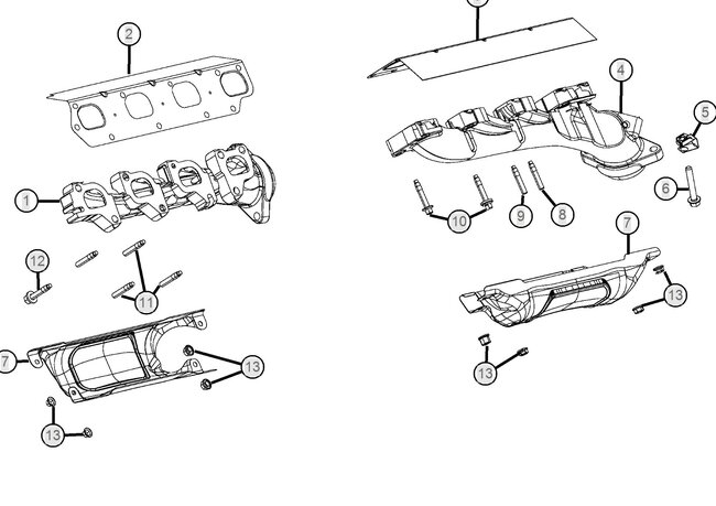

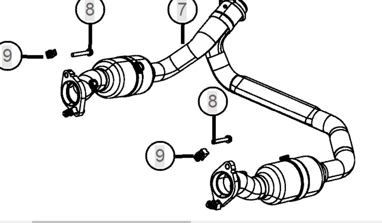

I would also make sure every bolt for the manifold and heat shield are on and where they should be. Also make sure the bolts that connect the rest of the exhaust to the flange on the manifold are not broken. I am sending a couple images from the Mopar Catalog showing all the bolts and where they should be.
