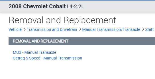

Have you checked the clutch fluid? If it is low, it can cause issues. Also, when you are stopped, can you easily shift from neutral to first gear?
Let me know as much as you can think of. Also, there are two different transmissions used. By chance, do you know which of the two you have? See pic below.
See pic below.

I do not know for sure. I know it has five gears and when I shift the shifter into first gear. It feels like something is blocking it from going into gear. I just have to move back into neutral and try again usually takes more than 2-3 times. I did add more tranny fluid into it. I know it's less than two quarts and it's not the synchromesh transmission fluid since it's not the SS model. It's the Ecotec 2.2-liter LS 2008 Coupe
