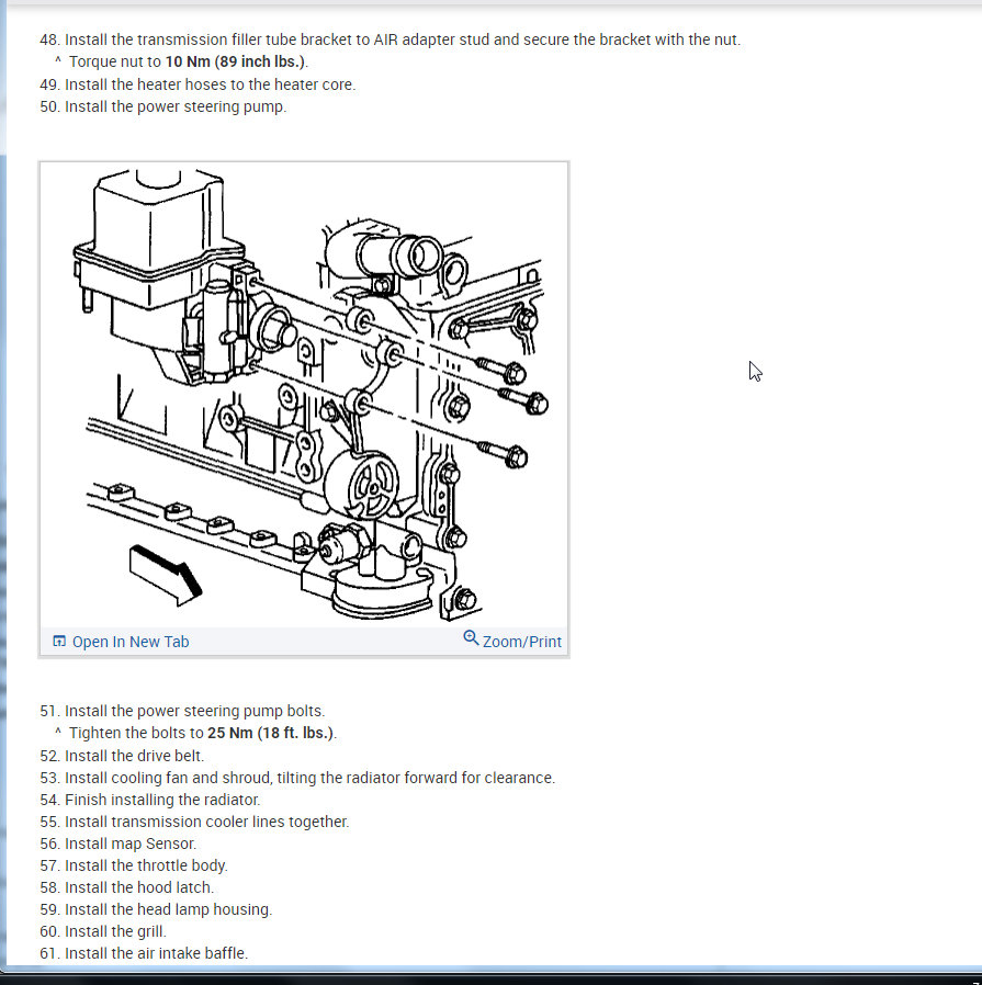

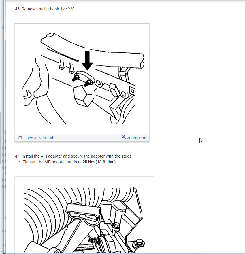

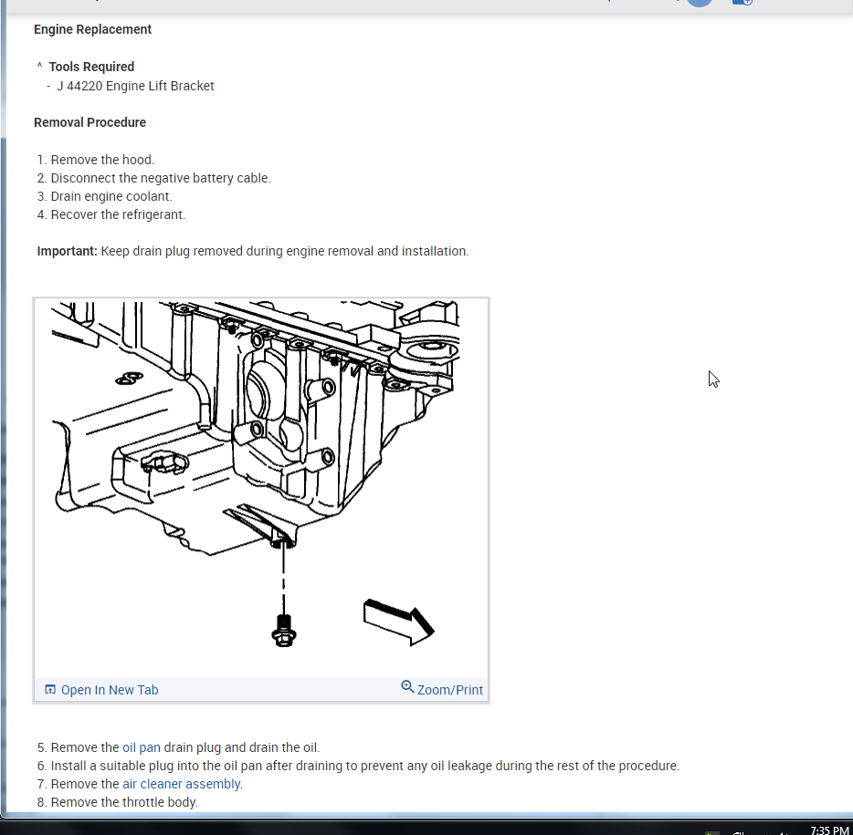

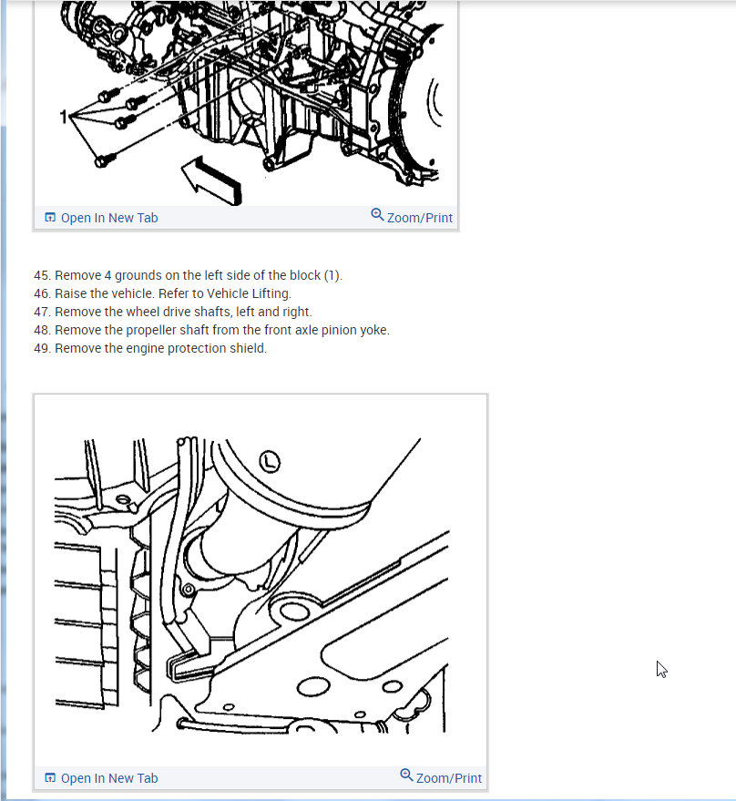

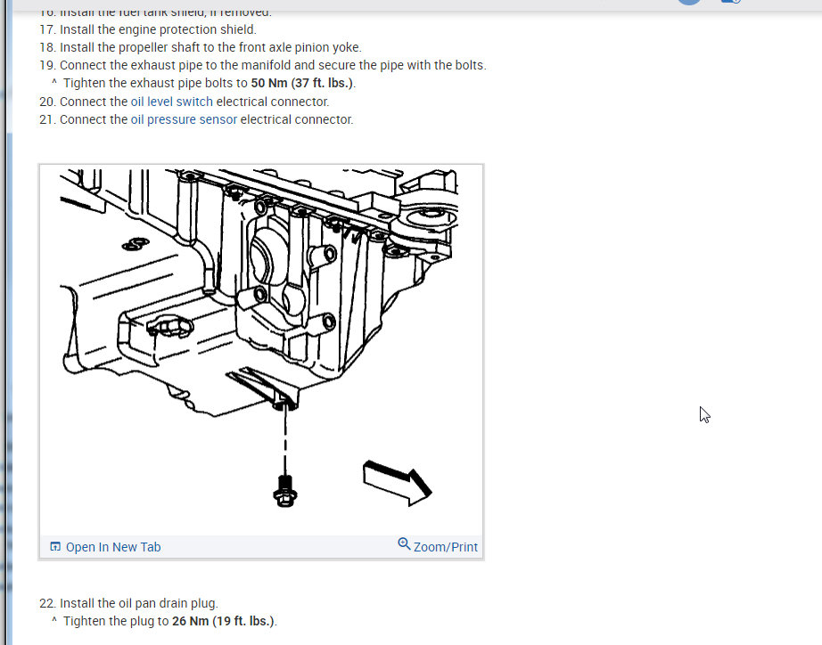

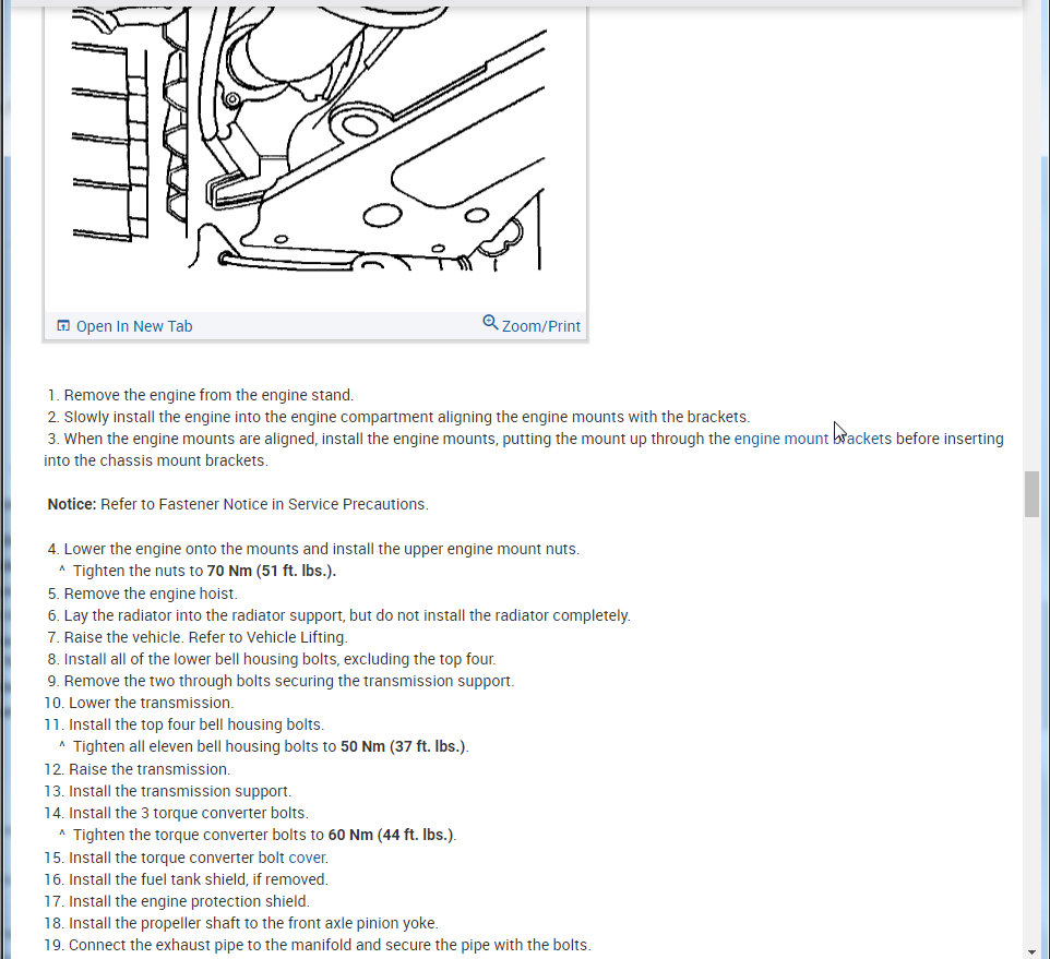

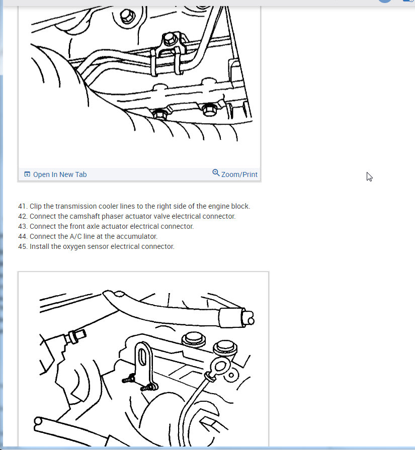

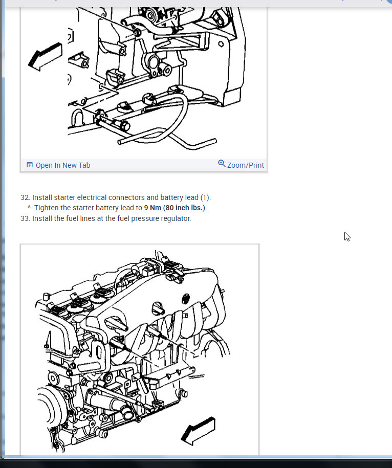

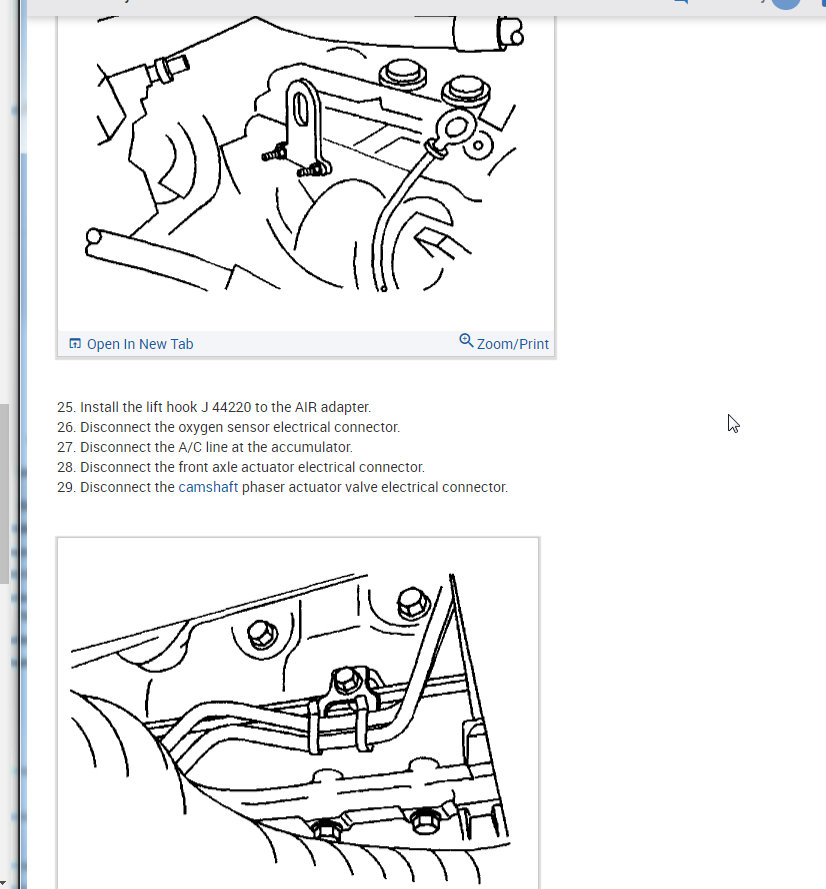

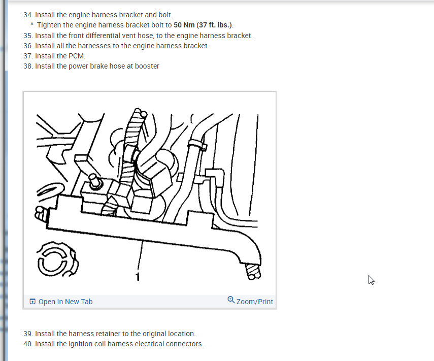

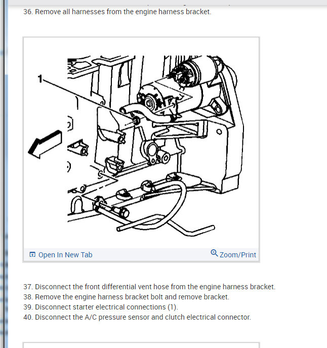

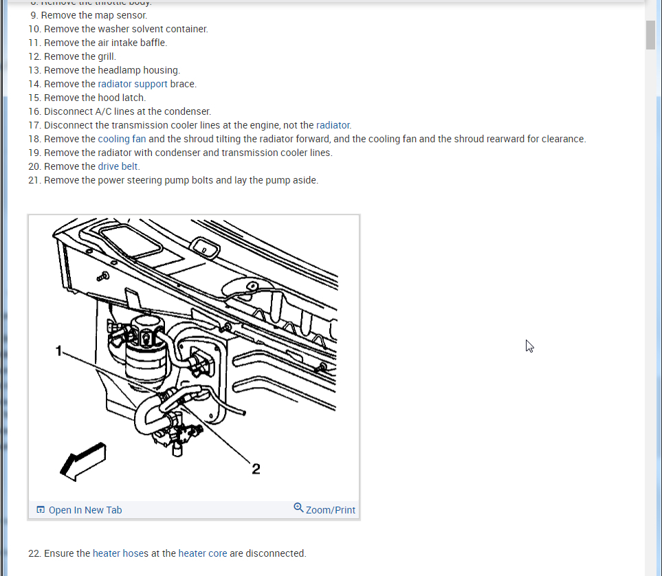

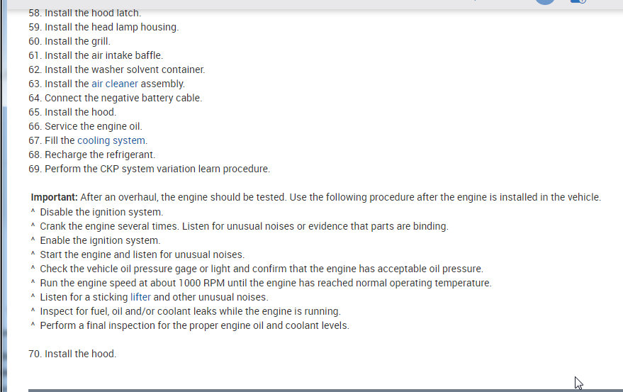

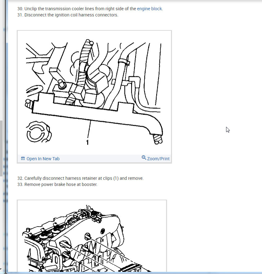

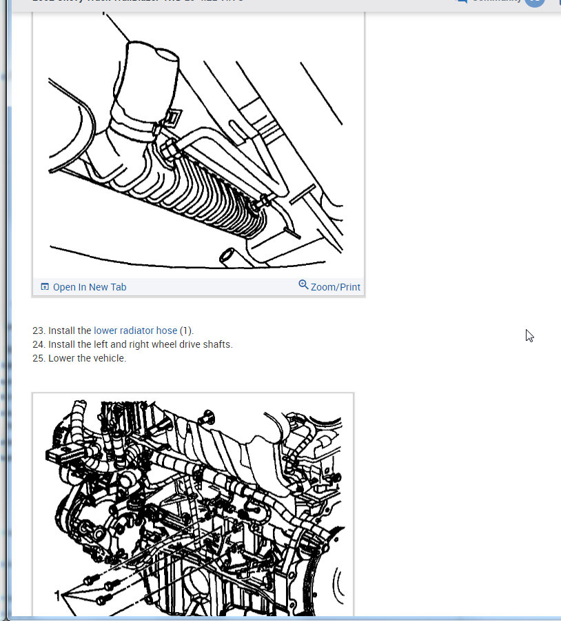

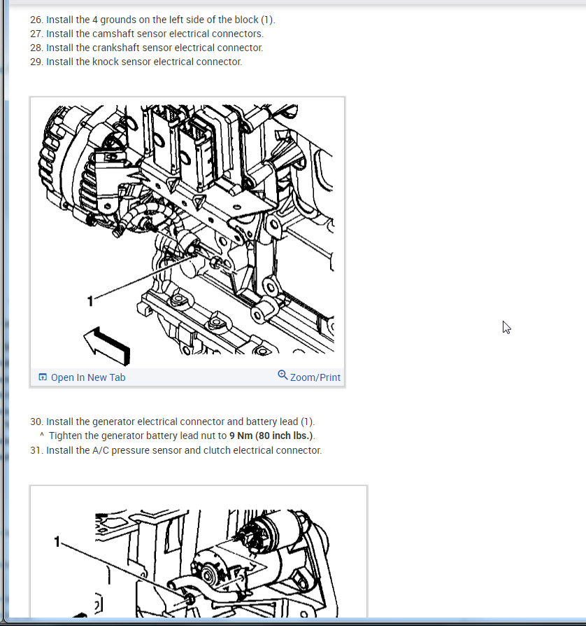

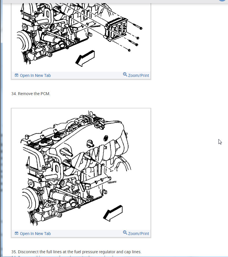

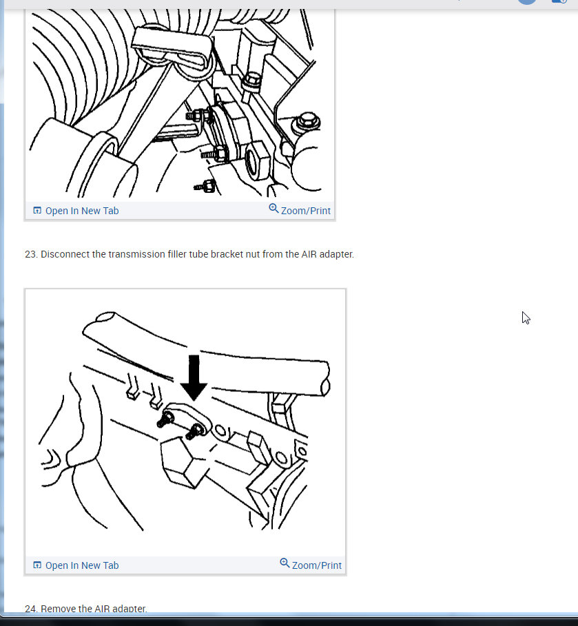

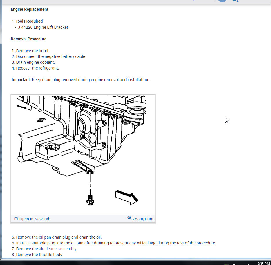

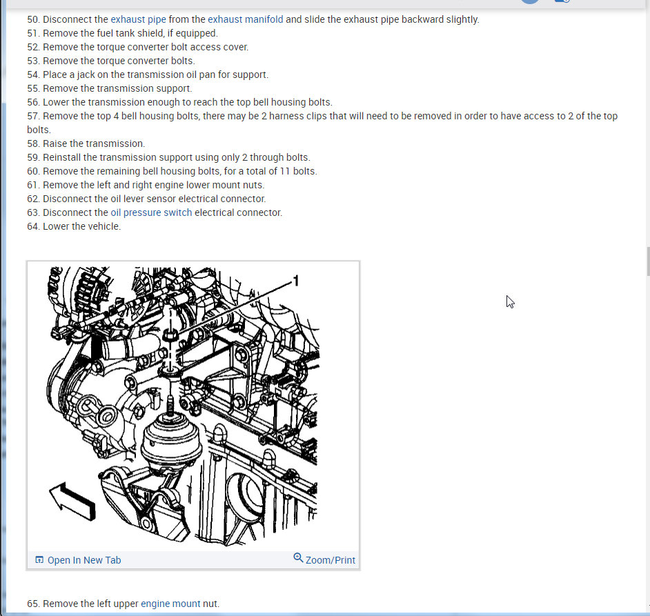

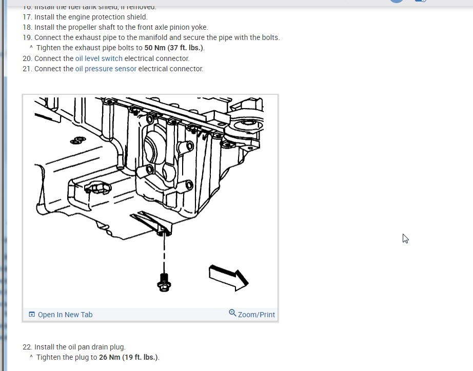

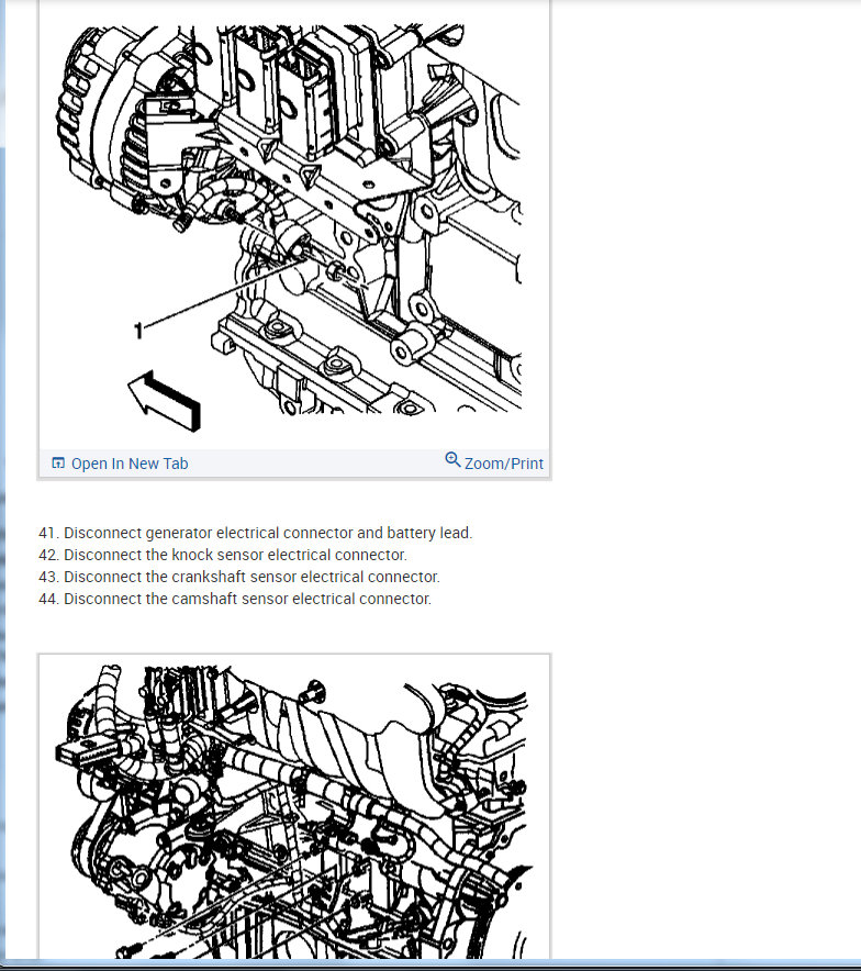

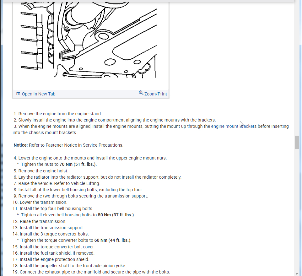

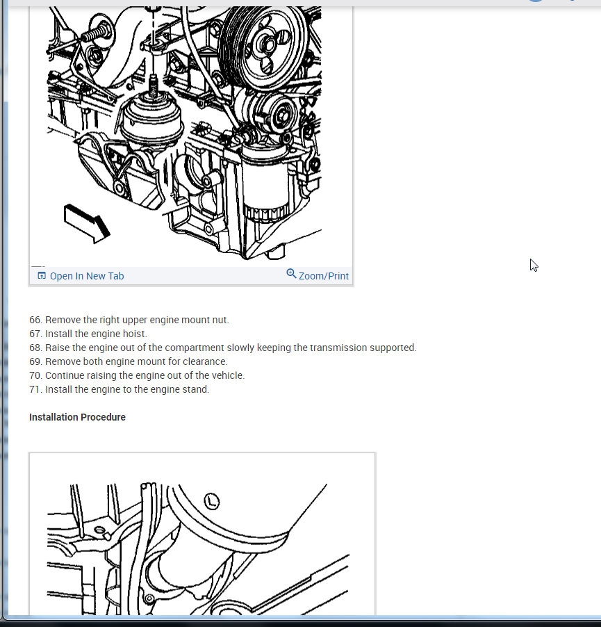

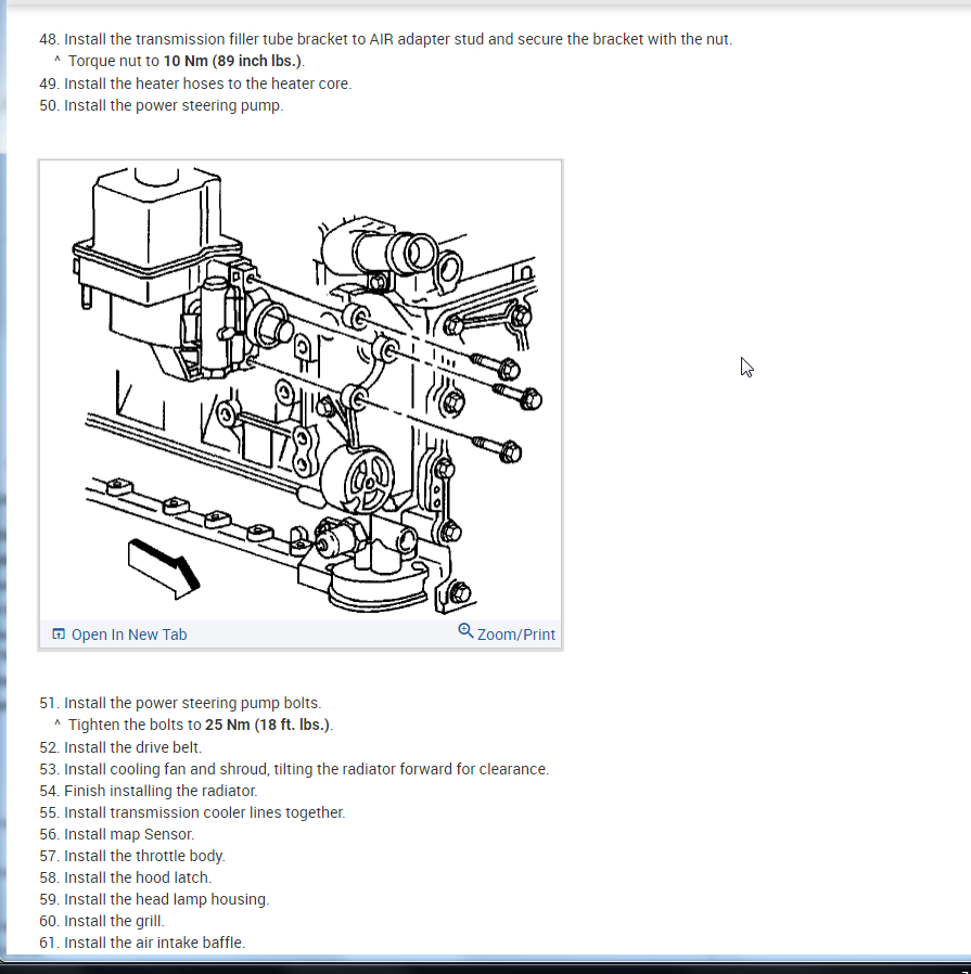

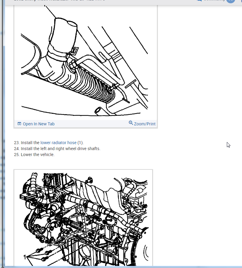

Can you get a recording of this noise? More then likely the engine need to be replace/rebuilt as stated but hearing the noise will help confirm this not to mention help others hear the noise if they have a similar noise.
I attached the info below on how to replace the engine in case you or others need that as well.
Thanks
