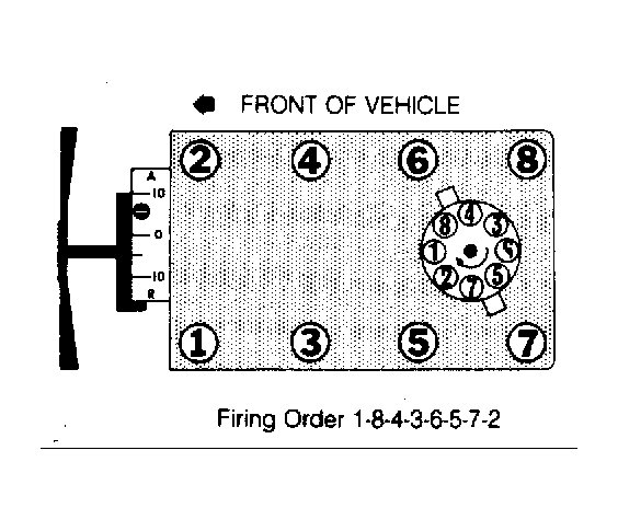

Was looking for spark plug firing order.
Dec 11, 2018 at 12:06 PM
HARRY P
  • 2,292 POSTS
Here is the firing order diagram from Prodemand of a 1983 Chrysler 318 (5.2L) engine. Hope it helps. Please feel free to ask more questions if needed. We are here to help. Check out the diagrams (Below). Let us know what happens and please upload pictures or videos of the problem.
