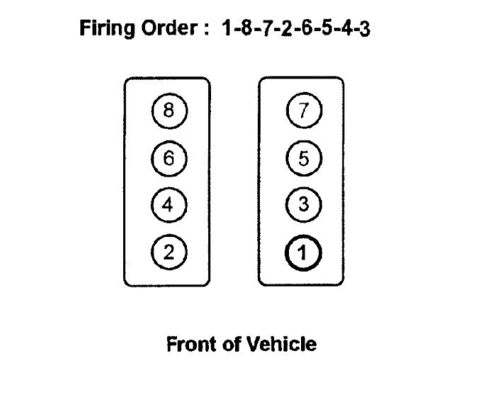

I have a 5.3 v8 with coil packs that says i get a misfire on cylinder 4.

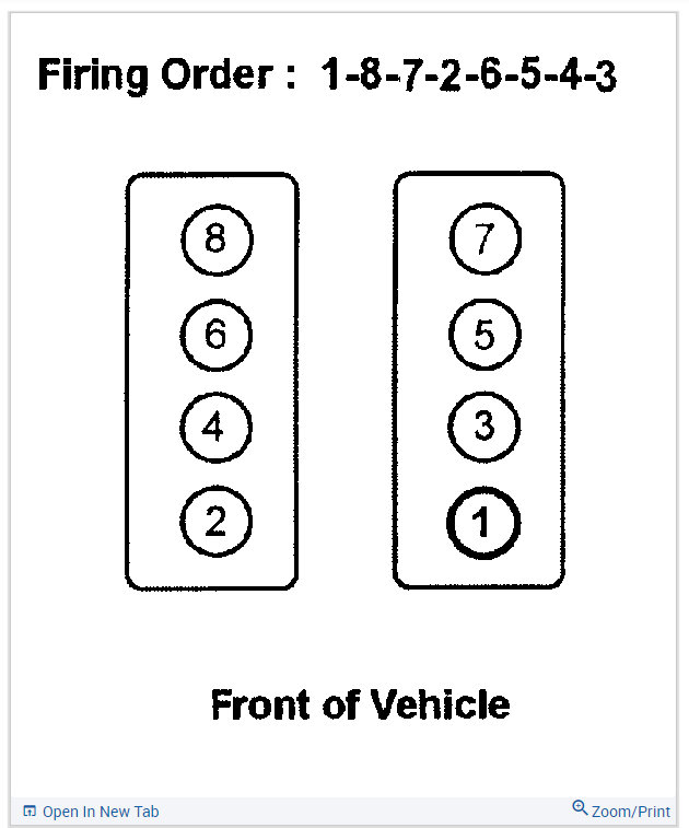

I attached the firing order for you below.
Let me know if you have any other questions.
Nov 12, 2020 at 1:51 AM
Attached is the firing order. However, if you have a misfire on cylinder 4 only, have you swapped plugs, injectors, and performed a compression check? If you swap them with another cylinder it should move if it is the plug or injector. Clearly do one at a time so you know which it is.
Then we need to check compression and make sure that is okay.
Let me know what you find or if you have other questions. Thanks
