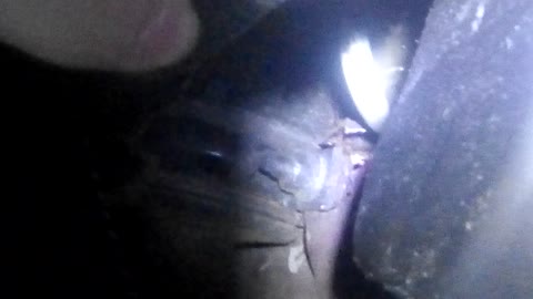

I went to have car aligned and was told my tie end rods were very loose because the bolts that the rack the rods are attached to have oval out (round bolts and oval bolt hole). No way for him to tighten them. I took it to someone else and they found a hole in the firewall on drivers side and the bolt moves back and forth when you turn the steering wheel. The other person said he could weld a metal plate over the firewall. My question is, can the tie end rods be replaced? The mechanic said it would cost $1,000.00 to take every thing out. Thank you for your time.

Both of them said about 1000. The first guy mentioned that where the tie rods connect together on the rack, the bolt hole was oval shaped because of the bolt being loose and the rack moving to side to side and I did ask him if I could just replace the tie rods and he said no because it's part of the car and I can't tighten it. The second guy looked under the hood and said the steering gear or box was loose from the firewall. First guy had it on a lift so he did not mention firewall. I am confused myself. I did see what the second guy was talking about, when I turn right I hear creak from steering wheel, left makes no sound. Do I have to repair both problems and should I go to body shop or muffler shop? I will try to send pic of firewall.

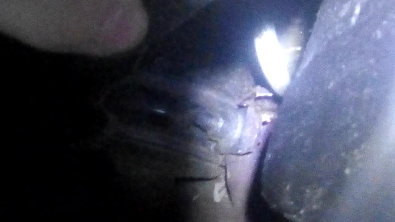

Hello, I was able to take a video of the hole on the firewall. You can see the bolt moving back and forth. The clicks are coming from the steering wheel also. I don't know if this is where the steering wheel is where the steering column is located. The second guy mentioned gear box. I am going Monday to another mechanic and let him check the tie rods. The first guy I think was talking about rack and pinion but I will know something Monday. Thank you

That is very dangerous. That could completely break at any time. Get this fixed as soon as you can.
I would not even drive it.

If that breaks away from the firewall you will lose all steering.
They will need to add metal for the mounting.

  • 52,797 POSTS
Rust. It cracked the metal and it broke under the stress of the steering.
