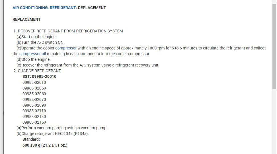

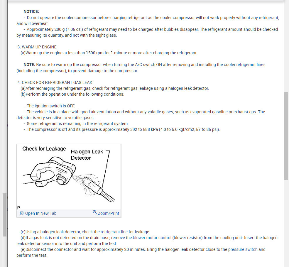

I have replaced the compressor and vacuumed the system. Holds vacuum. I have heard Toyota charges the A/C through the high side?? Is that right?
Sep 27, 2021 at 2:04 AM
I have never heard that so I am not seeing any info that says it is any different than any other vehicle that you install it on the low side.
Here is the info from the manual that shows how to do this. It doesn't tell you high or low which means it is on the low side.
Sep 27, 2021 at 4:32 AM
