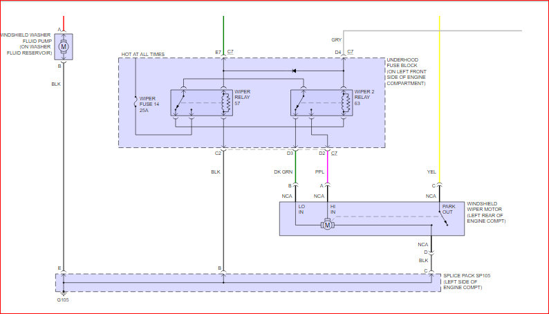

Wipers will not work at all. I replaced on-off and hi-low relays but did not help. It has power to motor and resistance on two wires in intermittent setting. I believe it is the motor, but would like to know the color codes of the four wires going to the motor to verify. Can you help? Thanks

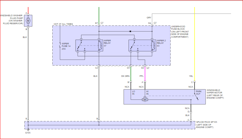

I have attached a picture of the wiper motor diagram. Hope this helps and thanks for using 2CarPros.
