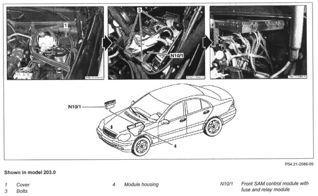

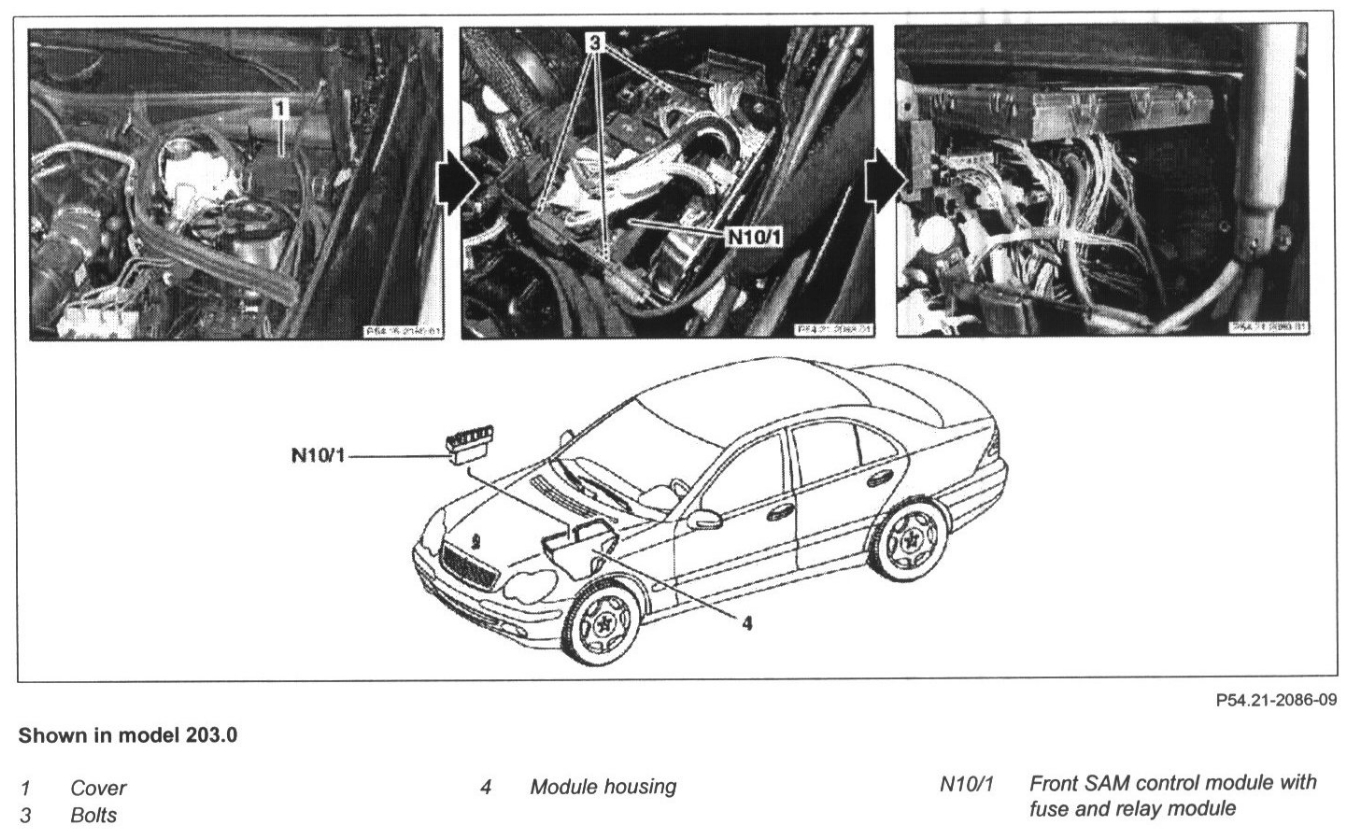

my car has gear shift level disappeared from IC , the ac condition unavailable on can bus means not running , parktronic does not working no volts for bumpers but it is working with no fault and flashing when ignition on only reverse lights does not go on when r gear in but from SAM test it is light on audio 20 fault can communication with N73 both SAMs f and rear fault is also can N73 fault can communication.

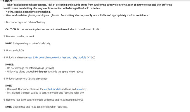

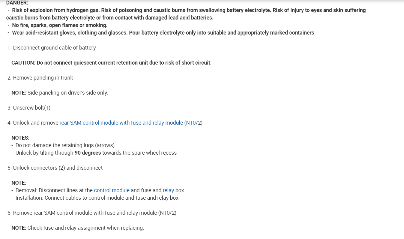

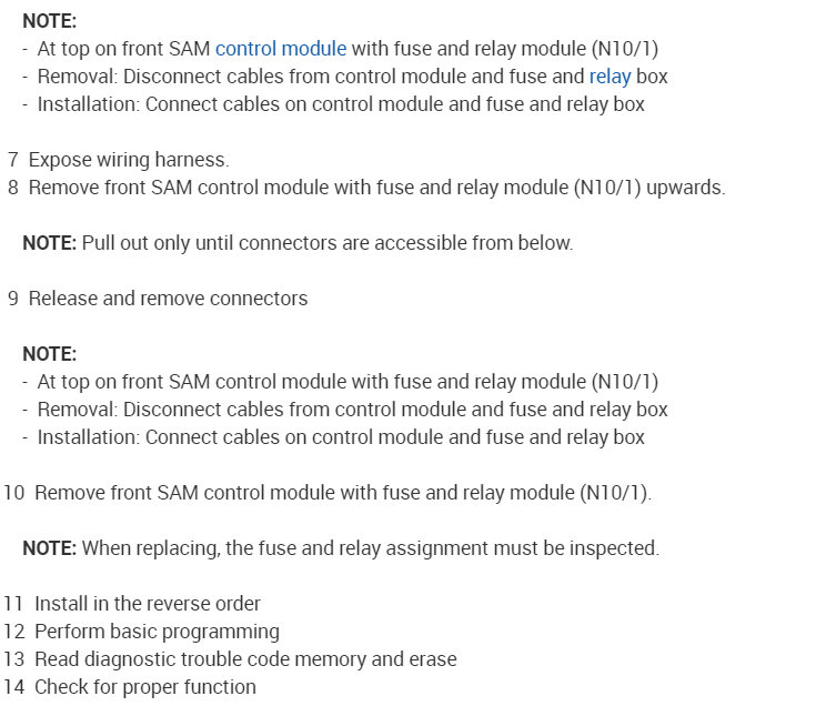

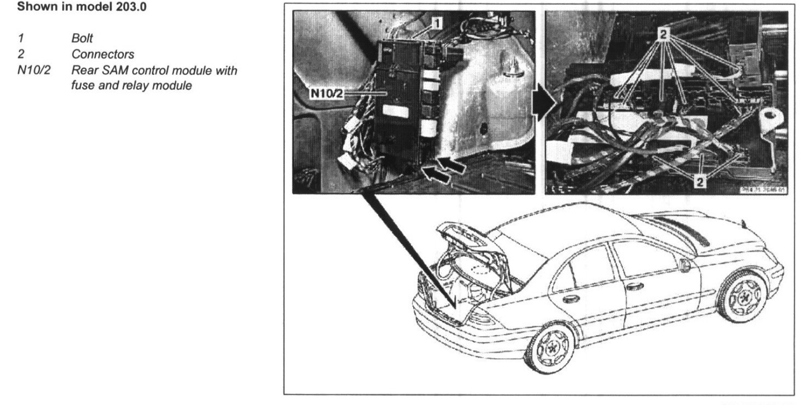

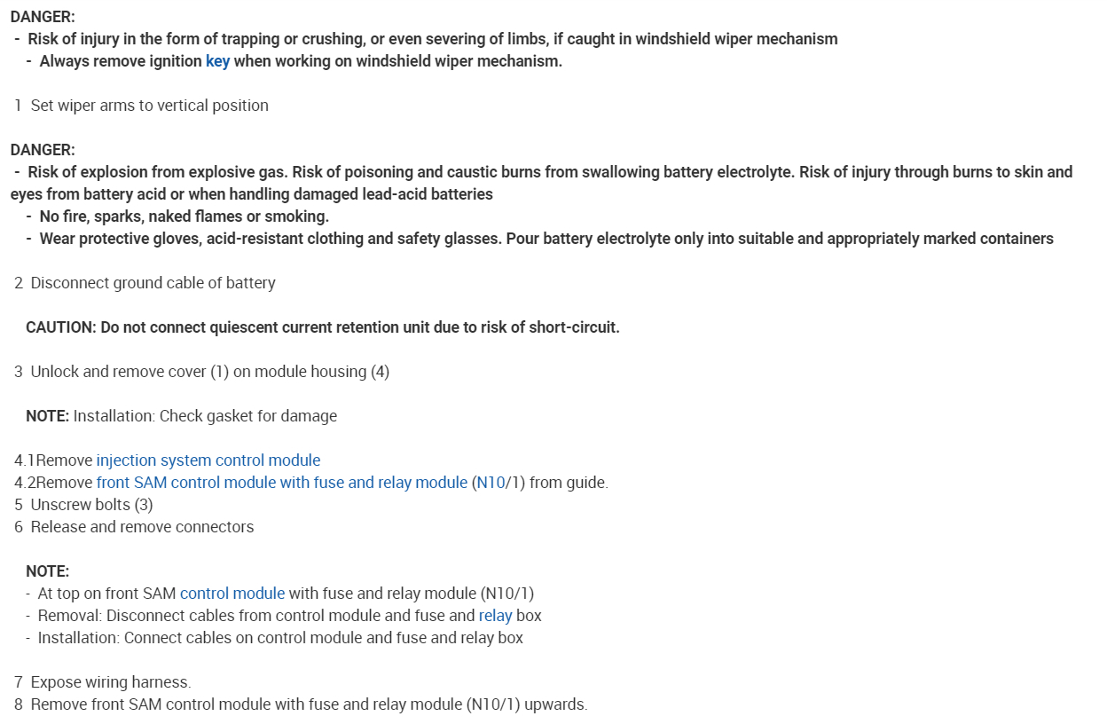

It is common for the SAM modules to go out if all fuses are good, I would try swapping the SAM module out. Here is how in the images below.

Thanks a lot fixed change ECU and ezs and els and now everything back to work.
