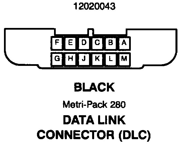

Want to see fault codes.
Sep 3, 2017 at 2:44 AM
WRENCHTECH
  • CERTIFIED EXPERT
  • 20,761 POSTS
If you jump terminals A and B of the diagnostic connector and turn the key on, the check engine light will flash code numbers.
