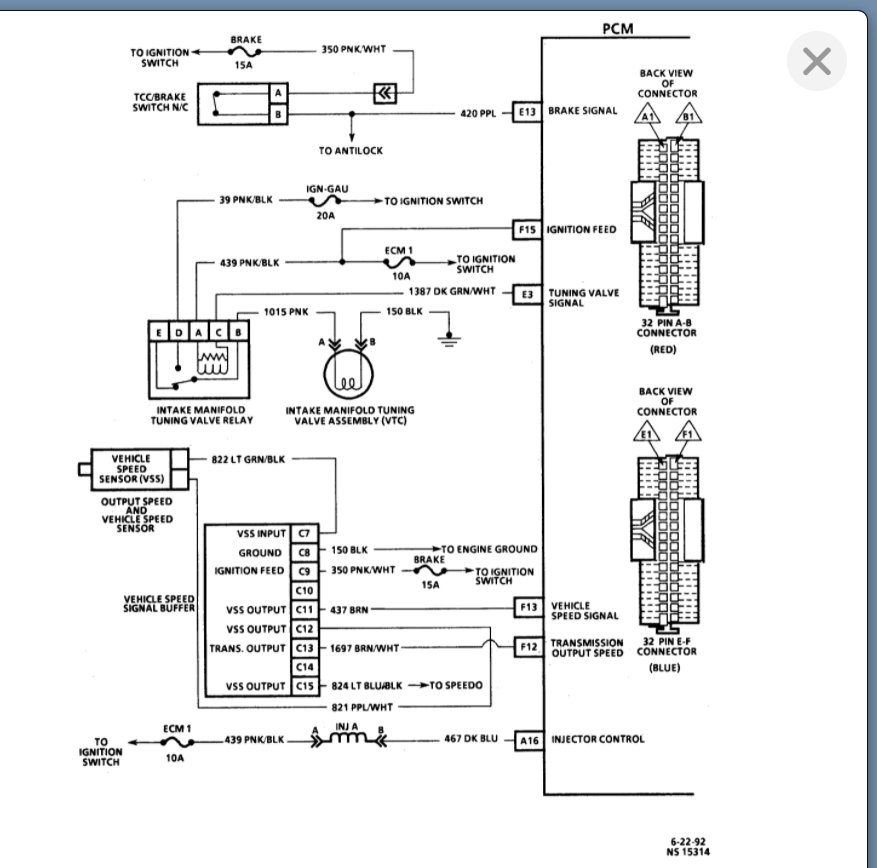

Even though the manifold pressure sensor and the intake air temperature sensor have both been replaced it is still throwing these two fault codes. Any ideas what could be wrong?

First, the 12 code is the system is normal.
So that means we need to focus on the 23 which is the intake air temperature low code.
This means the voltage at the control module is too low which normally means there is a short to ground. So, if you replaced the sensor then that takes us to wiring or the control module.
https://www.2carpros.com/articles/buick-cadillac-chevy-gmc-oldsmobile-pontiac-gm-1983-1995-obd1-code-definitions-and-retrieval-method
I highly suspect we have a ground issue, so we need to check resistance to ground with the module and sensor unplugged. This should be an open circuit.
If not, then you have a wiring issue.
If it is an open circuit then we need to suspect the module.
