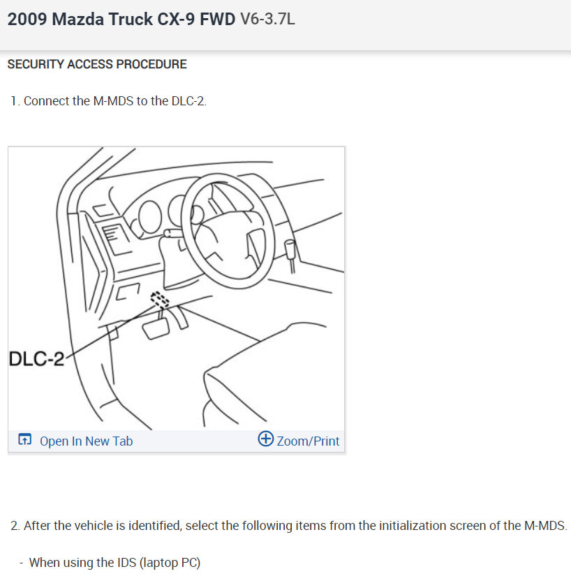

The Ignition key was on the ignition cylinder and battery head was disconnected, when the battery head was reconnected and ignition turn on, the key light remains on, and the key indicator begin to flash rapidly without turning off. the vehicle will not crank at this time. I tried to use stool 100pro to reprogram it and it was not communicating could it be the key ring or instrument cluster is the problem?

Trouble code P1260 for a 2009 Mazda CX-9 generally refers to an issue related to the vehicle's theft-deterrent system. So, it sounds like you are using the wrong key, do you have a spare? Also, I would check all fuses with the system on, here is how to reset the security system to help clear the system out and reset it.
https://www.2carpros.com/articles/how-to-reset-a-security-system
This may help as well:
2. After the vehicle is identified, select the following items from the initialization screen of the M-MDS.
- When using the IDS (laptop PC)
- Select "Body"
- Select "Security"
- When using the PDS (Pocket PC)
- Select "Programming".
3. Then, select items from the screen menu in the following order.
- Select "PATS Function"
4. Select the items to be performed from the following:
- Program Additional card key
- Card Key Code Erase and Program
- Steering Lock Unit Programming
- Program additional ignition key
- Ignition Key Code Erase and Program
- Customer Spare Key Programming Enable
- Customer Spare Key Programming Disable
- Parameter Reset
5. The security access begins and the M-MDS displays the "OUT-CODE".
NOTE:
- When "OUT-CODE" is first displayed, turning the ignition switch from the LOCK to the ON position 5 times will change the "OUT-CODE".
6. Input "IN-CODE" corresponding to "OUT-CODE" displayed on the M-MDS screen.
7. If the security access is successful, selected item can be performed.
