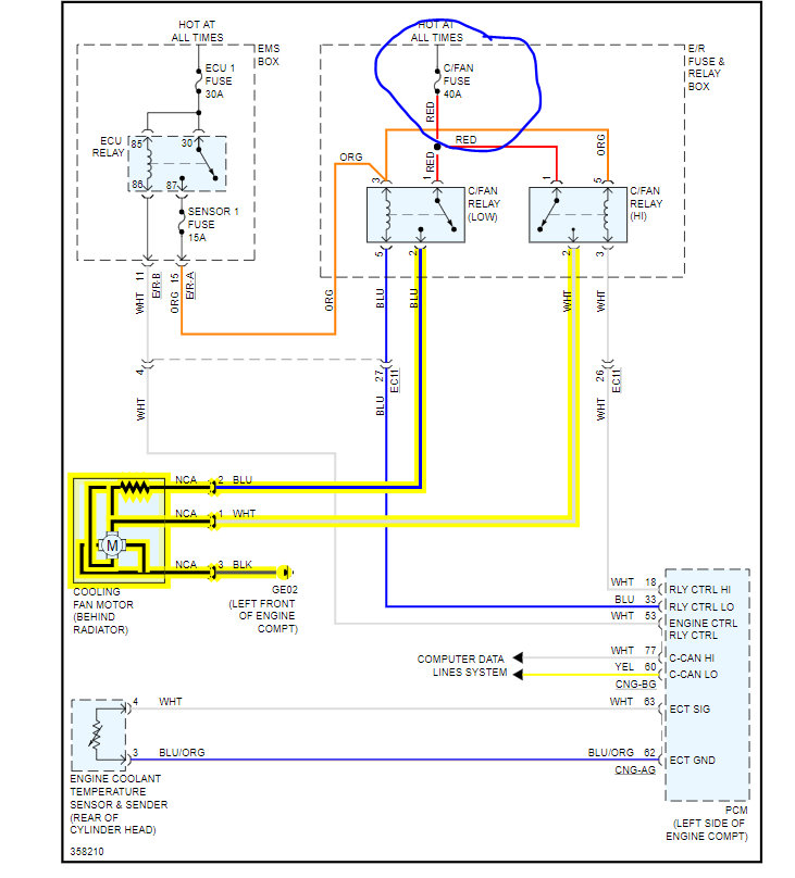

My car is running about halfway on the temperature and I realized that there was a little bit of smoke coming from the grille which made me realize that the fan isn't engaging. Also the hose was is rock hard. so would this be a problem with the thermostat or my fan?

If the engine is running at normal temperature, I doubt the thermostat is the issue.
https://www.2carpros.com/articles/engine-overheating-or-running-hot
https://www.2carpros.com/articles/how-an-engine-thermostat-works
As far as the smoke, it could be from a coolant leak. I would pressure test the engine and make sure there is no leak.
https://www.2carpros.com/articles/radiator-pressure-test
https://www.2carpros.com/articles/car-is-leaking-coolant
As far as the fan, if you turn on the A/C, does the fan run?
https://www.2carpros.com/articles/how-an-electric-cooling-fan-works
https://www.2carpros.com/articles/replace-electric-fan-motor
I attached a wiring diagram of the cooling fan. If it does not work we will need to do some checks to find out why it is not working.
