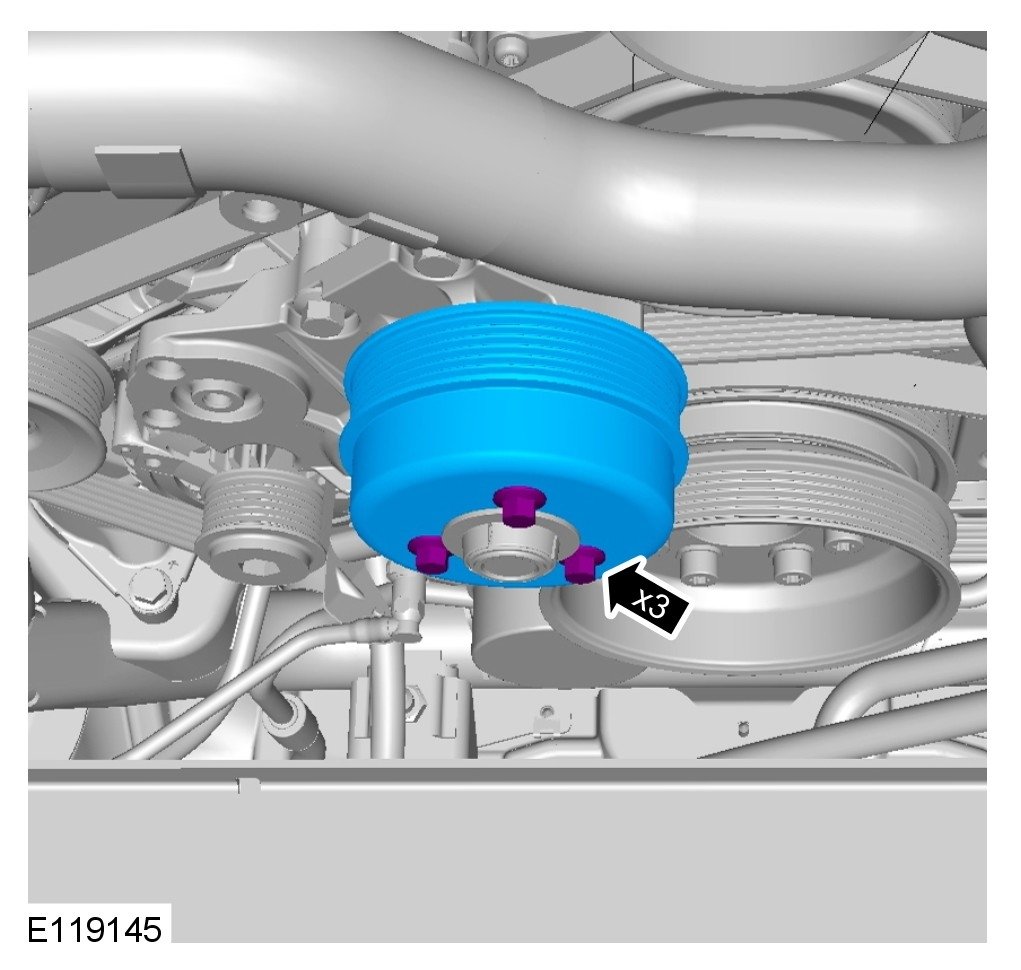

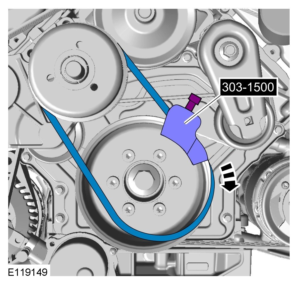

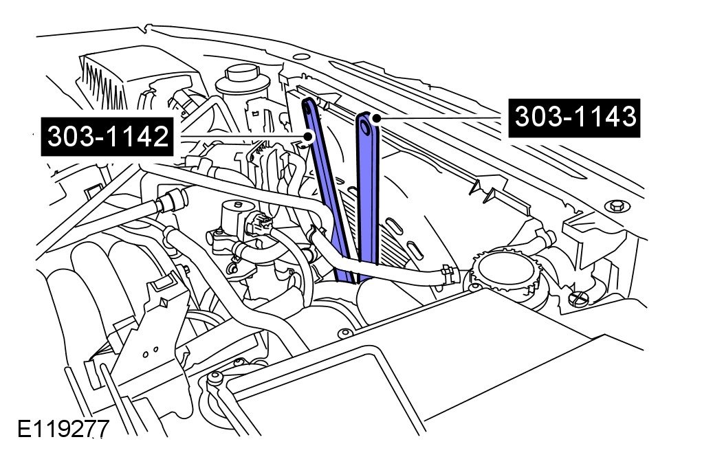

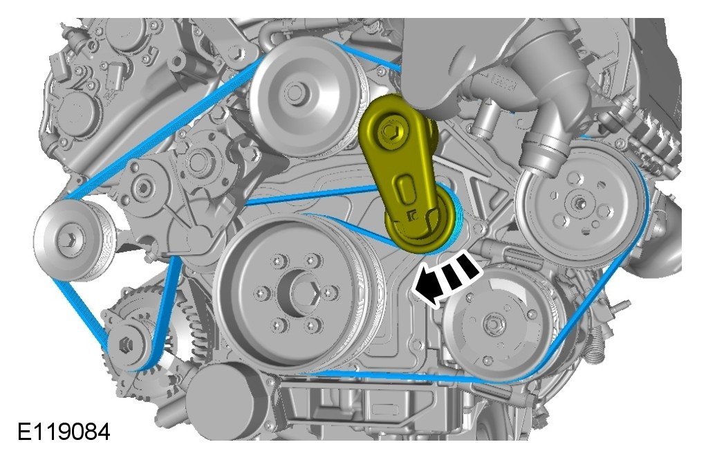

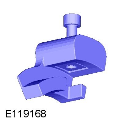

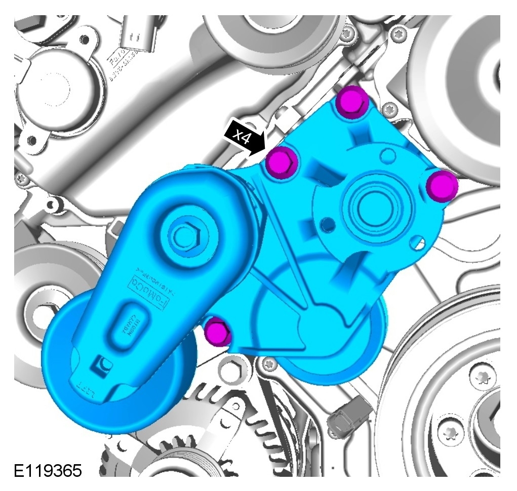

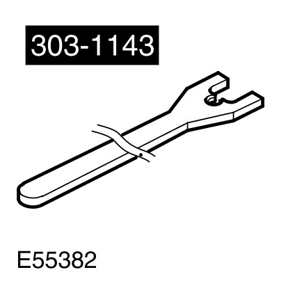

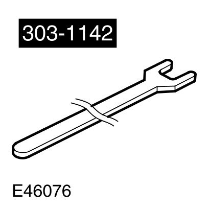

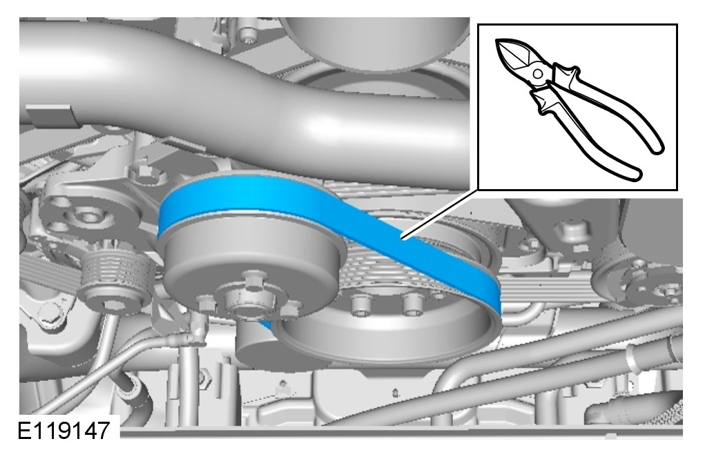

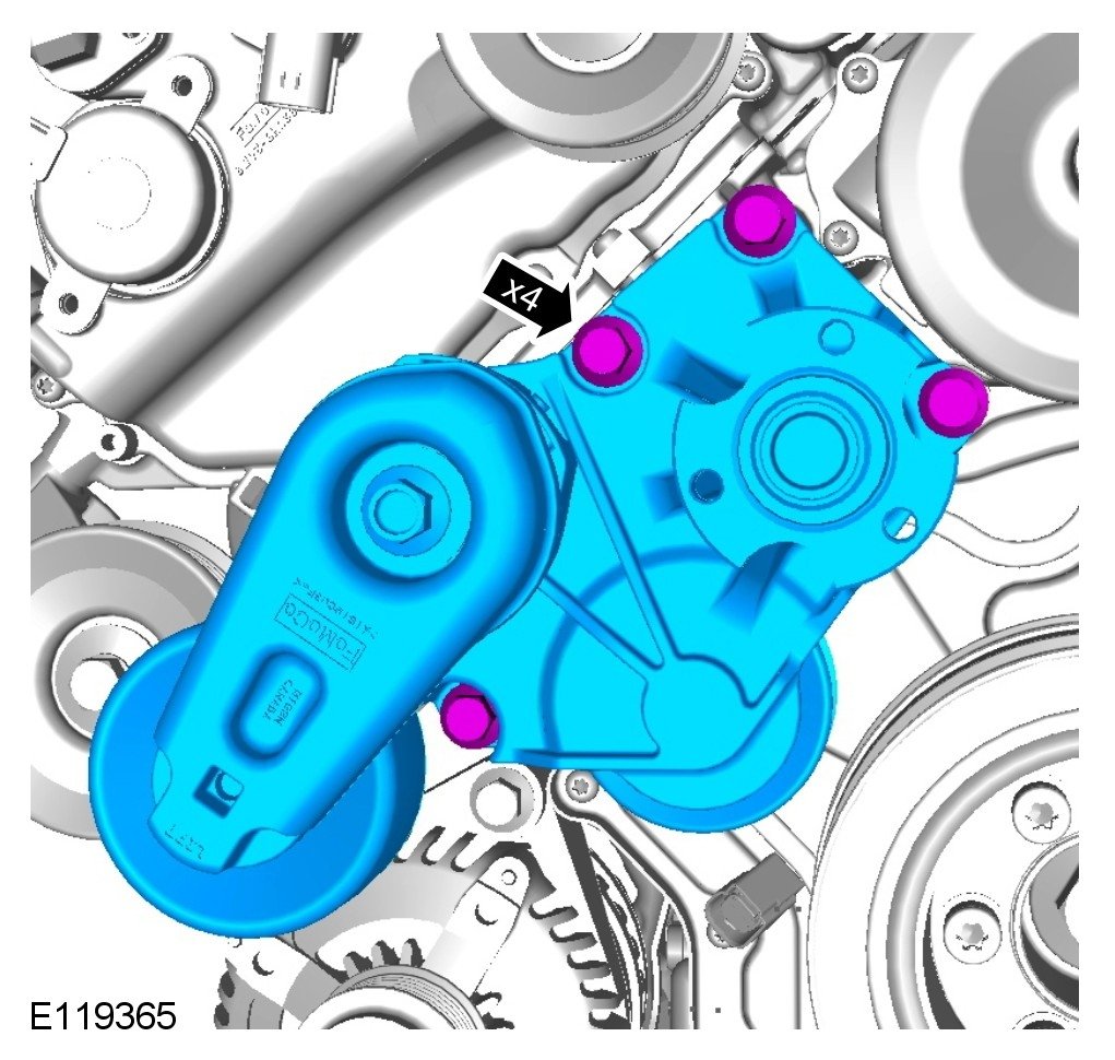

I am trying to open fan clutch for changing car belt; i tried a lot but it's not opening. need help. I already watched video a lot by the way.
Apr 20, 2020 at 9:23 PM
  • 110,194 POSTS
Here are the directions for the accessory drive belt replacement. Let me know if this helps. The attached pics correlate with the directions. The attached pics correlate with the directions.

2 Raise and support the vehicle.
For additional information, refer to Supercharger Belt See: Drive Belt > Removal and Replacement > Supercharger Belt
pic 1
CAUTION: Always protect the cooling pack elements to prevent accidental damage.
NOTE:
The thread is right handed.
NOTE:
Some variation in the illustrations may occur, but the essential information is always correct.
Special Service Tool
pic 2
Viscous Coupling Wrench, 303-1142
pic 3
Viscous Coupling Holding Tool, 303-1143
pic 4
pic 5
NOTE:
Note the fitted position.
pic 6

Install the cooling fan belt.
pic 19
Installer, Stretchy Belt, 303-1500
Whilst rotating the engine, make sure that pressure is applied to the left hand side of the cooling fan belt to aid installation.
Rotate the engine until the special tool has reached the 9 o clock position.
1 Remove the special tool.
2 Rotate the engine clockwise twice, making sure that the belt is seated on both pulleys correctly.
