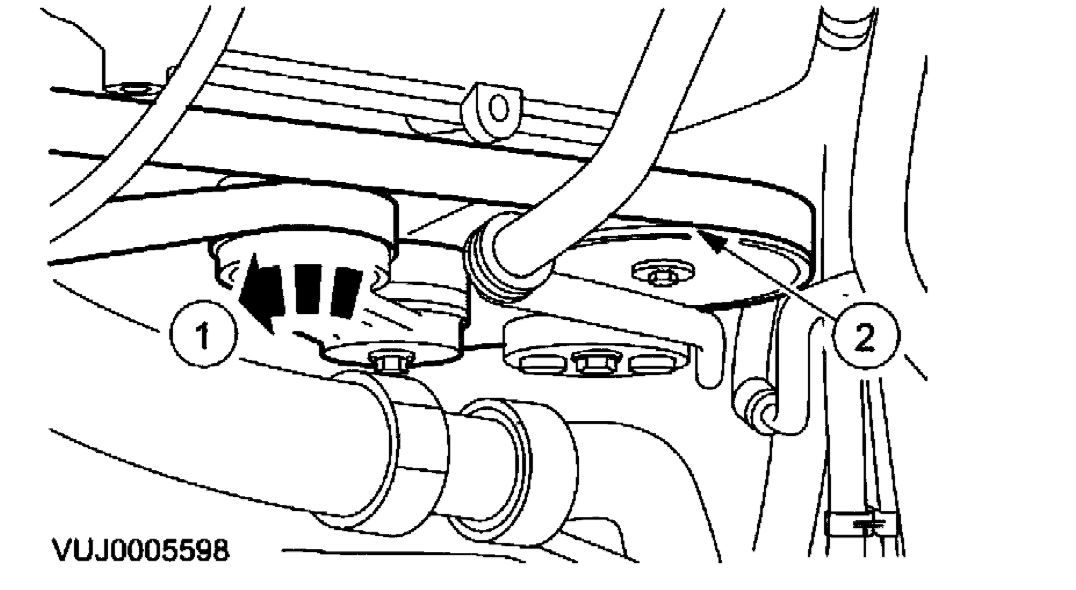

Good evening. How do I replace the fan belt? Can you tell me step by step how to do so? Be sure to send images if you can please. Just wondering, do I have to remove the water pump in order to replace the fan belt? Thank you for speedy response.

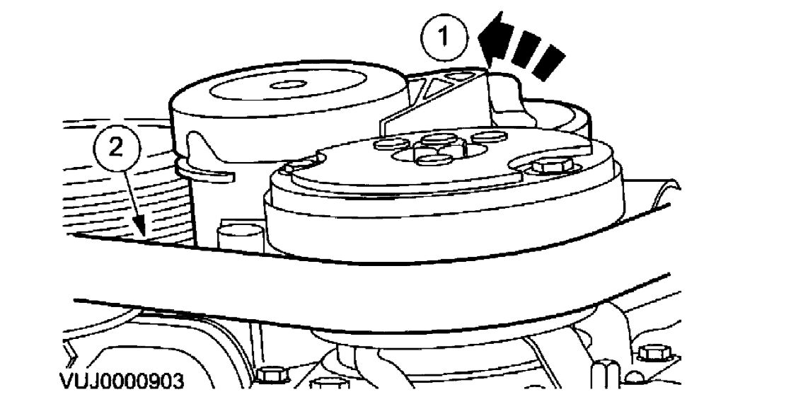

Accessory Drive Belt 2.5L/3.0L
Removal
1. Disconnect the battery ground cable.
2. Remove the air deflector.
3. Remove the accessory drive belt.
1. Rotate the accessory drive belt tensioner counter-clockwise.
^ Use a 3/8 inch square drive bar to rotate the accessory drive belt tensioner.
2. Remove the accessory drive belt.
Installation
1. To install, reverse the removal procedure.
