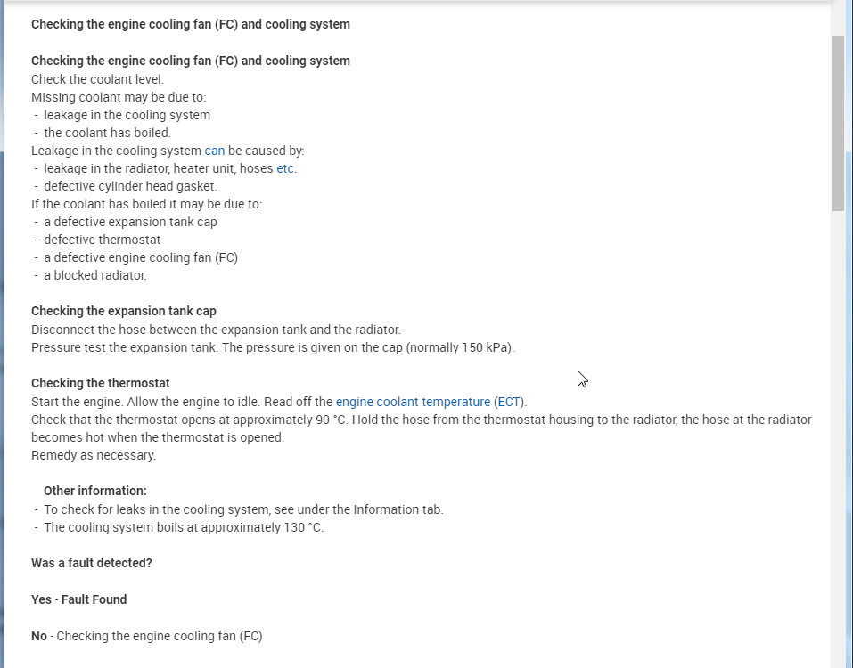

Main fan will not turn off
2004 VOLVO XC70
185,000 MILES
JONATHAN JENSEN

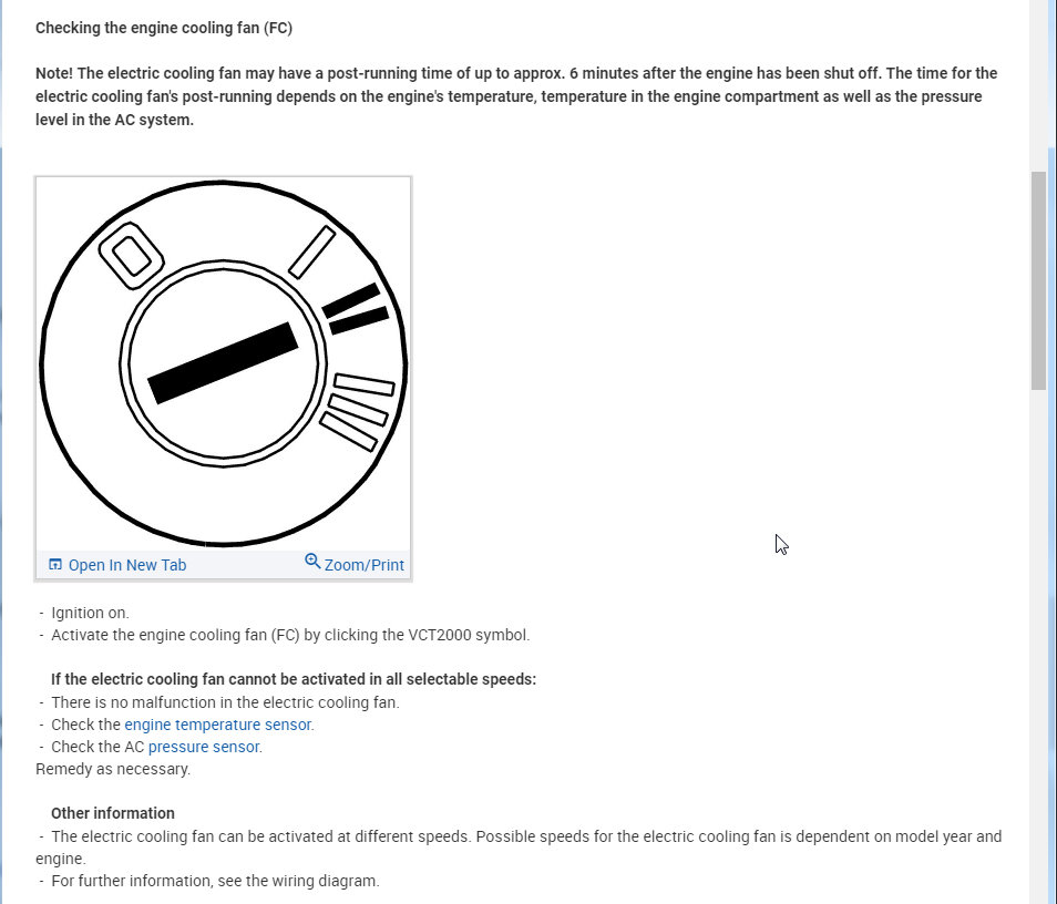

The main fan will not shut off when the car is running.
Apr 22, 2020 at 8:13 AM

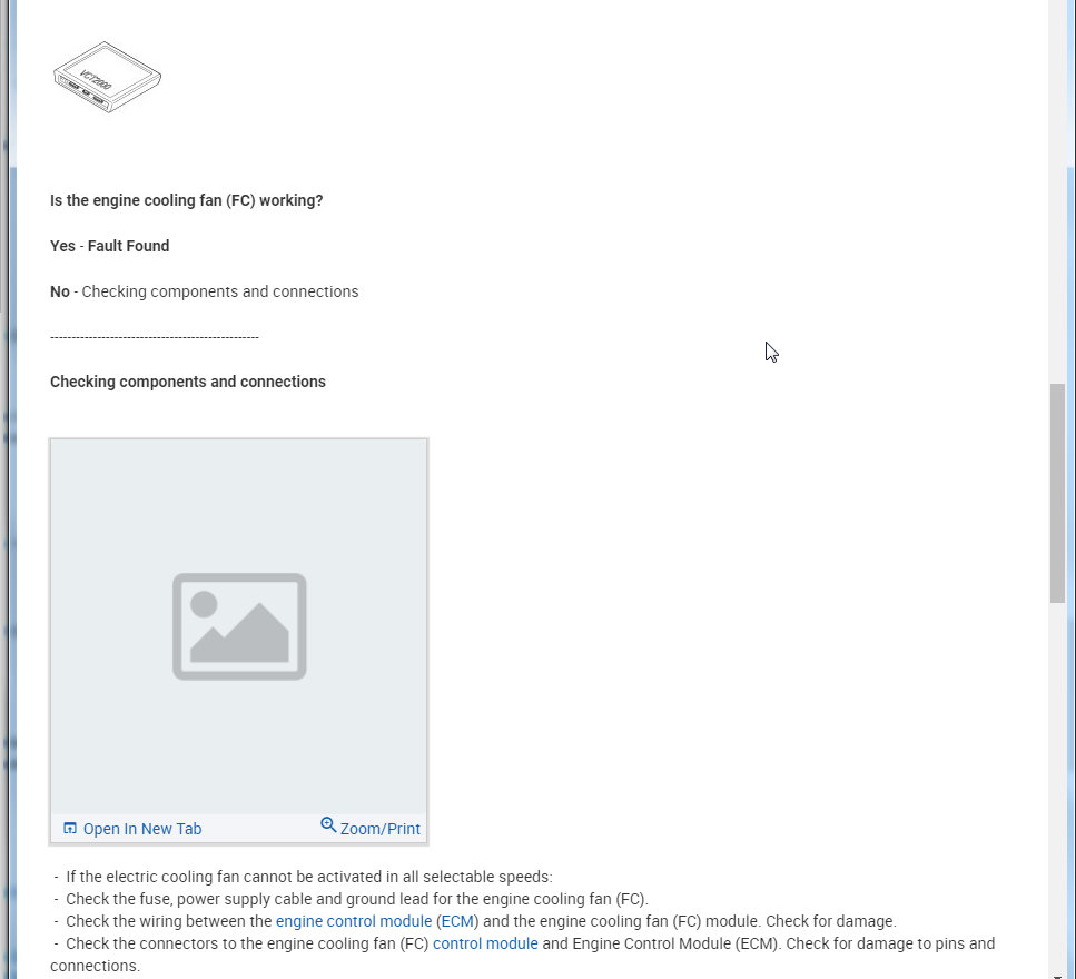

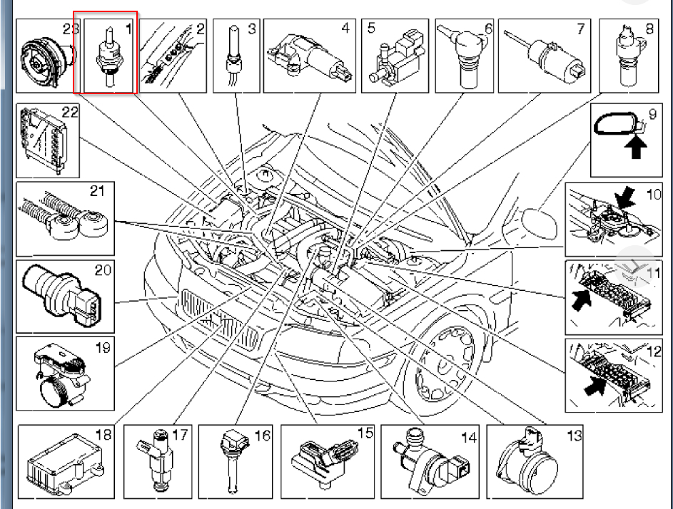

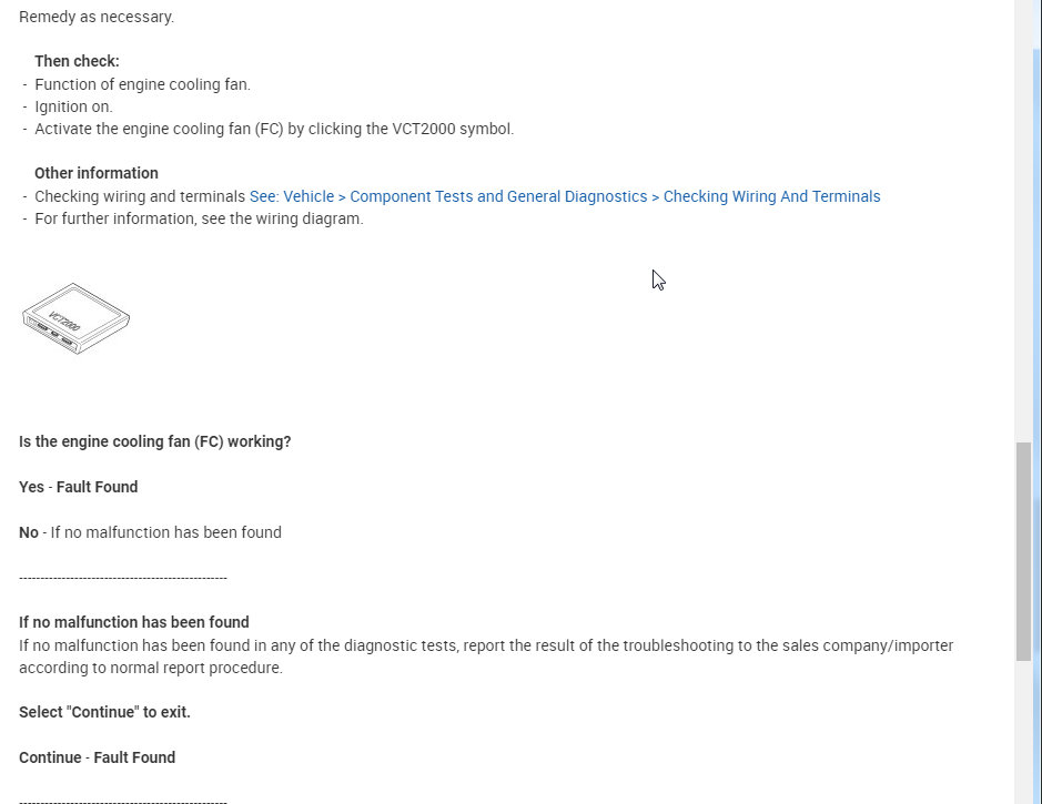

I suspect you have a cooling temperature sensor issue. However, we need to start with checking for codes. I also attached a testing for the fan. First set is get codes so let's start there. Here is a guide that walks through that. If you don't have a scan tool then stop by a parts store and they can check for codes.
If there are no codes then I suspect we have a wiring issue causing the fan to stay on high. However, this sounds more like a command issue because the ECM thinks the temp is higher then it is actually is.
