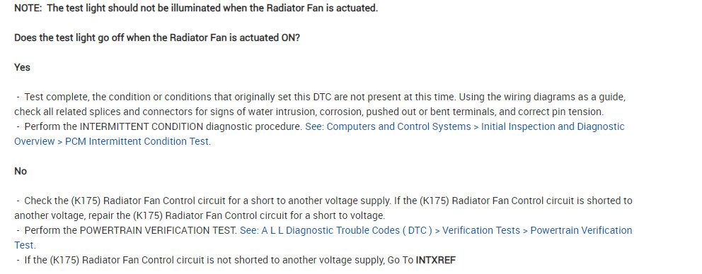

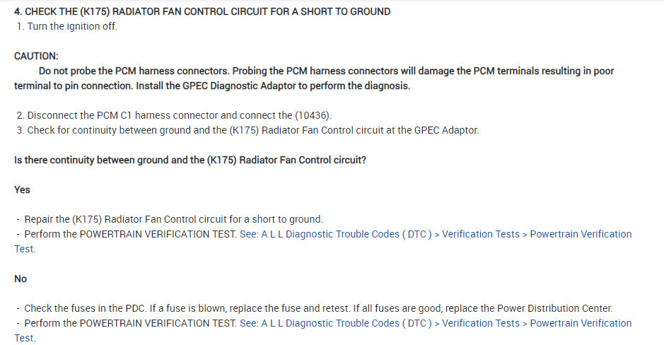

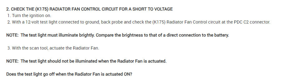

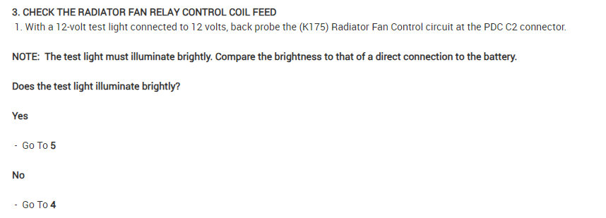

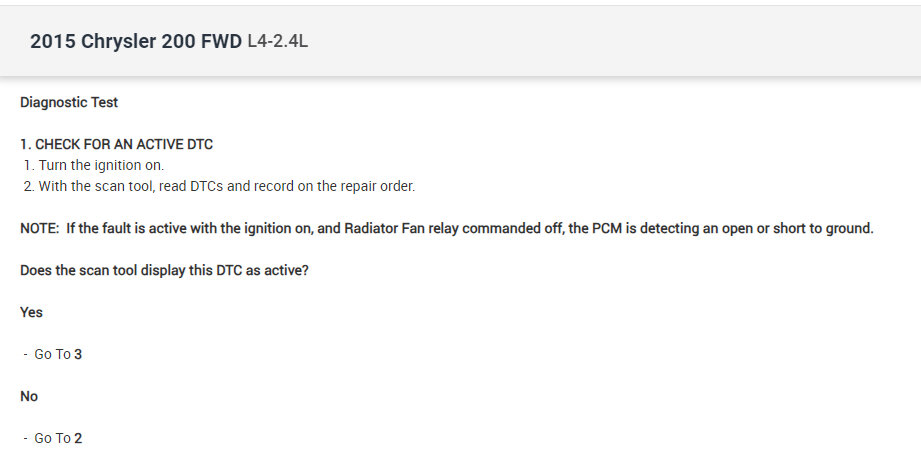

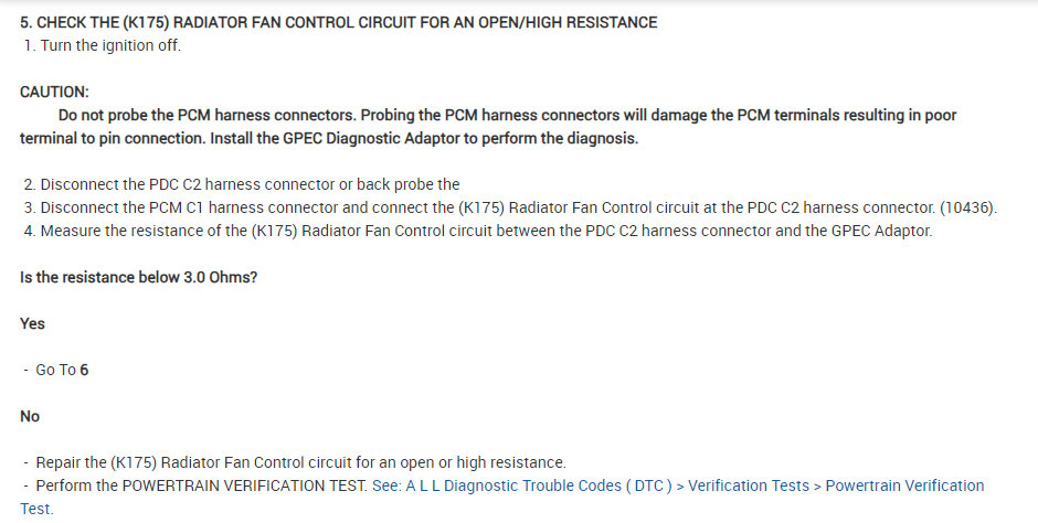

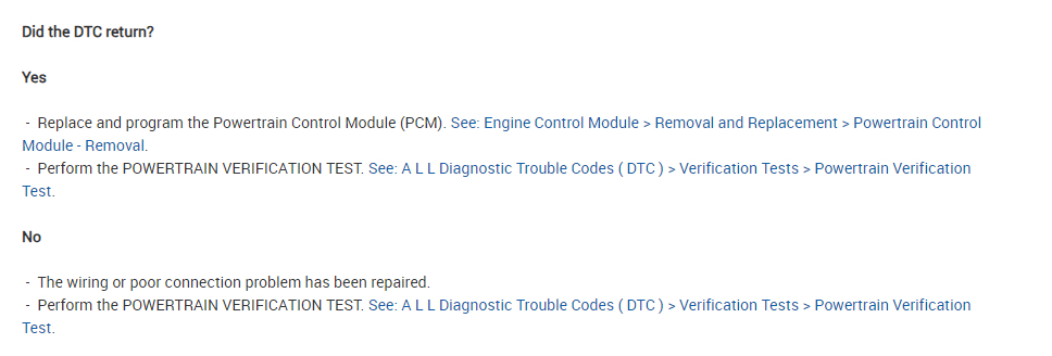

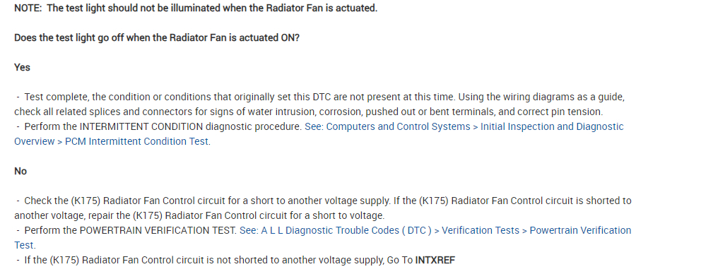

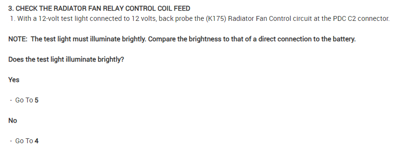

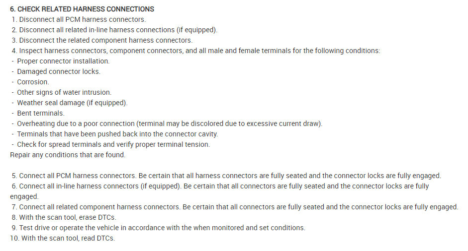

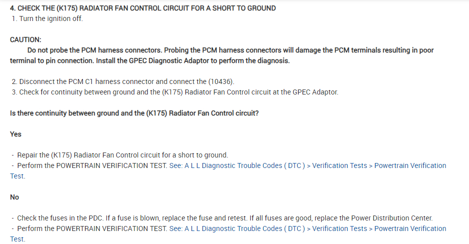

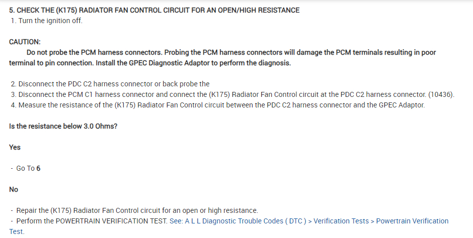

The code you have is specific to an open circuit in the fan 1 wiring. What that means is something is no longer connected, there is a broken wire, or there could be an issue with the powertrain control module (PCM).
Do me a favor. Take a look through the pics below. They provide the diagnostics related specifically to the PO480 code you have. Let me know if you feel comfortable performing them.
