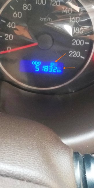

Just 2 days ago, I noticed that there are km and ml letters, and letters A and B displayed on the odometer screen when key is at on or engine running. After waiting for about 5 minutes, everything turns normal again. Refer attachment for clearer information.
In normal, it shows km and no A and B displayed, just blank.
No other issues with the car. Just those surprising extra letters!

It's my first time in 10 years. Such issue never comes before.
If they are trip counters, how to select a and b? There are no control buttons on my steering wheel? Is it a light bleed?
Wednesday, October 21st, 2020 AT 11:35 PM
Oh. I see. So they are just barely visible. Pictures truly are worth a 1,000 words because I think you are correct. It may not be a light "bleed" because that is an LCD screen and does not have light bulbs but I do think that is a cluster issue. More then likely the circuit board is "bleeding" voltage to those items and they are showing up very dim. That is not unheard of. If it were me, I would just leave it as it is not bothering anything. I am sure it will still work if you switch to miles or try to use those trip meters.

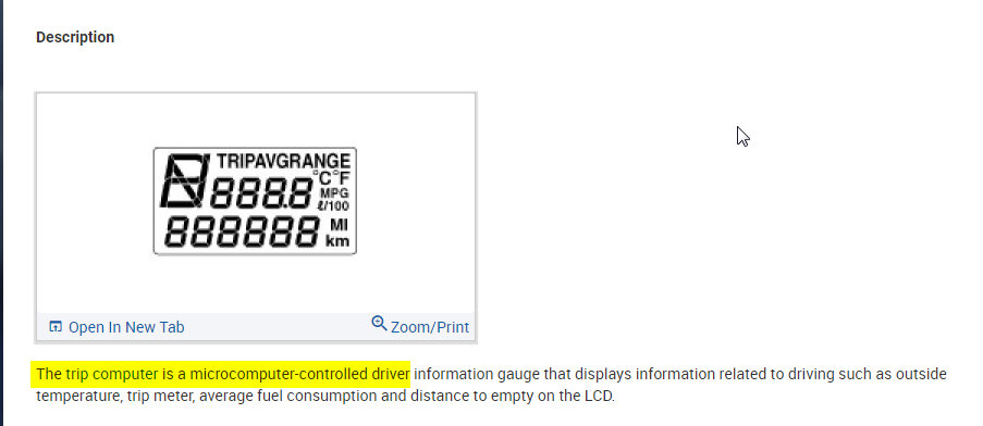

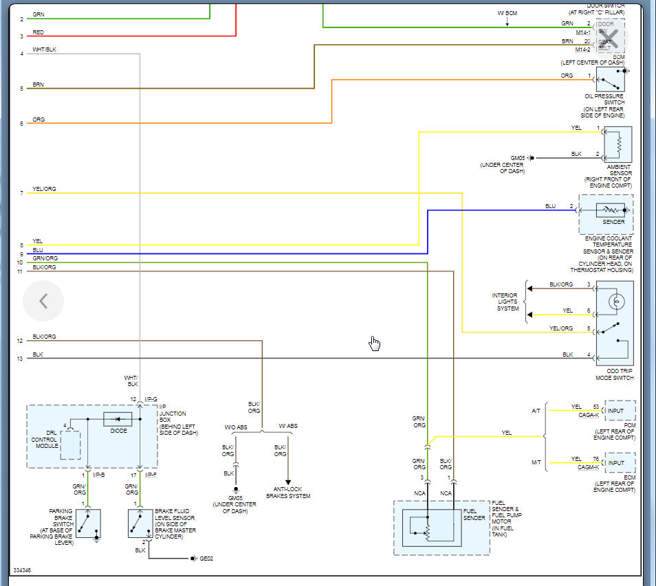

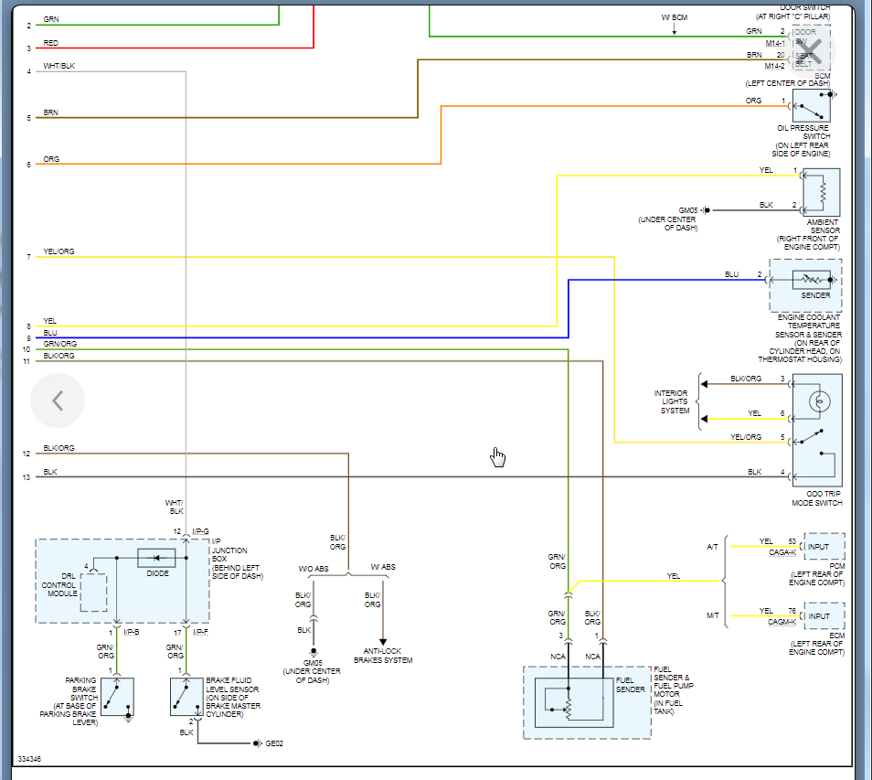

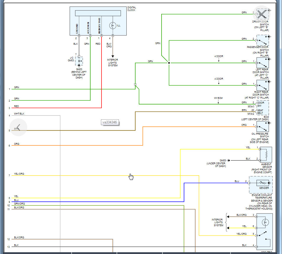

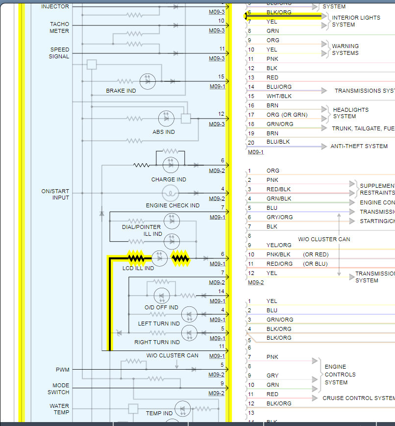

You are probably correct. However, we don't have a wiring diagram for your vehicle as it is not offered here in the USA but here is one from the USA version of your vehicle. While it may not be identical I am sure it is similar.
With that being said, the capacitor appears to be held in the cluster circuit board. As you can seen the interior lighting system runs this LCD screen and these capacitors are on the cluster board. So that means it would need to be replaced. If it were me, I would not worry about it but if you are going to make a repair, that is what I would replace.

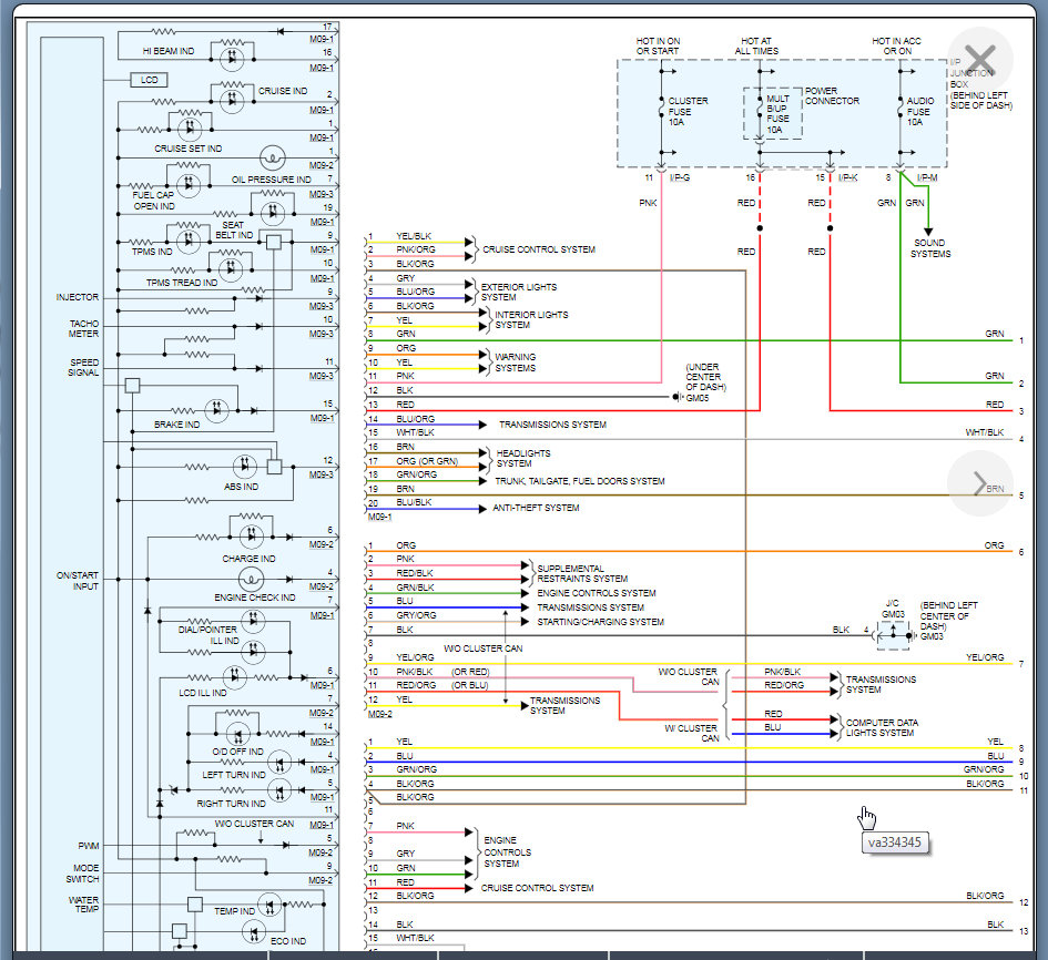

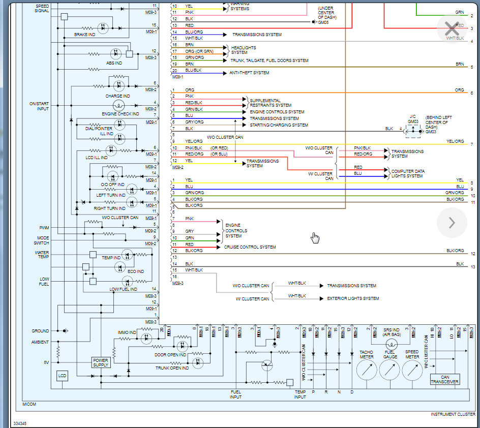

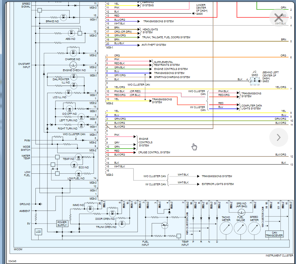

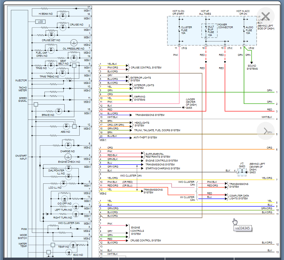

Please provide the complete whole circuit board diagram.
Sunday, November 1st, 2020 AT 6:25 PM
I am attaching the entire cluster diagram which includes the inputs. Thanks
