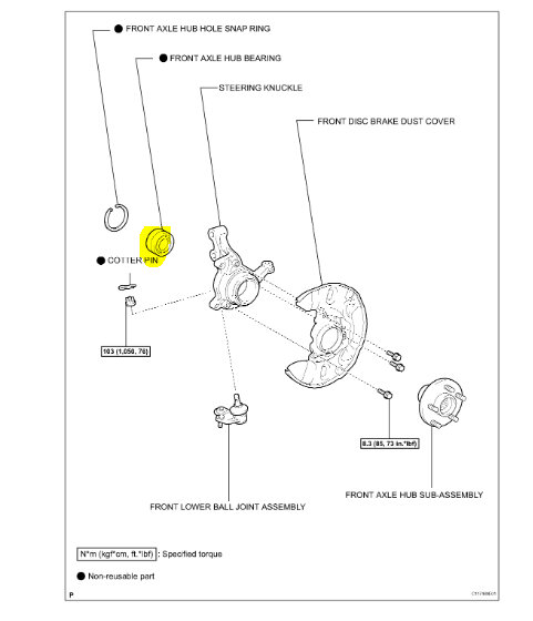

So, I need to know if the wheel bearings are included as part of the drive axle as my extended warranty covers the drive axle, but they are telling me that it is not included in the coverage? I have maintained regular maintenance on my car as recommended but now I have this bearing issue and the place wants over $800.00 to fix it just because it requires a press to do the bearings, is this not included part of the drive axle?
Oct 14, 2022 at 7:03 AM
  • 110,240 POSTS
I'm not sure what type of warranty you have. I suspect it is something you purchased in addition to the factory warranty.

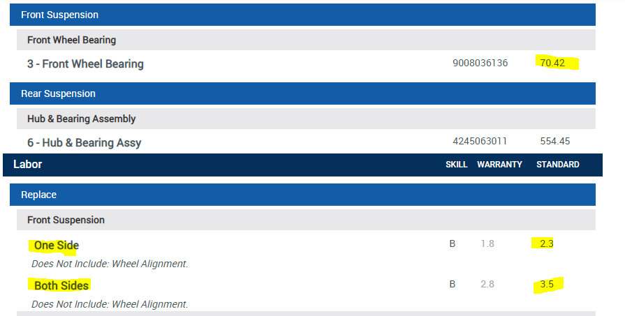

As far as the bearings are concerned, yes, they need to be pressed into the steering knuckle (see pic 1 below). However, that seems like a lot of money. The OEM bearing is 70.42 and the labor for one side is 2.3 hours. That means they are charging you over 300.00 an hour for labor.
If you look at pic 2, it shows the parts and labor for the repair.
I hope this helps. Let me know if you have questions.

So, I asked how much to have both sides done for replacing the wheel bearings and now the price they quoted me is $1,751.00. I about lost it; I will take my car elsewhere. And the extended warranty will not cover the work! So, I’m in search of someone who can help at a decent price. I want to thank you for your knowledge and for saving me from those thieves. Take care!
Oct 17, 2022 at 4:01 AM
  • 110,240 POSTS
You are very welcome. Please keep in mind, the OEM part cost I provided above may be marked up by anyone that does the work. However, it doesn't need to be OEM. If they use an aftermarket part, make sure it is something manufactured by a company like Timkin, SKF, or someone similar. If they use an inexpensive imported bearing, they never seem to last. LOL
