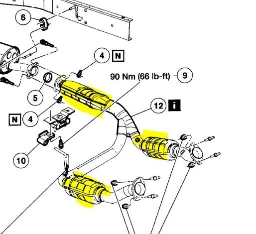

You are very welcome. I had a feeling that was related. The insides come loose and then move around. One minute it can run fine and the next, things move and it will lose power.
Here is a link that explains how in general to replace one:
https://www.2carpros.com/articles/catalytic-converter-replacement
If you look at the picture I attached, you will see three things I highlighted. Those are the converters. They are part of what is called a Y pipe and both bolt to the exhaust manifold. Let me know if you have questions or just need help.
