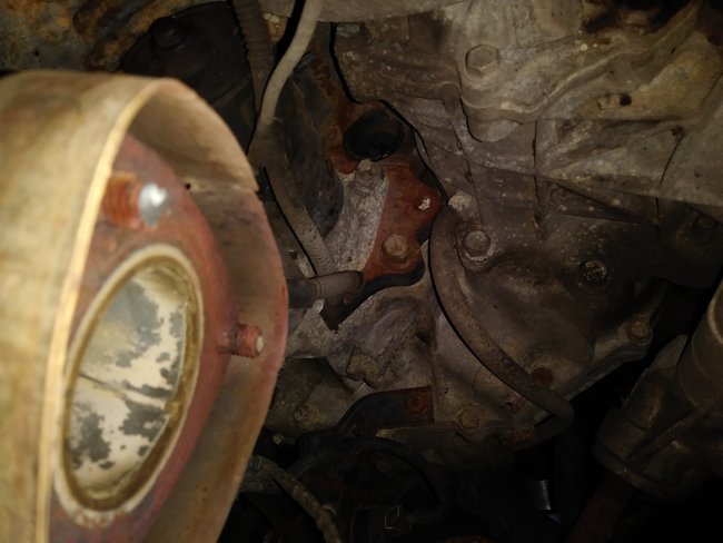

I'm trying to replace the exhaust on the car listed above. when I went to take the rear catalytic converter off the studs broke where it bolts to the manifold. can those studs be replaced or do I have to replace the manifold?
Aug 15, 2020 at 6:37 AM
This depends on if you can get the stud out. These studs are pressed in and are not easy to get out. However, if you can get the stud out of the manifold then it is fine to just use a bolt or repair kit. Can you get a picture of the studs as they are and that will give us the ability to see what you may need to do in order to get them out?
Usually we need to heat the manifold to glowing red and then use an air hammer to put them out but again, let's get a picture and we can go from there. Thanks

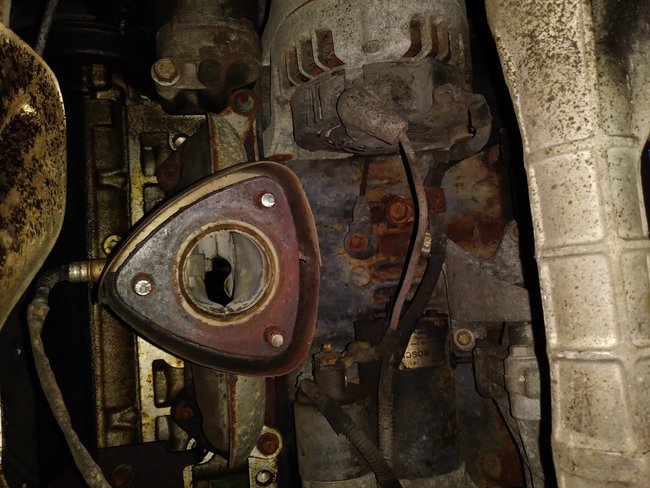

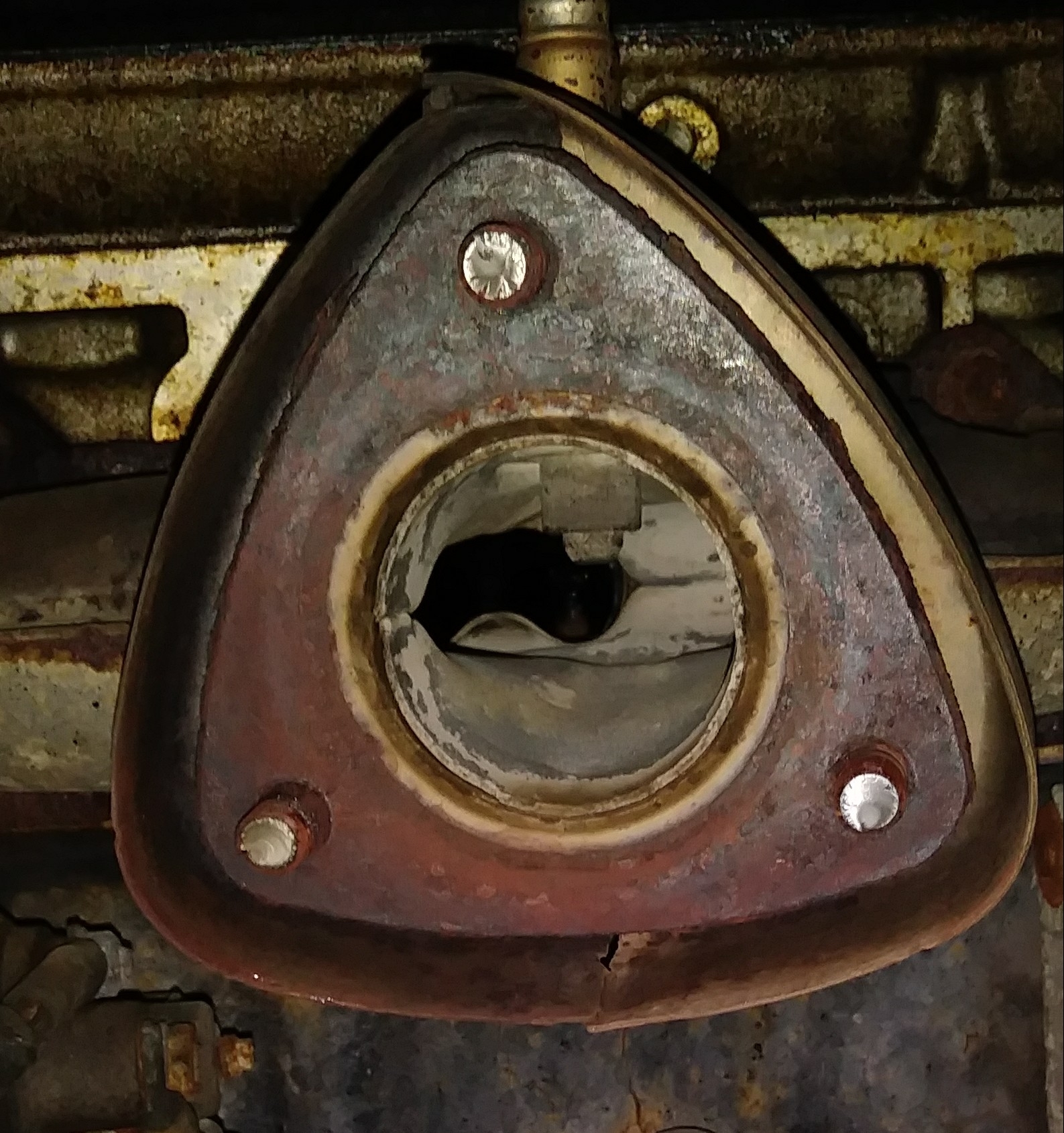

Hope these help.
Aug 15, 2020 at 9:59 AM

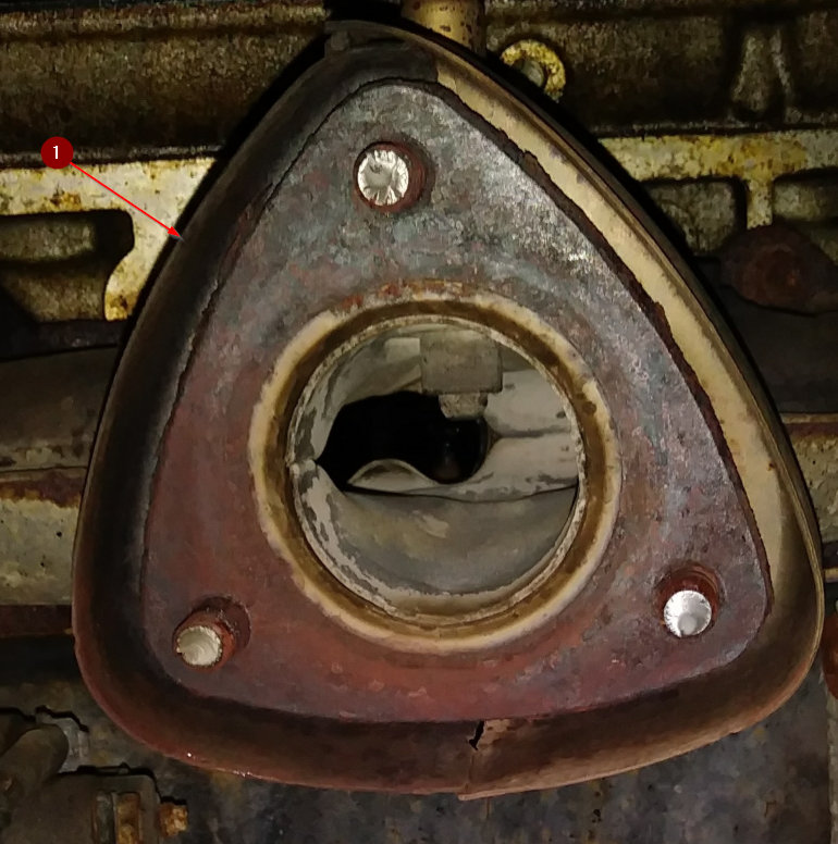

They definitely help but unfortunately it changes what I would recommend. I would replace the manifold because I am not sure you will get those out. You first need to remove the o2 sensor and then the shield around the flange.
If you remove those then you will most likely have to use a torch to heat the flange up then use a hammer and push them out. You may be able to do this easier with it off the vehicle but if that were the case, I would just put a new one on.
I think you have enough threads left there that you don't need an air hammer with a punch bit but if you have one that may make it a little easier.
Hopefully that helps. Let me know if you can get this shield off that I am pointing to in this picture. If you can the o2 needs to come out just to make sure you don't damage it. Then I would give it a shot.

Can't really see up in there, but I felt around I don't believe that shield comes off. Do you mean I might have enough threads sticking out for a stud extractor?
Aug 16, 2020 at 7:37 AM
Sorry. I meant you have enough thread sticking out that you should be able to hammer them out. These are going to hammer out the back of the flange but all that is moot if the shield doesn't come off. Not only is this a hard repair to start but doing it in the vehicle, I would think is next to impossible. So I would suggest just removing it and then make the decision on if you can remove them or just replace it.
