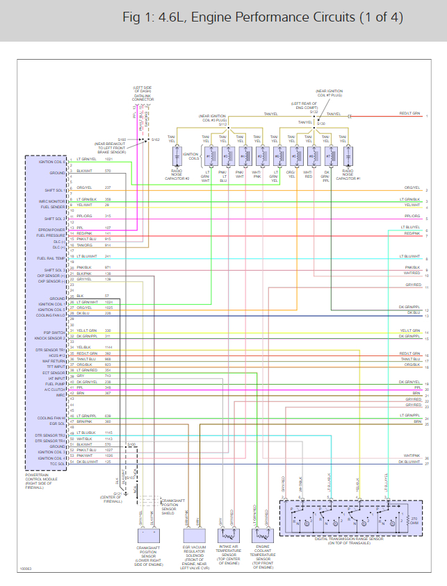

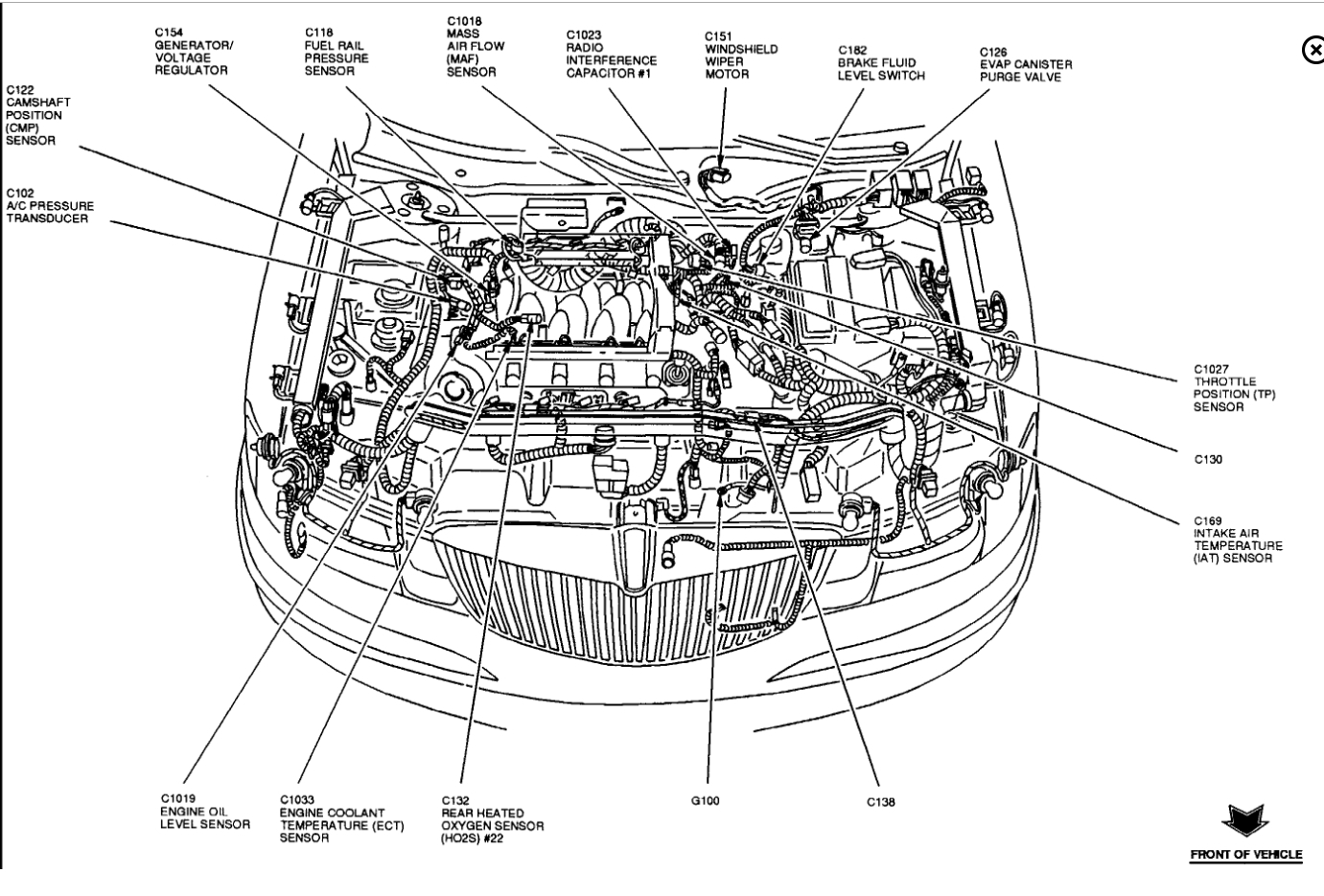

Also, still getting trouble code p0190.
+1
Sunday, May 13th, 2018 AT 7:18 AM
KEN L
  • MASTER CERTIFIED MECHANIC
  • 48,363 POSTS

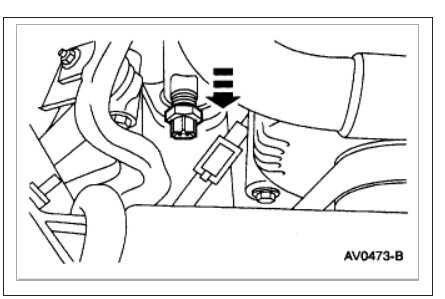

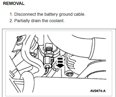

Anytime you have a temperature related issue I always lean toward the engine coolant sensor. Here is a guide to help you see what you are in for when changing the sensor out:
https://www.2carpros.com/articles/coolant-temperature-sensor-cts-replacement
Also for the p0190 lets check the wiring.
+1
