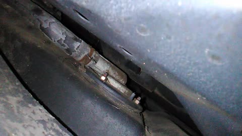

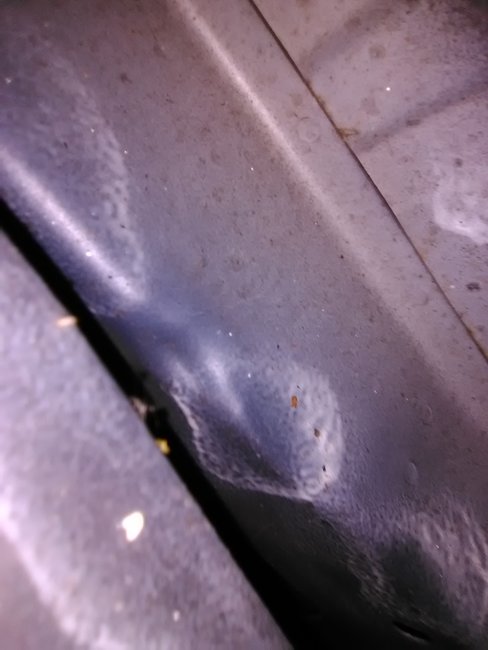

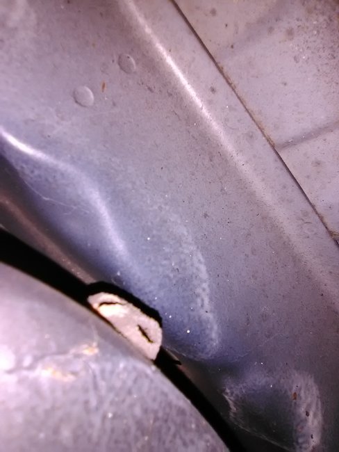

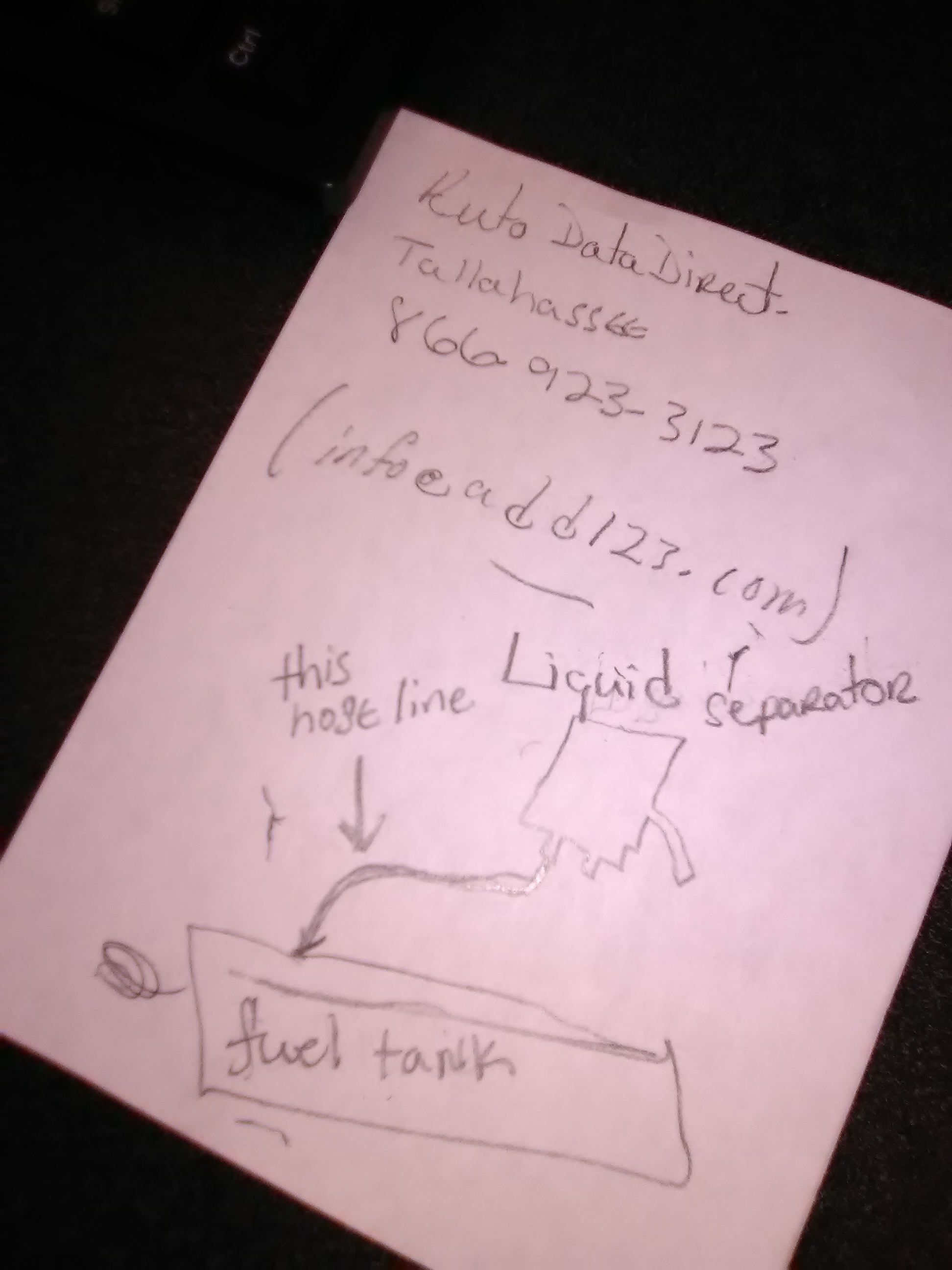

Good evening techs. question i have to change some hoses that are deteriorated with the EVAP system and the fuel vapor hose could someone identify the hose that is connecting fuel tank and the canister system.here is the photo. Mitsubishi has a name of pressure hose, suction hose, vapor hose. i can't get to a manual and having issues with my location. Chicago Illinois. here is the photo.

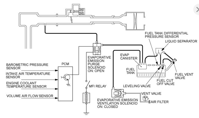

Hello, I'm Danny.
I've attached a picture below of the the system components you've requested. Hope this helps and thanks for using 2CarPros.

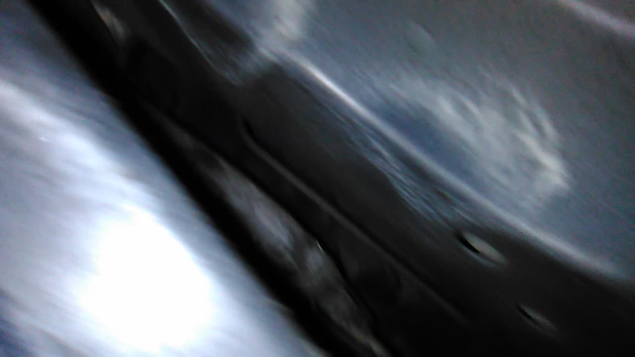

Here is a video. which hose is this?

I've attached a photo response to your previous (same) question. Hope this helps and thanks again for using 2CarPros.

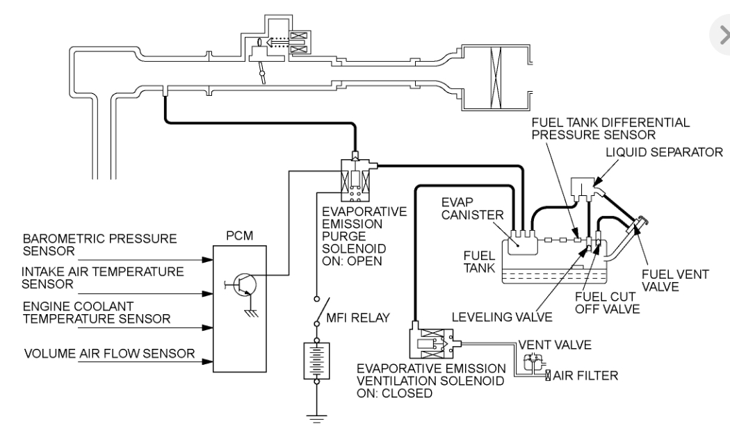

Danny, even if it is the hose line from the liquid separator to the fuel tank.the 90% angle hose on the left side of the diagram the hose is accessible to change without lowering the gas tank.i just need to know where i can purchase a new one because it has deteriorating areas around the angle near the fuel tank, but not that extreme. in fact i just had it emission tested yesterday here in Illinois and the only code that generated on the scanning obd was the po401 EGR valve. so i removed the EGR valve and PCV valve and cleaned them. i am just waiting for the computer to self eval and ready set.i think i am going to wait until i change my oil next month, 2000 miles then retest. what do you think? there shouldn't be any other faulty codes after clean and pming right here is the paperwork.

here is the hose line diagram:

Hello again.
Your best bet to get the hose would be a Mitsubishi dealership.You might be able to get one from your local auto parts store to save a little money.Usually after clearing codes it will take about 25-50 miles of driving to reset the PCM for testing.Hope this helps and thanks again for using 2CarPros.
