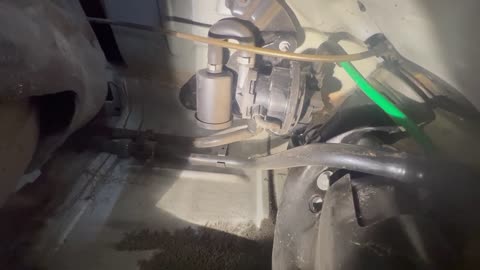

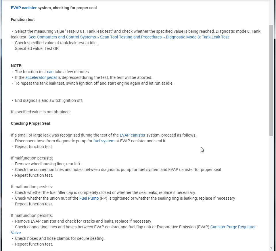

They smoked tested the evap system and found a leak from the air filter from the leak detection pump. Is it supposed to be sealed, when car is off? Or is the pump bad, if it leaking through the filter? they couldn't find any other leaks with the smoke machine.
Aug 22, 2020 at 12:14 AM

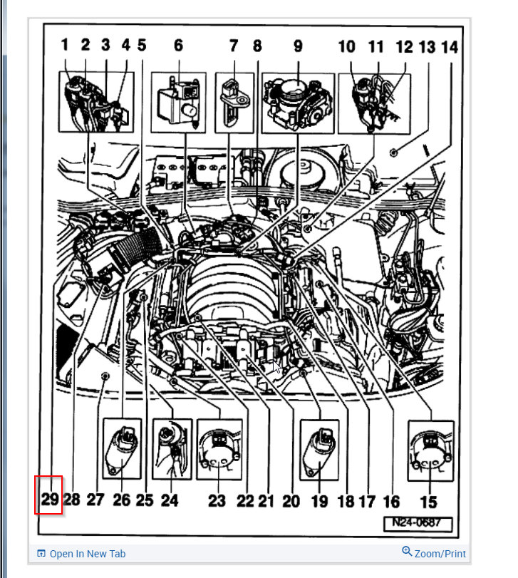

If it is leaking from the air filter then the purge valve is most likely leaking. This is what allows the vapor into the intake system so the engine can use it.
However, they need to make sure the valve is close when they are smoke testing it. Other wise they need to remove the feedline to the purge and plug it and then smoke test it.

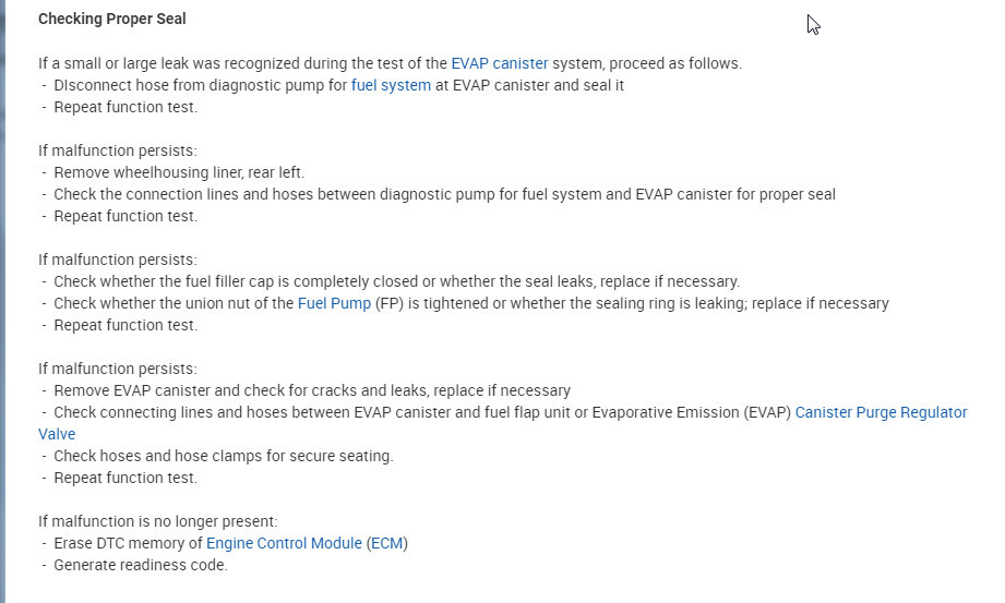

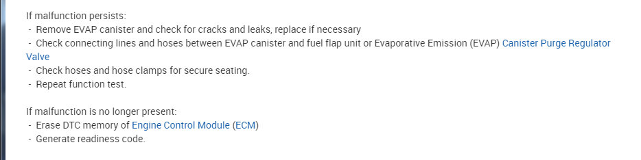

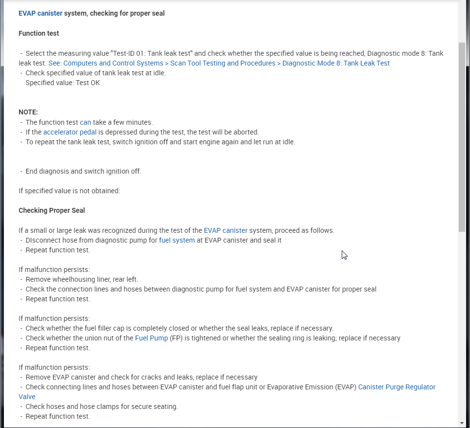

In fact, here is the process to test this system from the manual. It sounds like to me that they may have not done it this way. By disconnecting each component as it says, they are separating the system so they can find where the leak is coming from.
Let me know if you have questions because this is one of the more confusing systems to try and diagnose. Most people just take a line loose and pump in smoke then replace anything that has smoke coming out and that is not always correct.

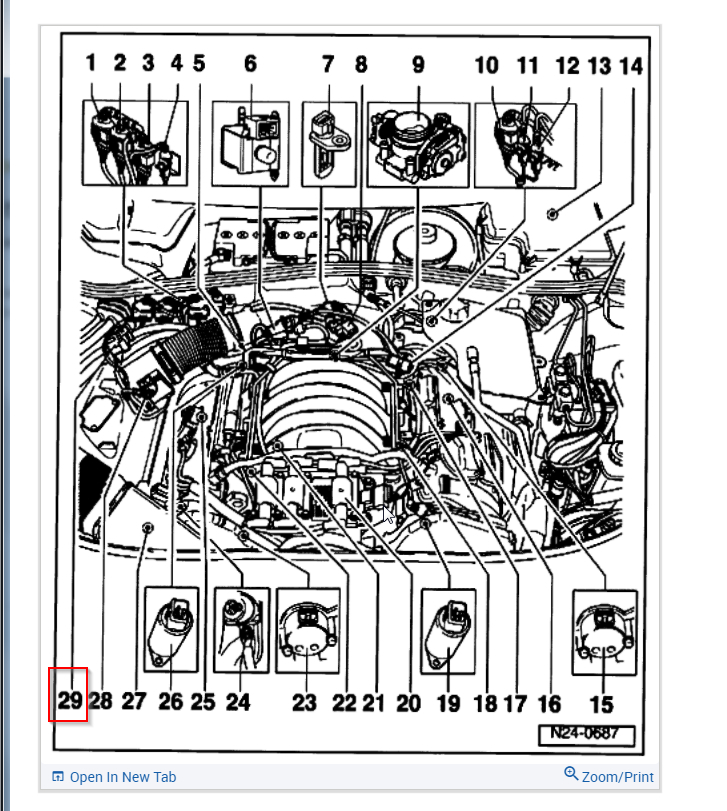

Lastly number 29 is the purge that I was talking about. It is located on the air filter housing.

I made a mistake.i meant the vent valve.the filter in the vent valve that's in the leak detection pump. Is it suppose to leak?
Aug 22, 2020 at 3:51 PM
If you are testing the entire system with smoke with the pump hooked up then yes, I would expect smoke to come out of there. The first step in that instructions that I sent was to disconnect the line from the pump to the fuel system and seal it then test the system. If it persists to move further into the system.
Aug 23, 2020 at 6:33 PM

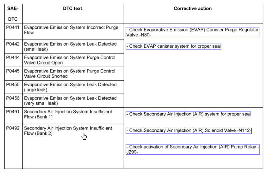

I got the same code again. I bought a smoke machine and found no leaks on evap system or engine side. I removed the leak detection pump to bench press with a balloon. the balloon doesn't inflate that much.is the ldp air pump bad? And will a bad ldp air pump cause p0442 or p456?
Sep 13, 2020 at 4:33 PM

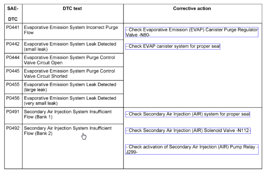

Unfortunately both of these codes are pointing you to a leak and a weak pump would not cause this.
When you smoke tested the system, where did you put the smoke on the EVAP side?
I attached the testing. Let us know and we will figure this out. Thanks
Sep 13, 2020 at 8:04 PM

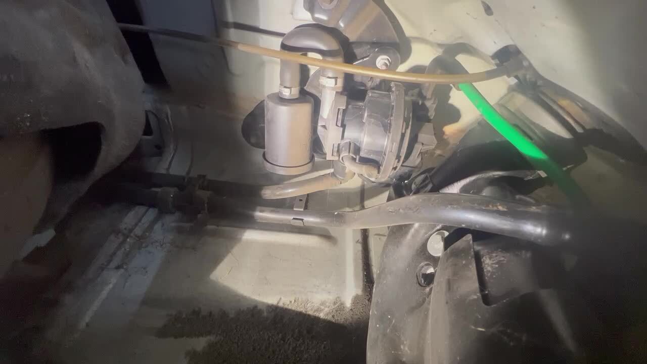

I have an 08 Jetta and I get the code p0455
And p0441. I fixed a leak from a hose connected to the secondary air pump seems to have helped my fuel trims I think. I smoked the system from the hose in Evap hose in the front and saw smoke come out of the right rear well. I took off the well cover and smoke was coming out of the leak detection pump filter with the car off. No other signs of smoke coming from anywhere else. Isn’t this system supposed to be closed off until activated?
