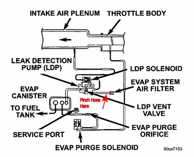

it has a large leak and a small leak. Have replace gas cap . We did a smoke machine and the only smoke we saw was coming out the tail pipe.

Here are some common fixes related to having both codes. Take a look through them and let me know if it helps. The attached pics correlate with these suggestions.

DIAGNOSIS:
You Tube - Chrysler EVAP P0442 P0445 Smoke Diagnostics
1. Verify the fuel level is between 20% to 80% full and the gas cap is correct, and tight.
2. Disconnect the EVAP purge solenoid electrical connector. Pinch off the vent hose after the vent solenoid. Introduce smoke at the service port. Start the engine and test for smoke.

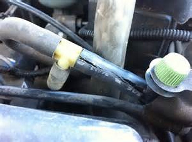

3. Perform a detailed visual inspection of the EVAP system hoses and lines. Especially the purge canister hose harness, at the rear of the vehicle, and the EVAP hoses inside the fender well area.
4. Repair or replace any leaking components.
Pic 1

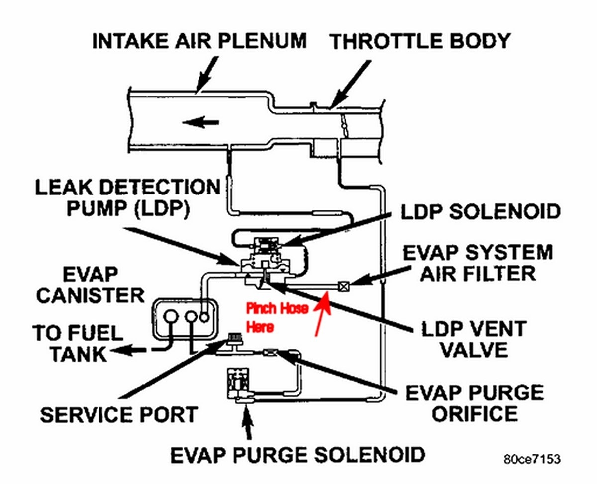

CORRECTION: Repair or replace leaking EVAP System Hose/Line.
SKILL LEVEL: B
LABOR TIME: 0.3 hrs.
COMPONENT LOCATION: The EVAP system hoses and lines are located in the engine compartment near the firewall, to the left rear bumper fascia area. The EVAP canister and Leak detection pump are located behind the left-rear wheel.
Pic 2
Let me know if that helps.
