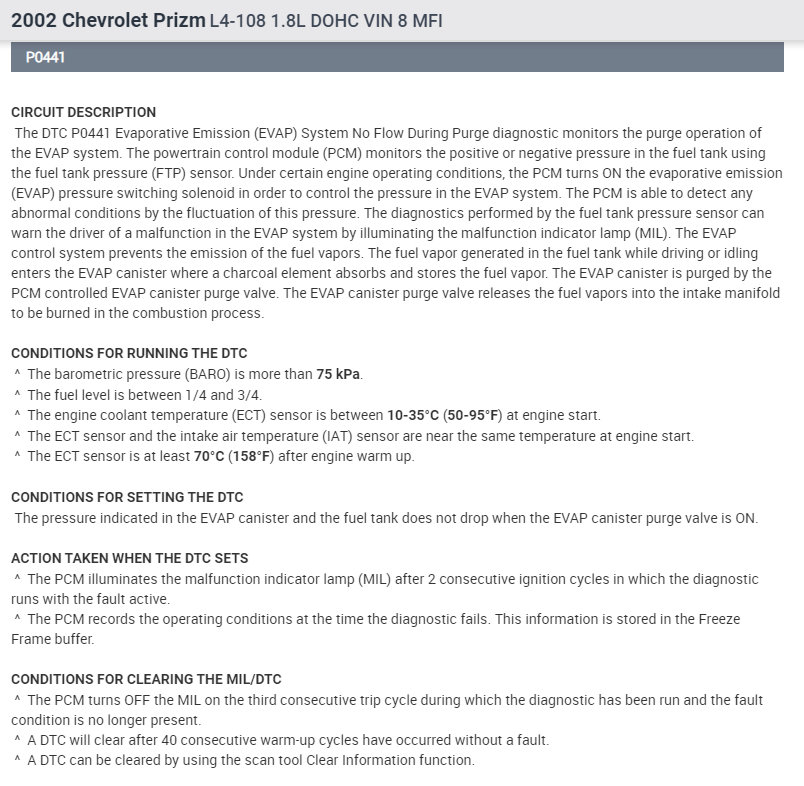

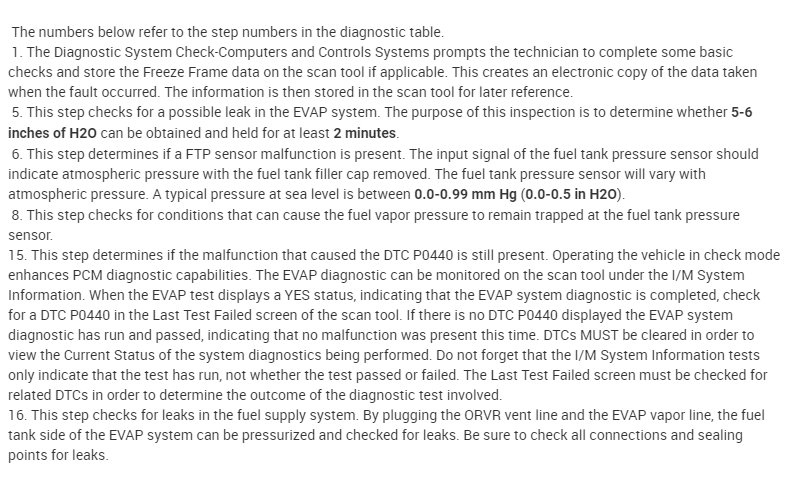

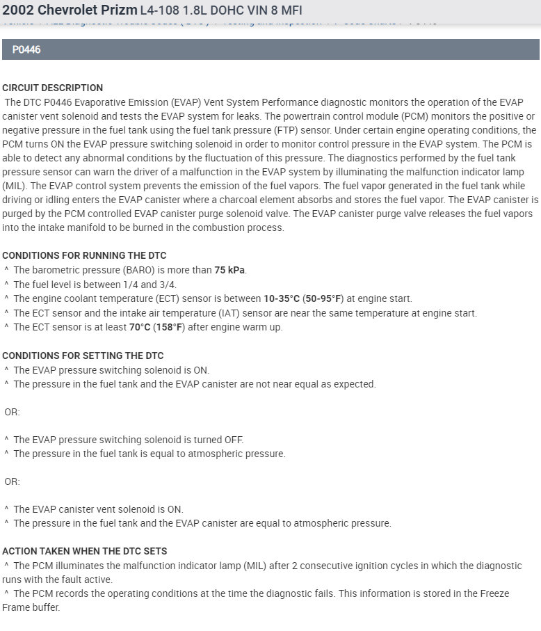

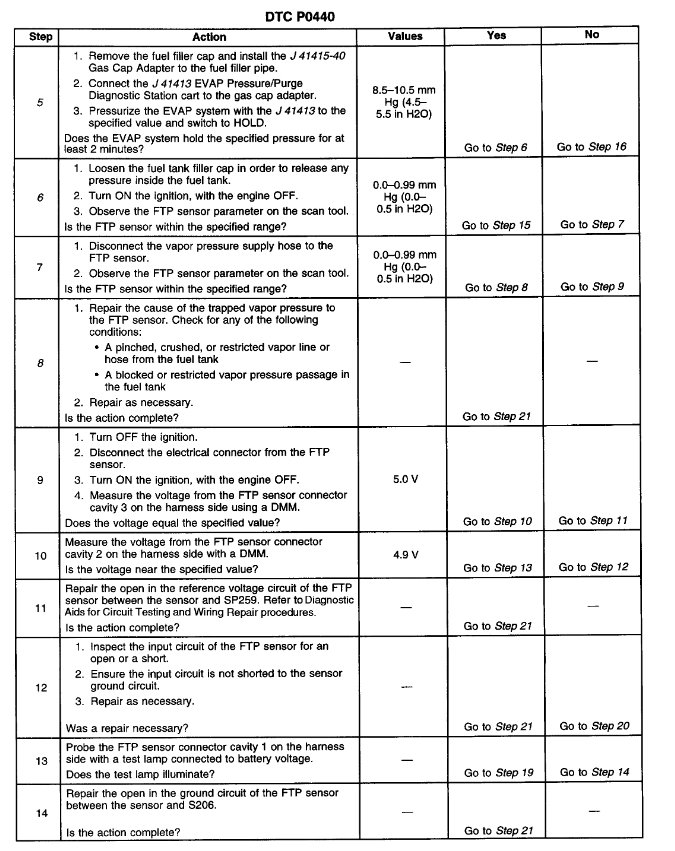

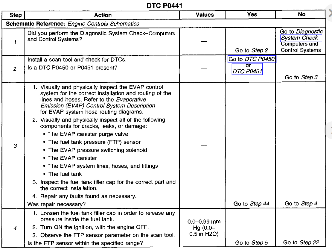

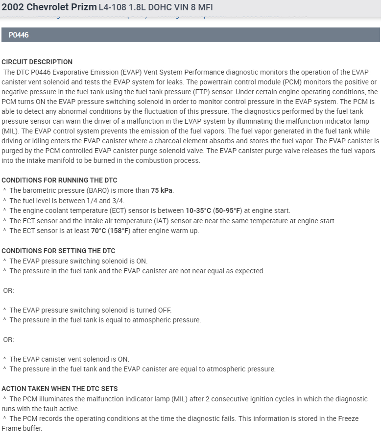

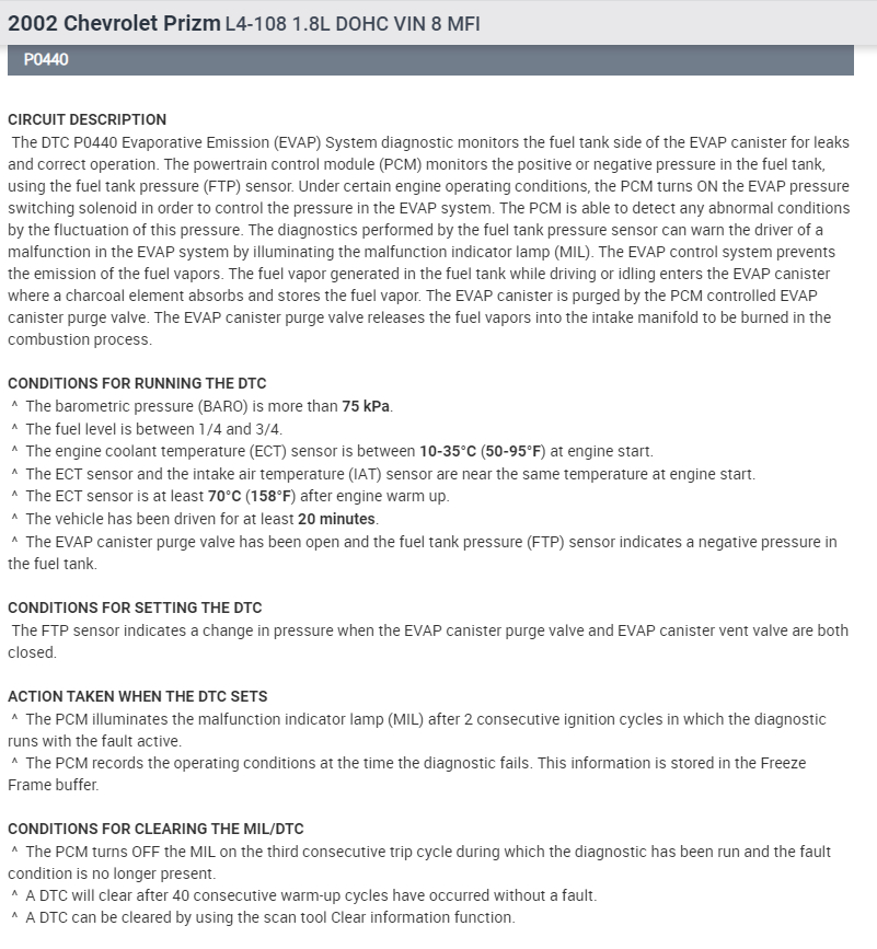

Hello. I checked the codes on the car yesterday just to see if anything new popped up. It's had a couple that I've been trying to address for a bit. Three new Eval codes showed up as pending. P0440, P0441, and P0446. I kind of sort of over-filled the tank the day before yesterday. Could overfilling the tank have caused those codes to set, or should I start chasing?
Jun 9, 2022 at 9:05 PM
SQM
  • 6,383 POSTS

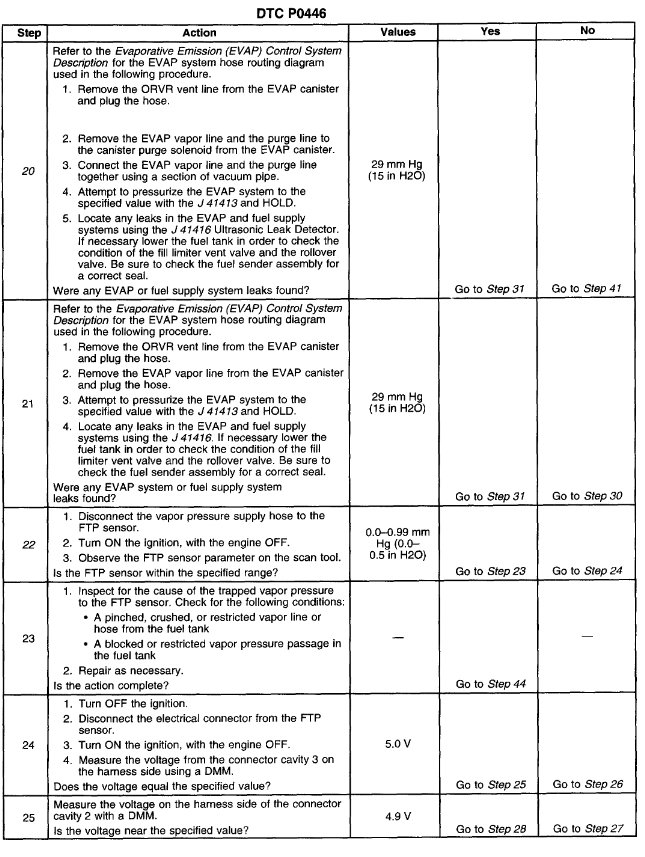

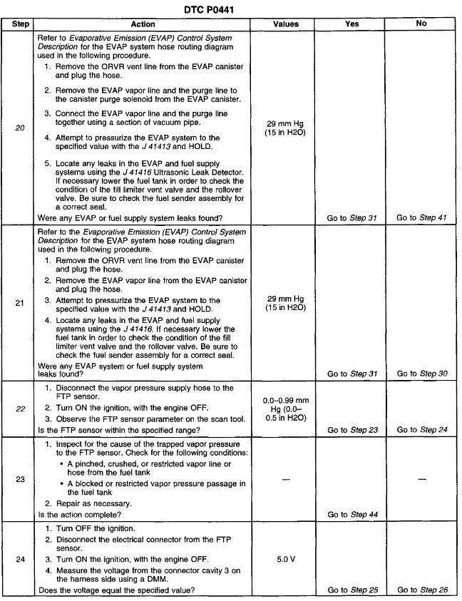

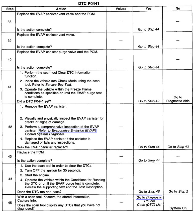

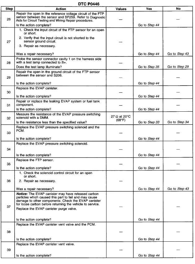

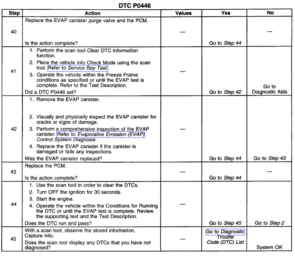

The EVAP codes can get triggered due to any leak within the system. That is primarily what those code that you have.
Here is a helpful guide:
https://www.2carpros.com/articles/evap-system-code-repair
The best course of action would be to take a look at the possibilities and find the issue.

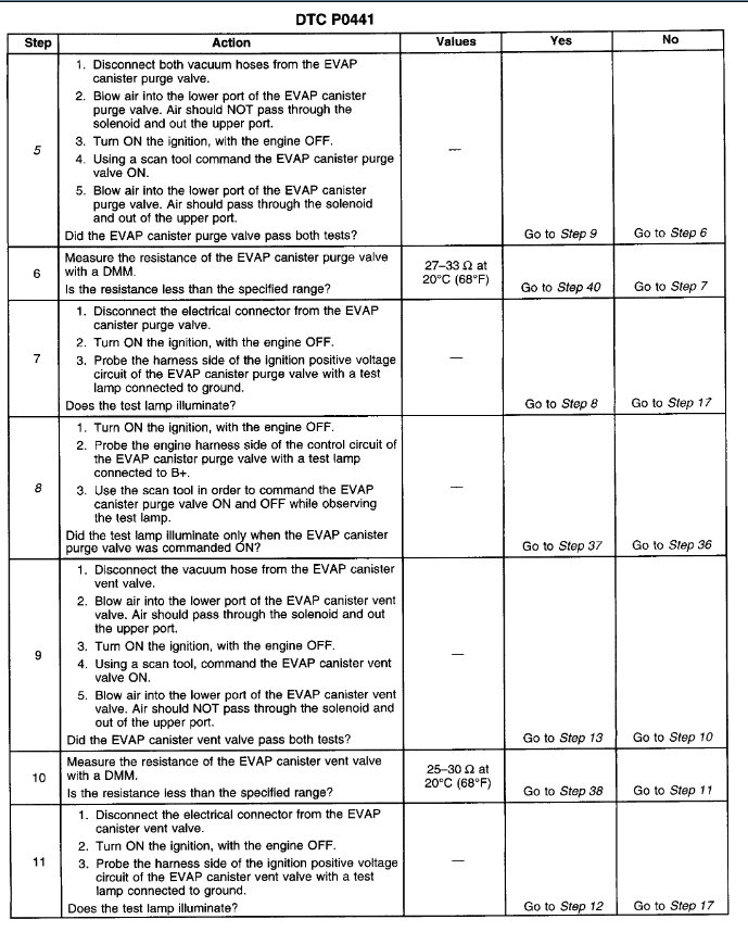

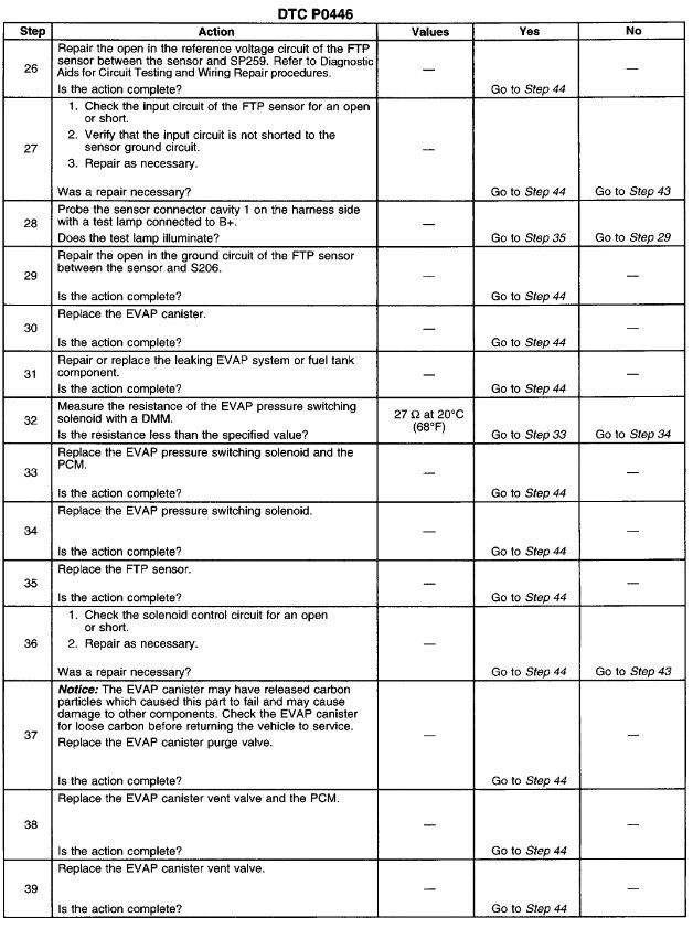

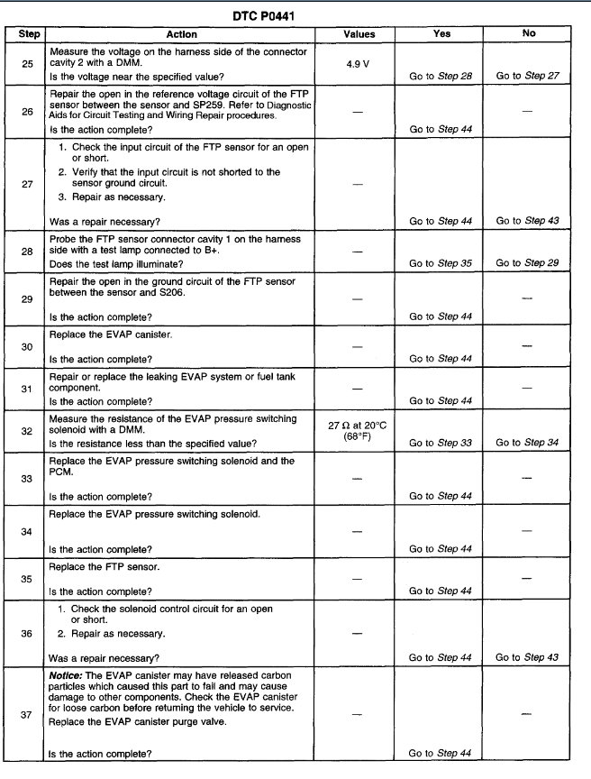

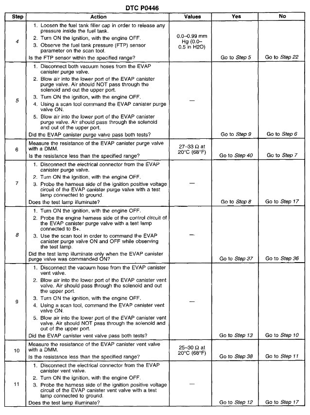

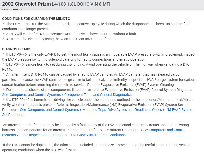

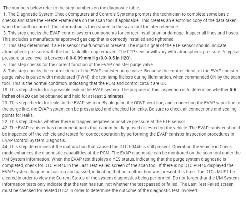

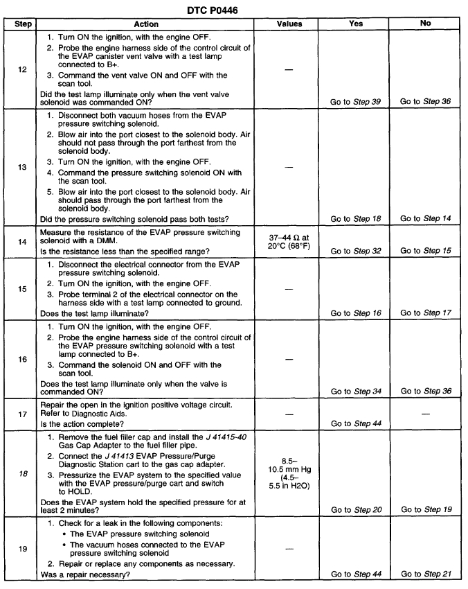

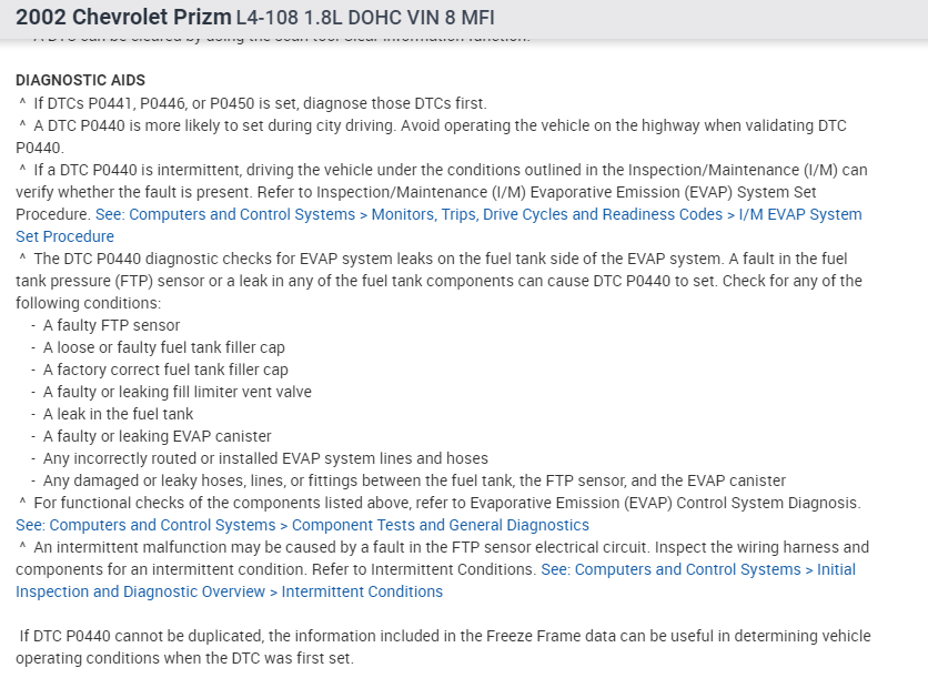

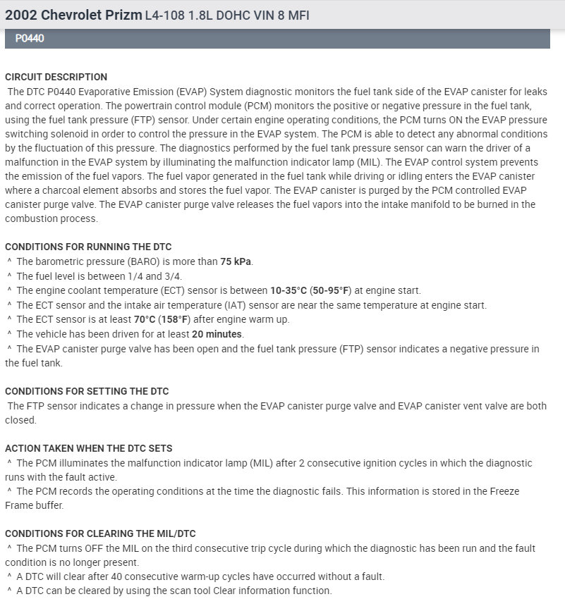

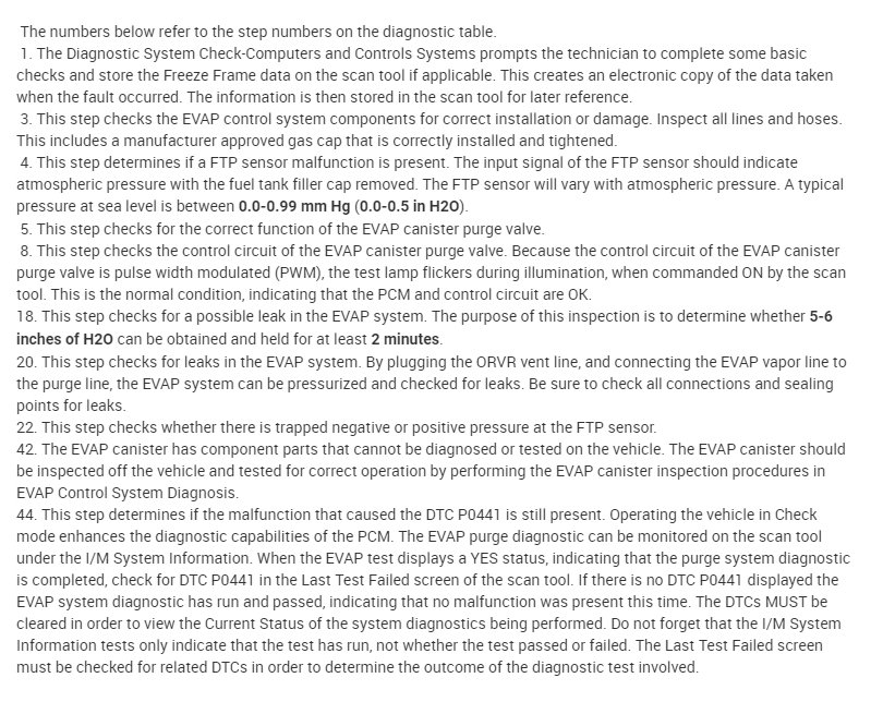

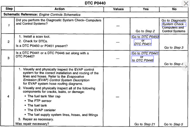

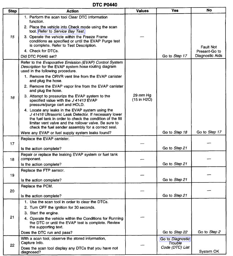

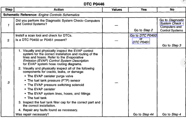

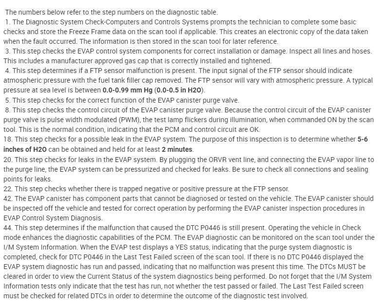

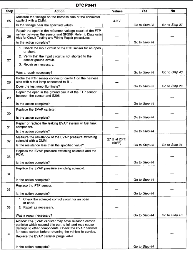

I have attached the troubleshooting guide for the codes P0440, P0441 and P0446 below.
Follow those steps, as it can help you determine the problem.
Let me know of any questions.
