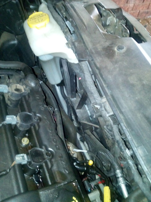

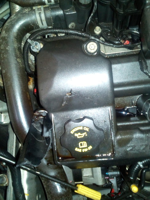

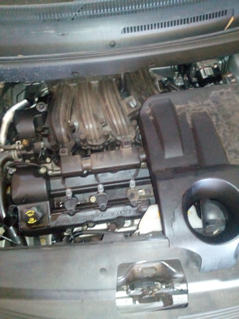

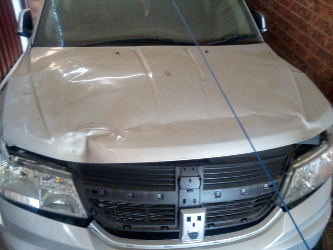

Please see pictures my main concern is the crack on engine is that serious? This damage was a low speed crash. I am aware side guards and bonnet need replacing can anyone see any work needed to be done internally and if you could give me an estimate for work. Please and thank you.

We do not get involved with estimates here because we cannot see all the damage, we do not know parts or labor costs, and there's other variables. The only damage I can see is in the first photo. That appears to be a fiber cover that is bolted to the engine. As such, it should be fairly easy to replace. You might even find a good used one at a salvage yard, although it would have to come from a bad engine. The yard wont want to sell a cover from a good engine.

The first picture looks like your valve cover is broken.
