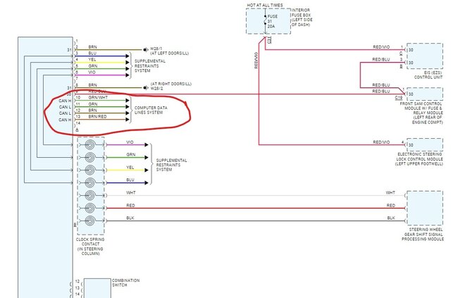

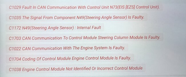

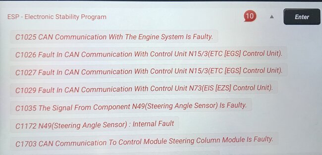

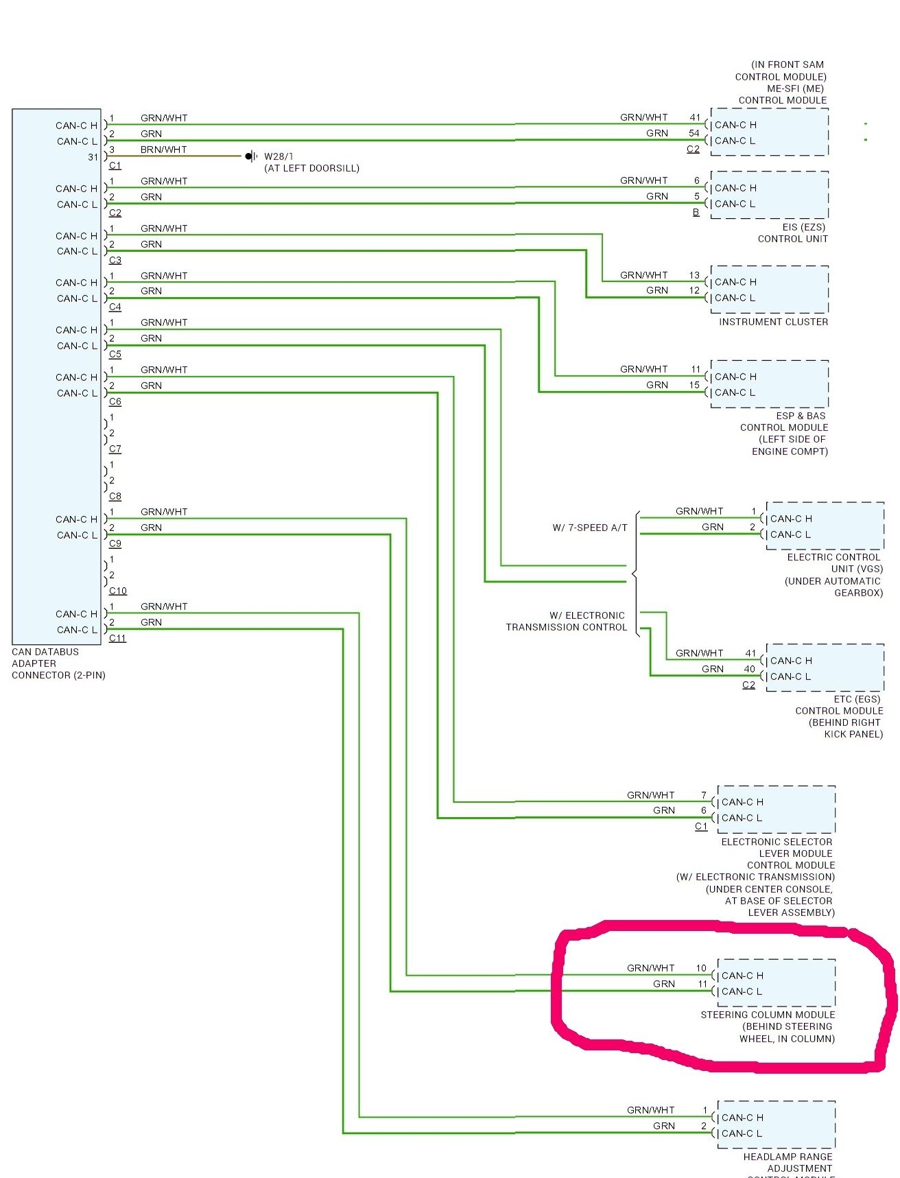

I have 10 Esp codes. What trouble shooting can I do for that? Codes below.

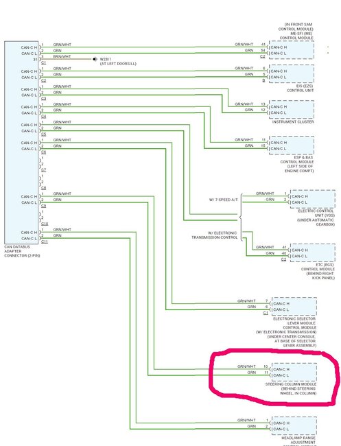

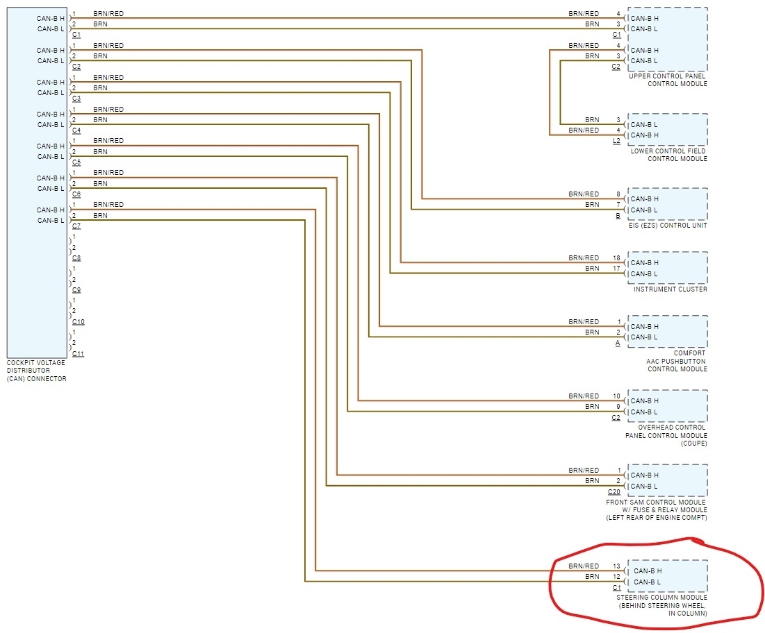

Looking at those codes you have a failure in the CAN bus. You would need to start with an oscilloscope connected to the CAN bus to see what the signal looks like. At the moment it is either missing or very corrupt. Then isolate each component on the CAN bus one at a time until the signal returns or is correct. Then you can repair or replace that part. I would start with the steering column module as there are numerous codes for it, however MB has the module on both the high and low CAN networks, so it makes it harder to test. That is, however, where I would look first. It might be possible to unplug the connector on the steering module and then erase the codes and see which ones return. The problem with that is MB likes to report the loss of signals as well as signal failures so you can end up with other codes as well. That is where using a scope to test works better as it can test with things connected and isolate the data problem.

when you say steering module do you mean steering angle sensor under airbag ?
May 22, 2024 at 10:18 PM
STEVE W.
  • 15,344 POSTS
The steering module is basically the entire column unit. MB loves to stuff a lot of things into a small package, so they put all the controls into the column along with a computer module that uses all of the sensor inputs and passes them on to the rest of the vehicle. So the turn signals, light controls, steering sensors, airbag, and more all in one module with a data network inside it that connects to the rest of the vehicles networks.
