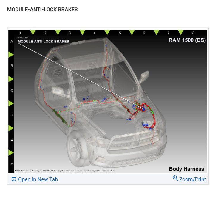

ESC light stays on checked the sensor that the dealership told me to check light still on code is C121D.
Sep 14, 2022 at 4:34 AM
  • 55,224 POSTS
The C121D code: The Anti-Lock Brake System (ABS) Module monitors the Brake Pressure Sensor. Is the brake fluid full? This sensor is inside the ABS module so to fix the issue is to replace the ABS module. here is the location and how to do the job, so you know what you are in for during this repair.

Yep, how do the brakes seems to work? If okay then this leaves the ABS control module that needs to be replaced. Let me know what happens please.

We found out exactly what it was, its the hcu and ABS module
