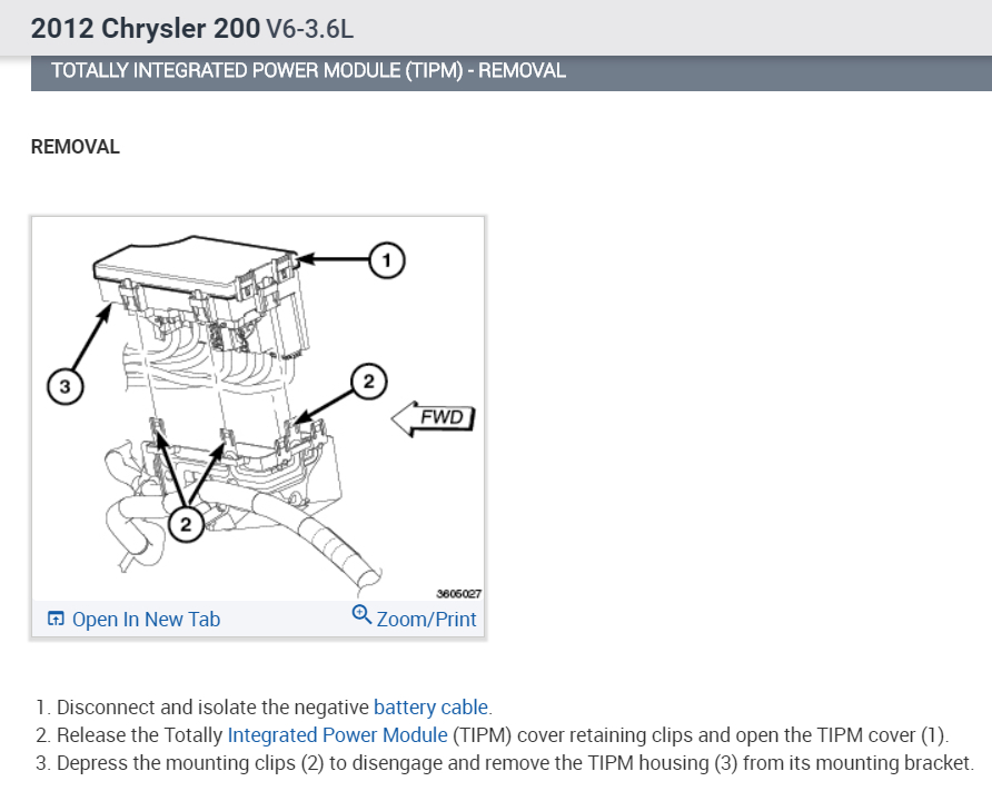

yes, i have brake lights and we have already replaced that switch six days ago. then thought the wheel bearing was bad on driver side. replaced that and cleaned the wheel sensor. here is what it keeps doing: Two day ago etc indicator came on, turned car off started back up, couple hours later it came back on again, shut car off started back up and the check engine light was on, giving same code. later that evening started the car and no check engine light. yesterday drove car all day with no lights or codes. now today it did it again, esc indicator came back on.
Feb 15, 2019 at 3:27 AM
  • 55,447 POSTS
Hello

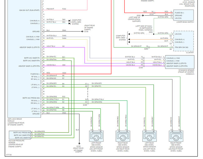

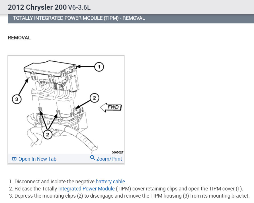

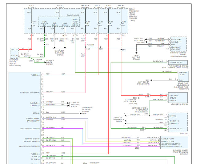

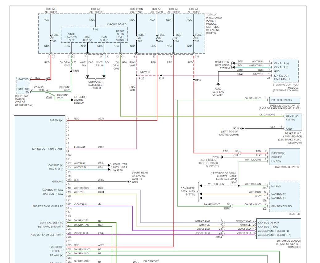

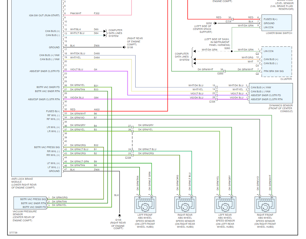

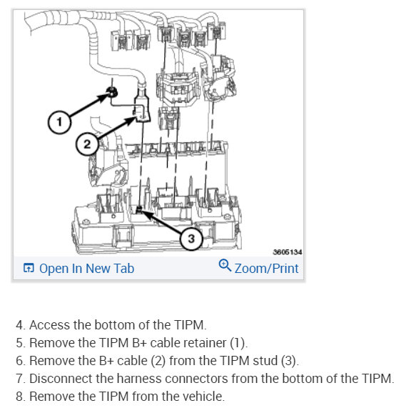

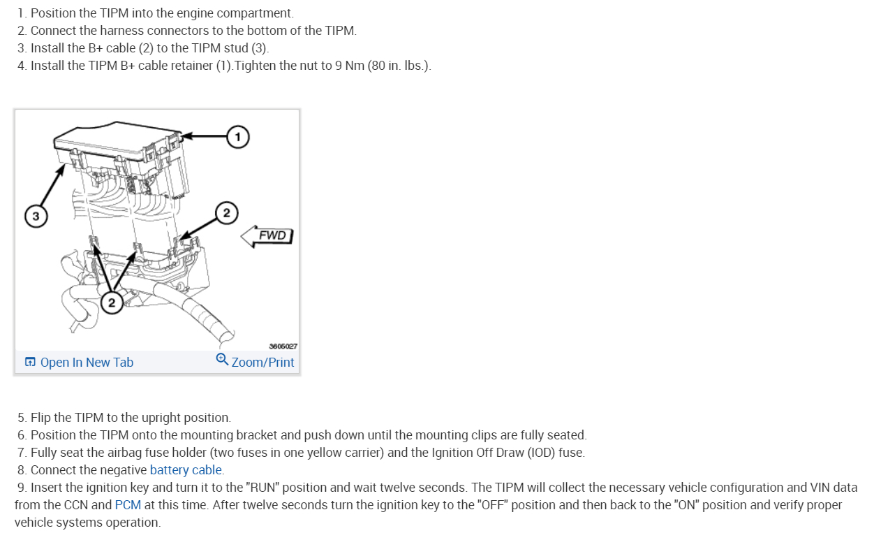

First check the brake fluid level if okay it sounds like the TIPM is going out. but to be sure here is a guide to help check the wiring between the switch and the ABS module and TIPM. Use the wiring diagrams below for reference.
If the wiring is okay I have included the TIPM replacement installation and diagrams as well. Check out the diagrams (below). Please let us know what you find.
