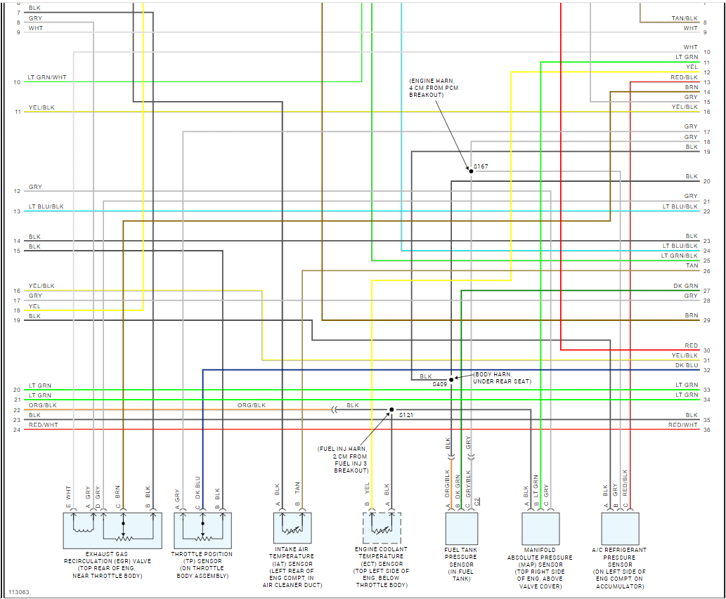

Dear technician,
In my car listed above I very often have the Check Engine Soon notification with this number: No. P0446 and text: EVAP Vent System Performance.
My capable car-technician (experience with USA-cars) told me it has to do with this:
Gasoline vapor in the tank is sucked to the engine through a thin pipe with 2 valves.
Valves are opened/closed by the car-electronics, call it system, and based on that the system says OK (does nothing) or reports the PO 446-error.
Note: he has a device to control & simulate & read the system, below I call it “screen”.
He cleaned and checked the gasoline-inlet if it is closed 100%, it’s OK.
He tested the thin pipe and the valves, no blockage and no leaks.
To be sure he replaced one valve (close to the tank).
To check the wiring, he needs a drawing of the system with the numbers/colors of the wires on it.
Please be so kind to email me that drawing so we can check the wires.

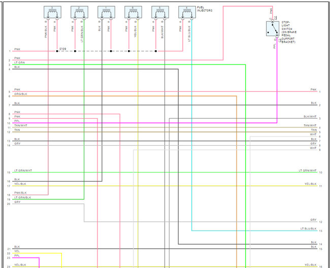

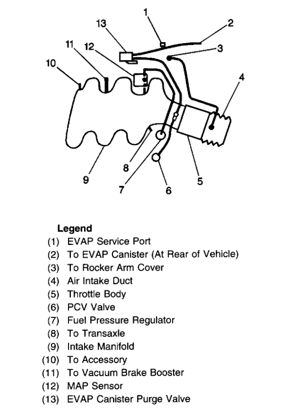

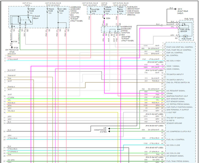

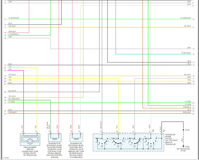

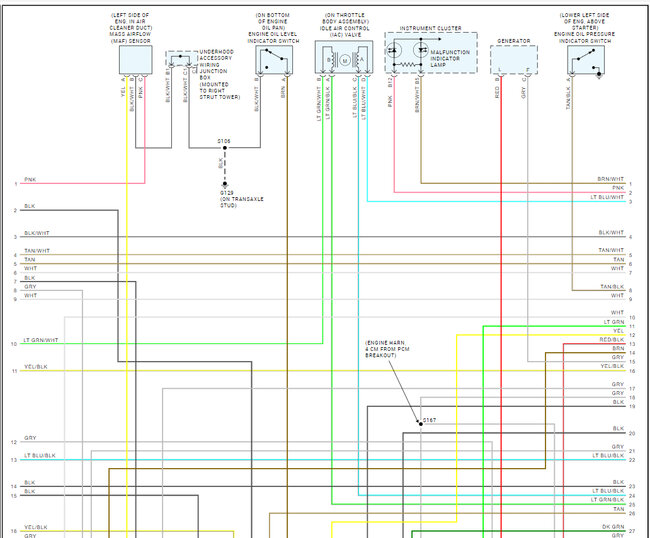

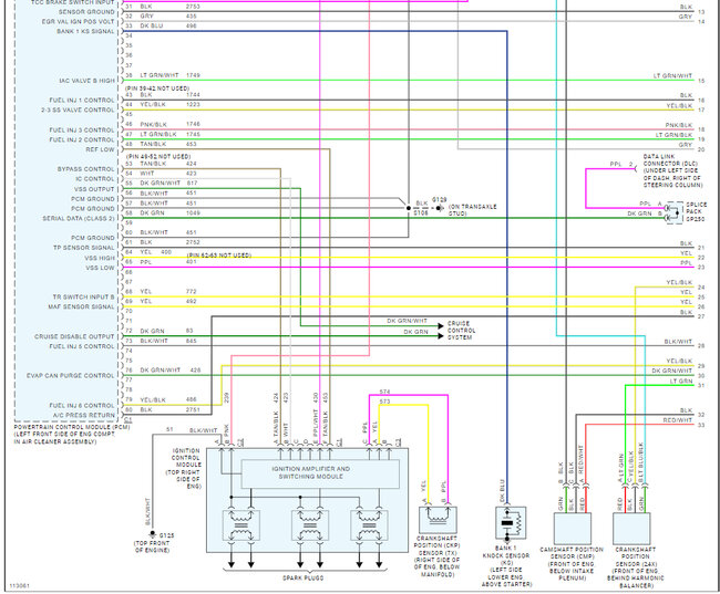

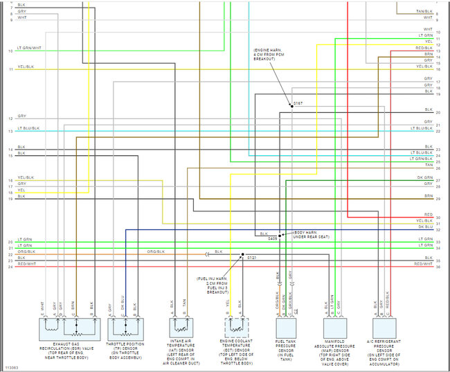

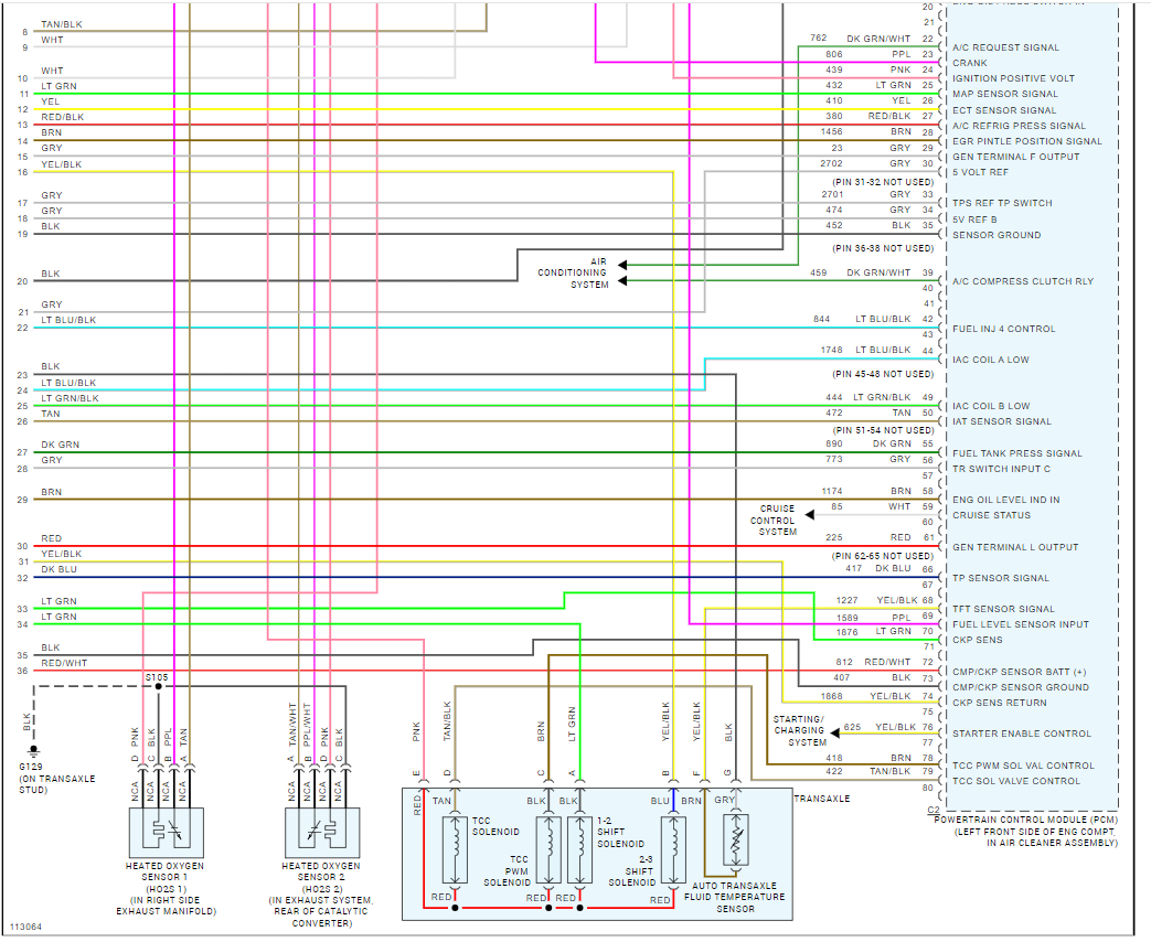

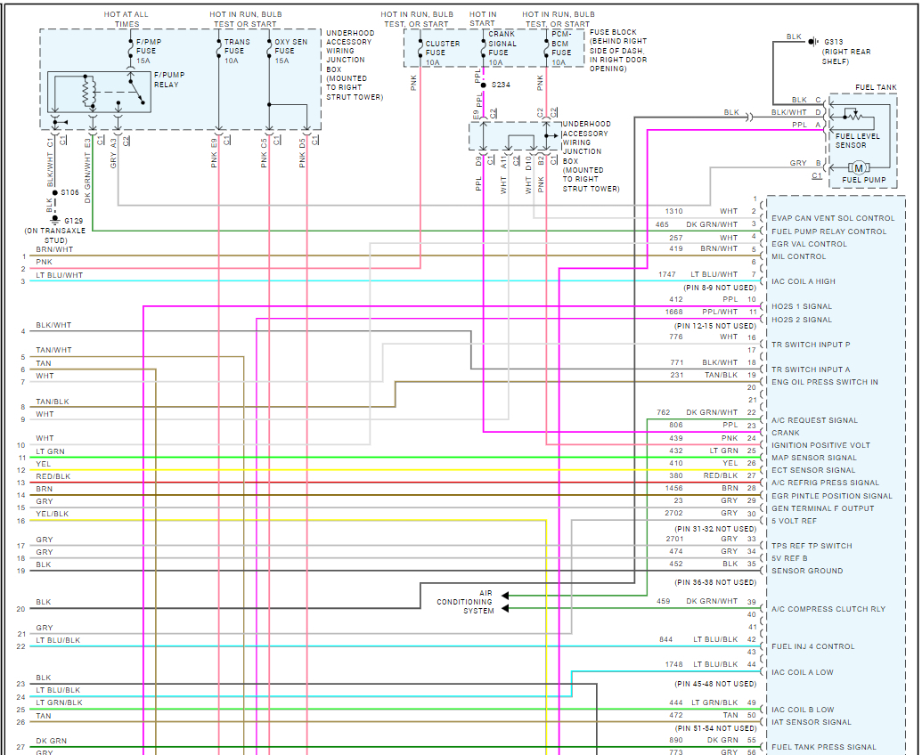

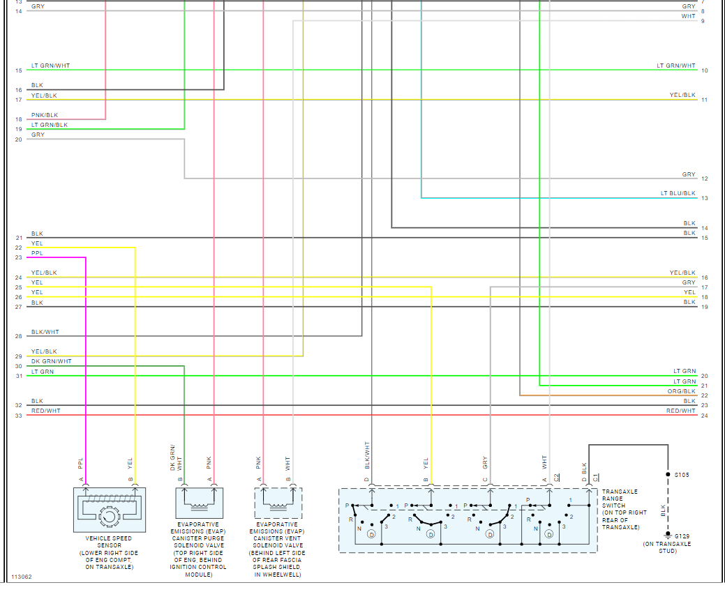

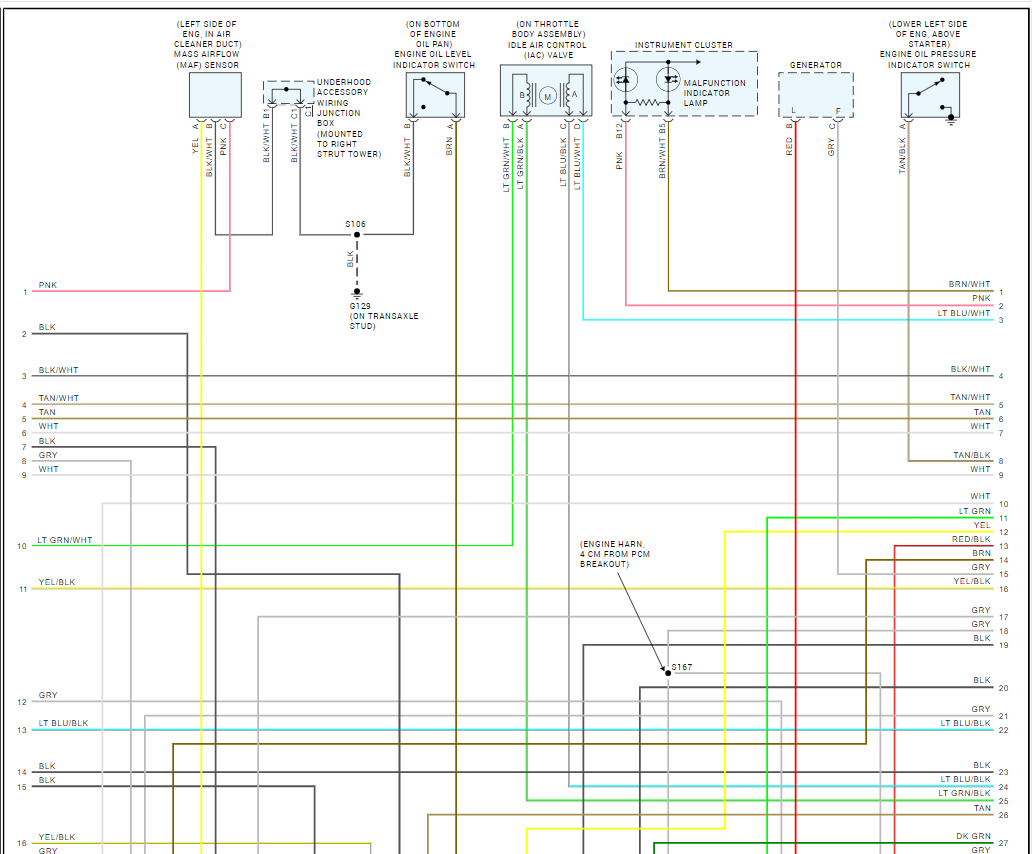

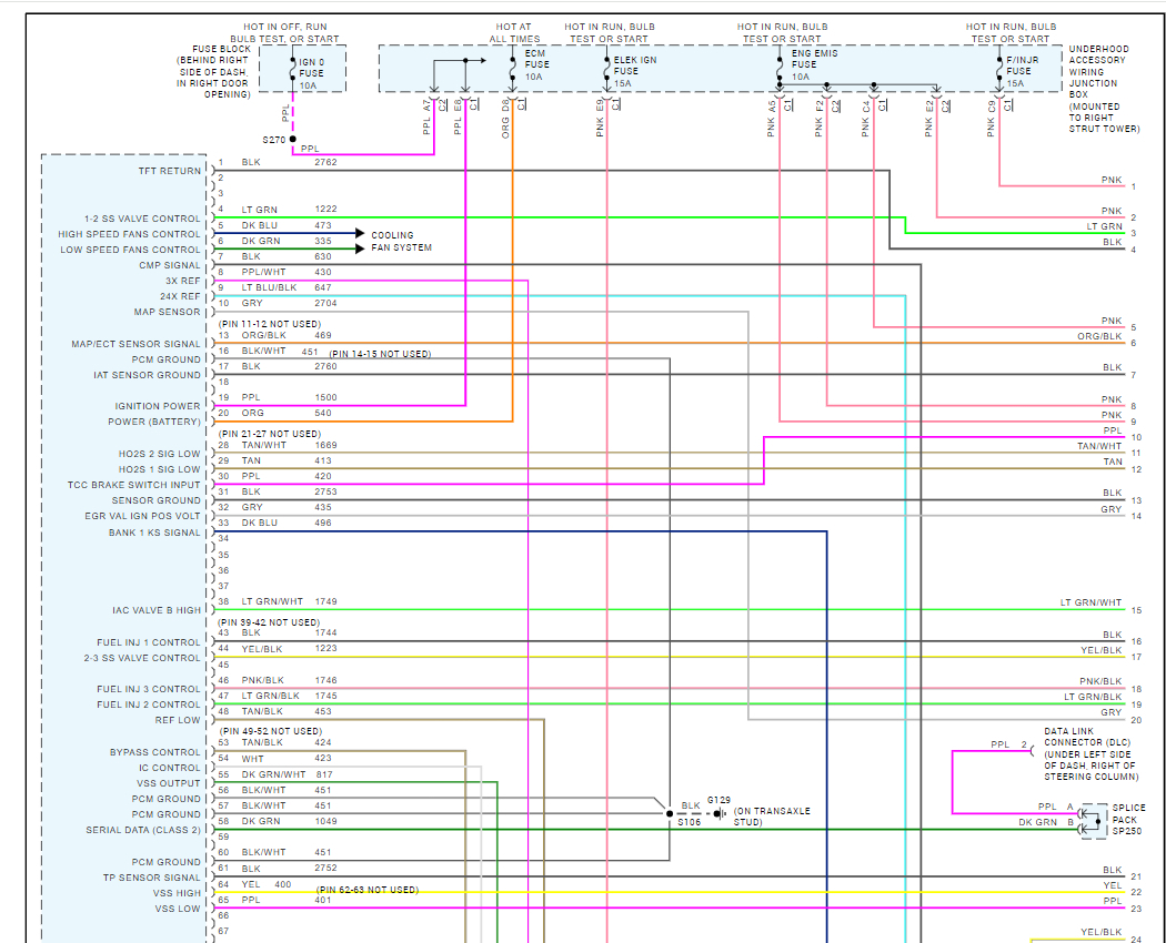

lol you are okay :) To me it sounds like the purge control valve is not working or you have a hole in the EVAP system somewhere.
The purge valve is top rear of the engine, behind the ignition control module, is that the valve they changed? The EVAP valves are controlled by the PCM so here is the engine and EVAP system wiring diagrams so you can see how the system works and which wires to test. Also, I have included this guide which can help you with the testing:
This guide can help as well:
https://www.2carpros.com/articles/evap-system-code-repair

Last week I asked you about error code No. P0446.
You sent me a lot of information and schematic’s, thanks, very welcome!
My friend the technician and I talked it over.
We decided to start from the beginning, the gasoline inlet.
Very thoroughly I cleaned the gasoline-inlet and put a piece of plastic film over it before closing it, to have some extra “grip” and closure.
Actually, this is the part that is often taken off, so worth trying.
Drove several times the past few days without opening the inlet.
So far: NO more error P0446!
Maybe we have found the problem, anyway, thanks for your help!
