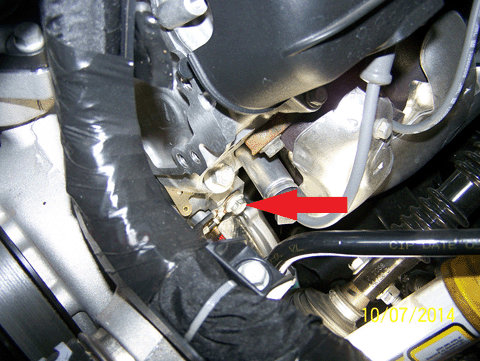

My vehicle feels like it is stuck at 3,000 rpm's and 40 mph and when I push harder on acceleration pedal it will slowly climb past 3000 rpm, but engine does not speed up nor does the transmission shift. Suspect a bad catalytic converter but could the bank 1 sensor 1 02 sensor cause this?

Your catalytic converter may have fallen apart causing an obstruction. There is a bulletin to check the coil crimps. Here is the bulletin with images.

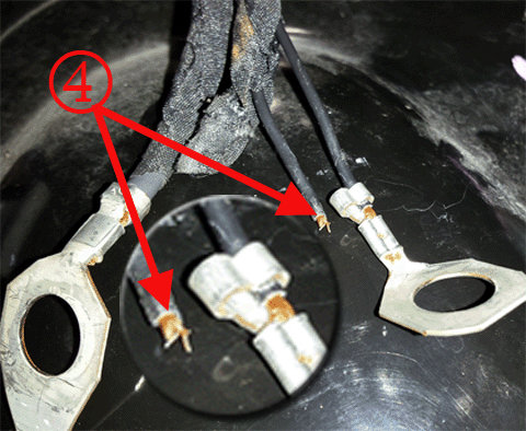

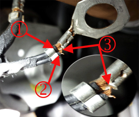

Condition/ConcernTechnicians may encounter a concern where the catalytic converter has come apart or has set a P0420 and/or P0430.
If you believe the catalytic converter has failed with no apparent reason, it is recommended to inspect for a poor crimp for the coil grounds terminal on the engine block for the bank with the concern.
Open In New TabZoom/Print
Technicians should inspect the ground for possible corrosion or damage at ground terminal ring, fasteners and grounding surfaces.
If no corrosion or damage is found, tighten the ground bolt to the proper torque.
Inspect the coil grounds and repair if before replacing the catalytic converter.
