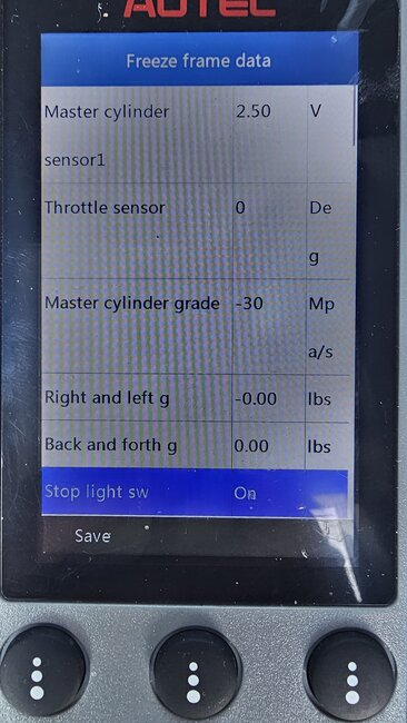

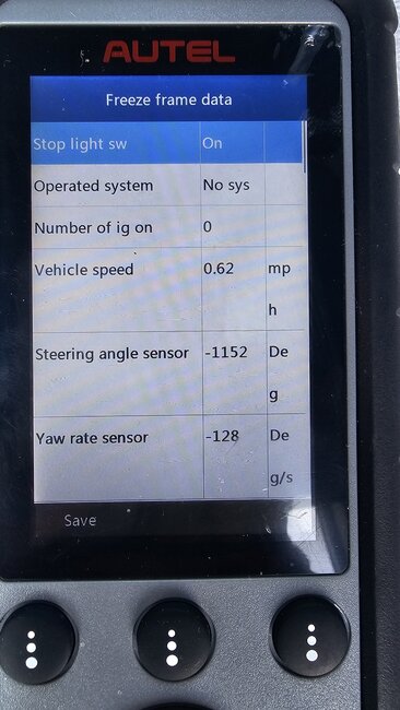

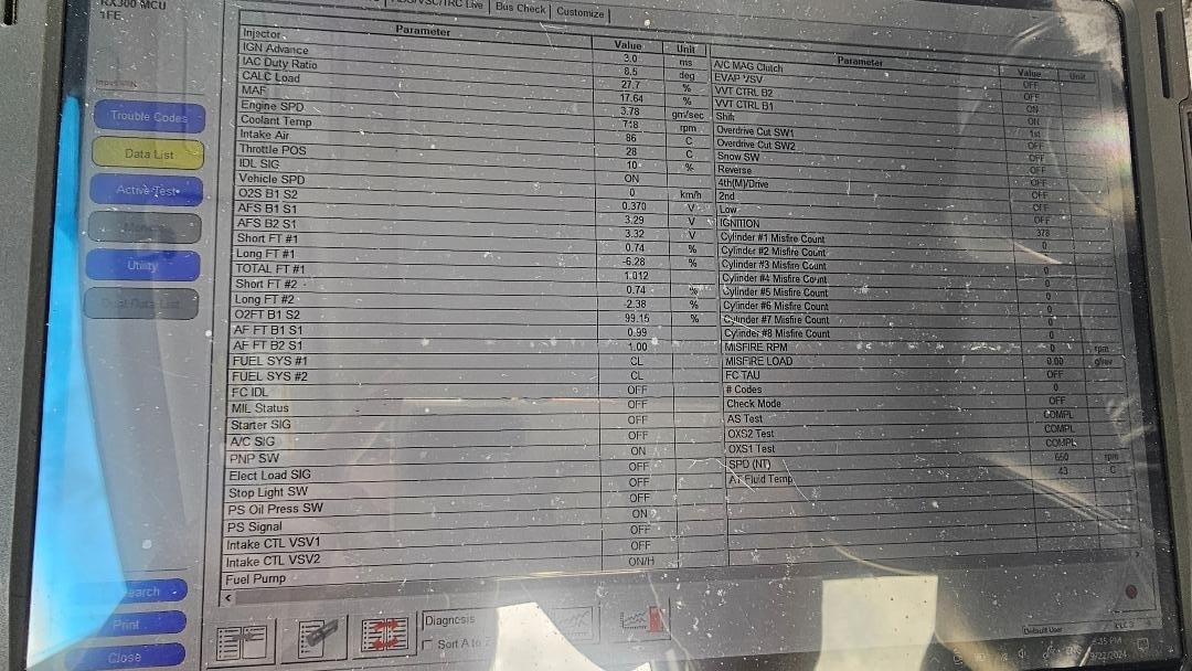

Vehicle suddenly show VSC on panel, and cut power. Transmission begin changing gears not smooth. Error code show c1203 or stomp code 53. No check engine. Check wires between ECU and SKID - all OK, communication OK until throw VSC on dash, then freezes and stay on same voltage. Error throwing when vehicle not moving, and nothing touched- only start engine. Replaced ECU, SKID, yaw, acceleration, VSS on transmission, check grounds, power to ECU and SKID. After each replacement proceed with zero ground reset. Difference is only time of throwing VSC. At the beginning it was almost immediately, after all changes - about 3-5 minutes after starting vehicle.
Freeze data show: vehicle moving 0.62mph, breaks pressed all the way, stop light on, vehicle spinning, steering wheel turned all the way (show correctly only after 24mph per specs).
I have attached freeze data.
Please advise where to look, currently I'm completely lost.

Here is freeze data.
Thank you!

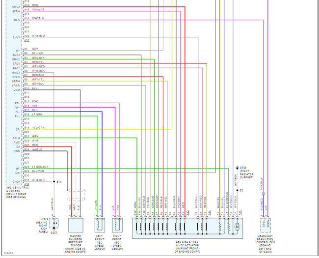

Yep, this is the problem.
The C1203 error code indicates a "Engine Control System Communication Circuit Malfunction."
Communication issues between the Engine Control Module (ECM) and the ABS/Traction

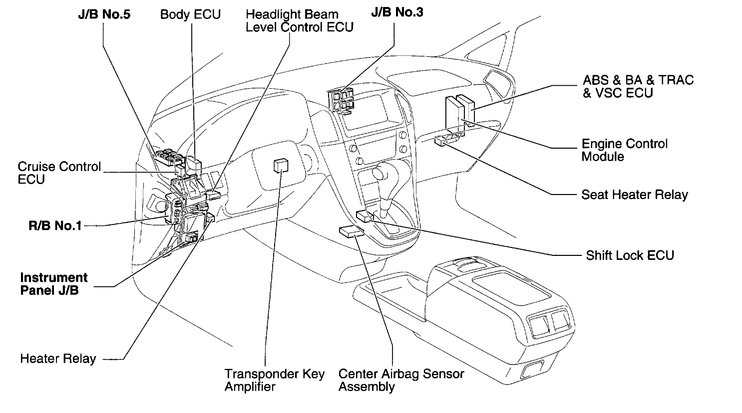

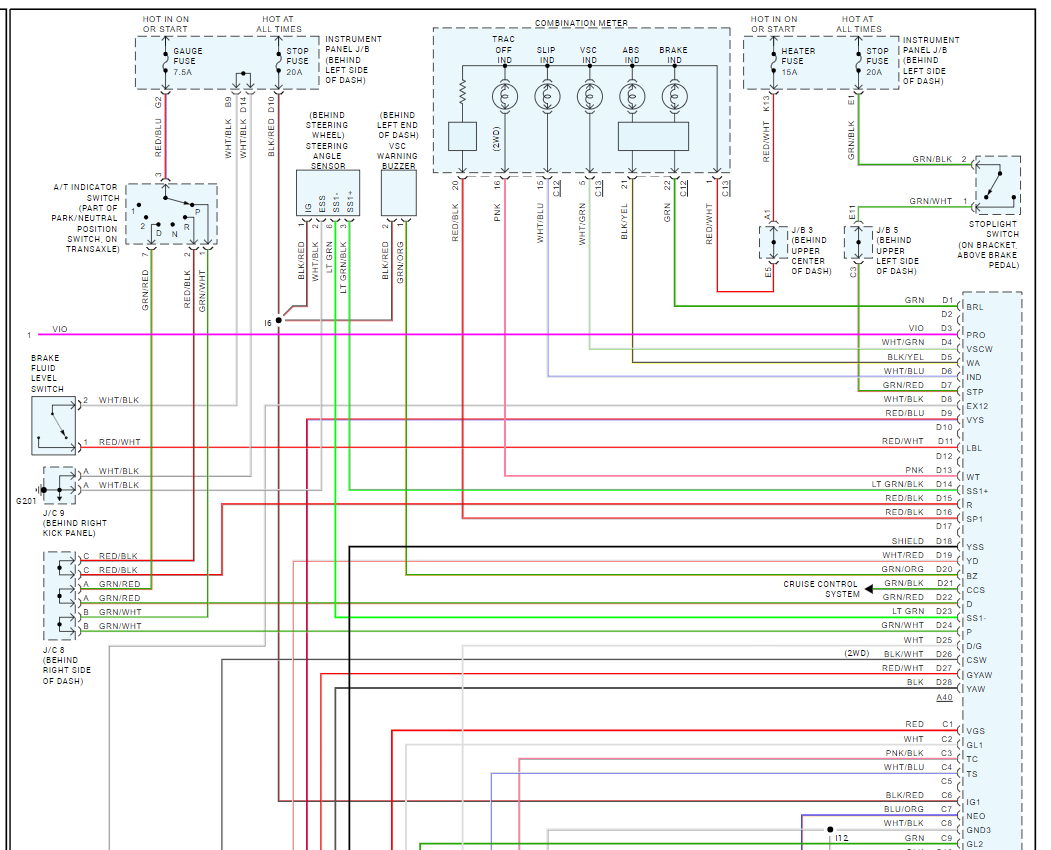

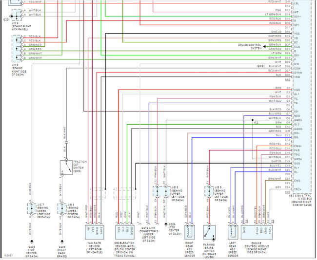

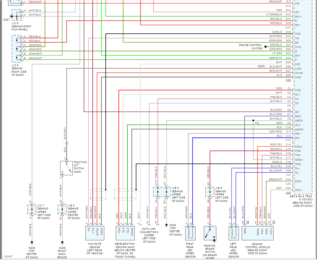

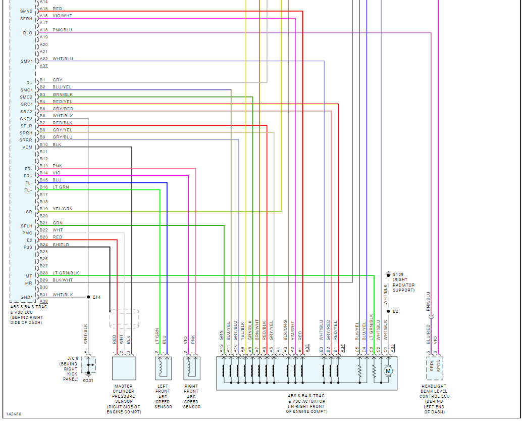

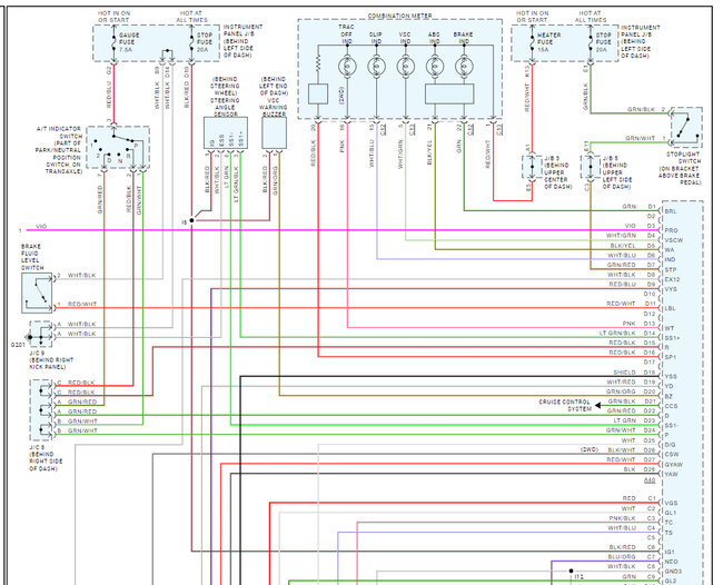

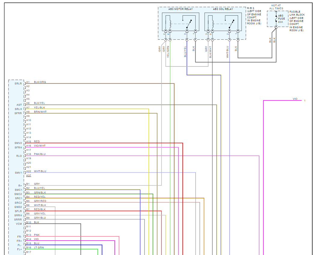

I would recheck the ABS fuses and I would swap out the ABS motor relay and the ABS sol relay. Here are the ABS wiring diagrams so you can see which fuses to check and a guide to help check for power and see how the system works.
Chances are the VSC ECU has gone out, but we need to make sure the power and grounds are good. Check out the images (below). Please let us know what happens.

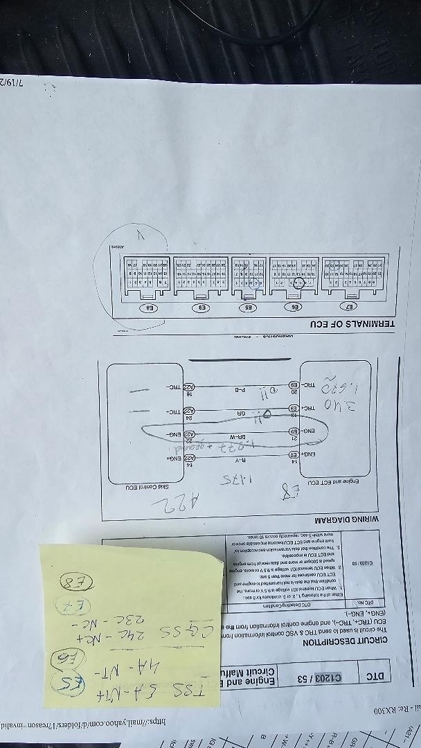

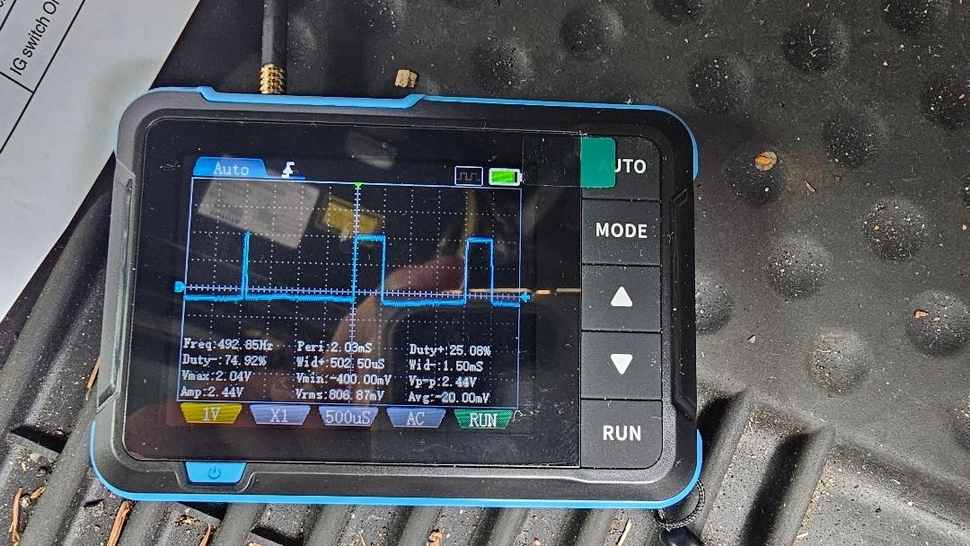

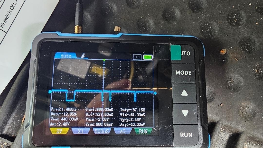

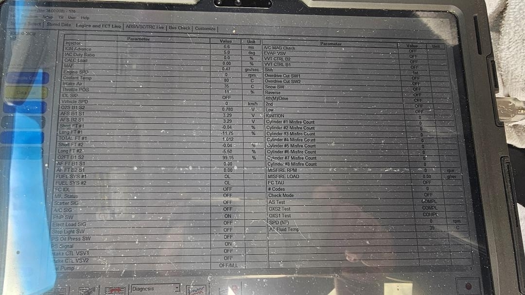

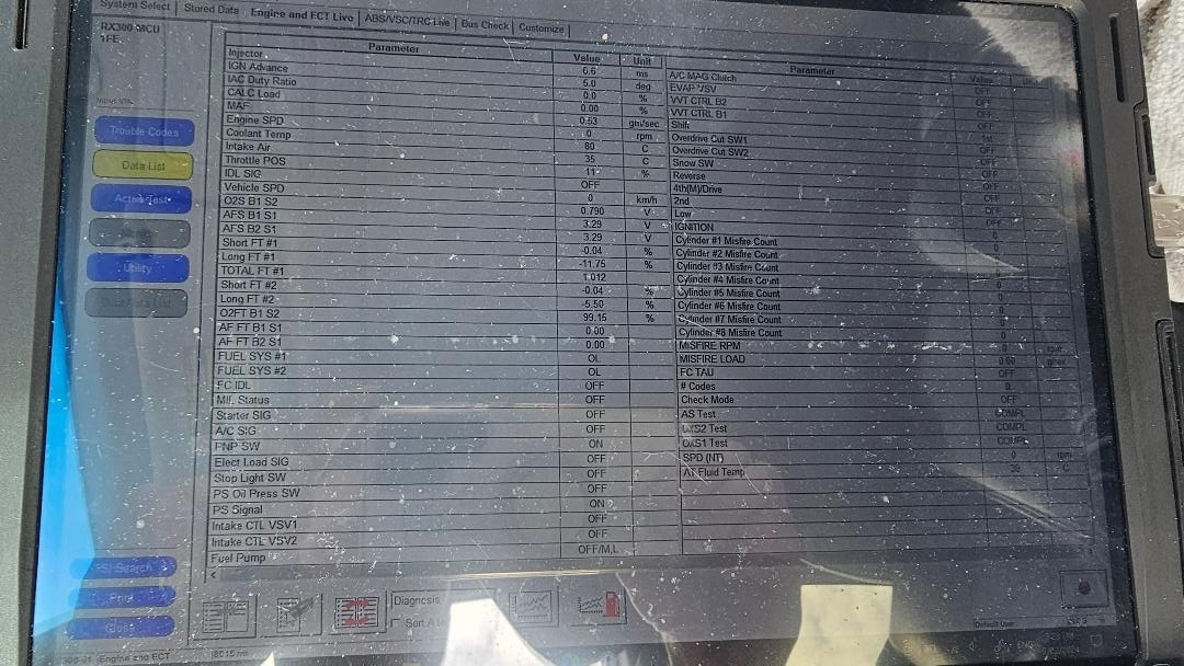

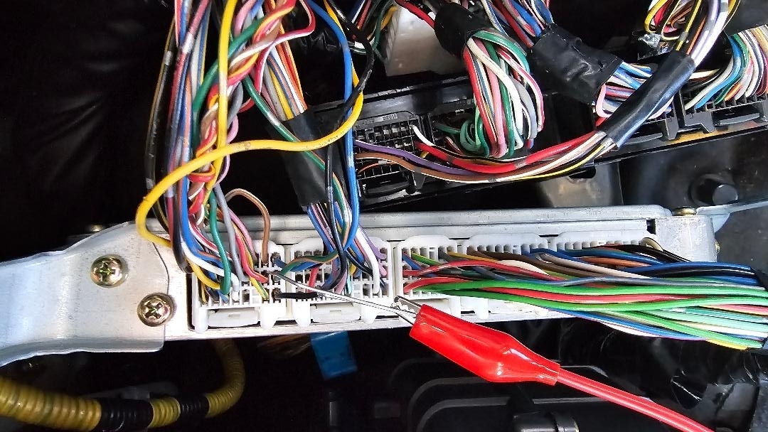

When I check all readings on ECT ECU and then on SKID, I found that RPM’s on ECT ECU is stable and equal to tachometer readings, but readings of RPM’s on SKID is all the time jumping from 0 to 1400.
I check wires from VSS to ECT ECU and SKID all show stable readings around 1.2-1.3Ohms, no shorts to ground or each other.

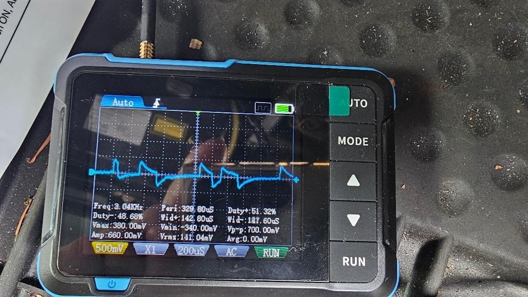

Also, I bought cheap oscilloscope and check readings from VSS on ECT ECU side.
TSS – NT+ show nice sinusoid; NT- show spiked sinusoid with garbage signals.
CGSS – NC+ show crazy sinusoid, with spikes, garbage signals and voltage jumping up and down.
I swap VSS, CGSS signals get less garbage signals but still have spikes and voltage jumping.
Unfortunately, I did not make a pics for it.
Then I begin check communication between ECT ECU and SKID, and during this test tachometer needle begin jumping, but VSC error did not show up at least 20 minutes, once I remove “probe” it throw VSC within 1 min.
1- ECT ECU readings before start
2- same
3 – ECT ECU after start
4- SKID before start, error already registered but not throw VSC on dash
5 – SKID after start, ECT ECU show around 760 RPM, on SKID – 319 RPM
6 - SKID after start, ECT ECU show around 760 RPM, on SKID – 0 RPM

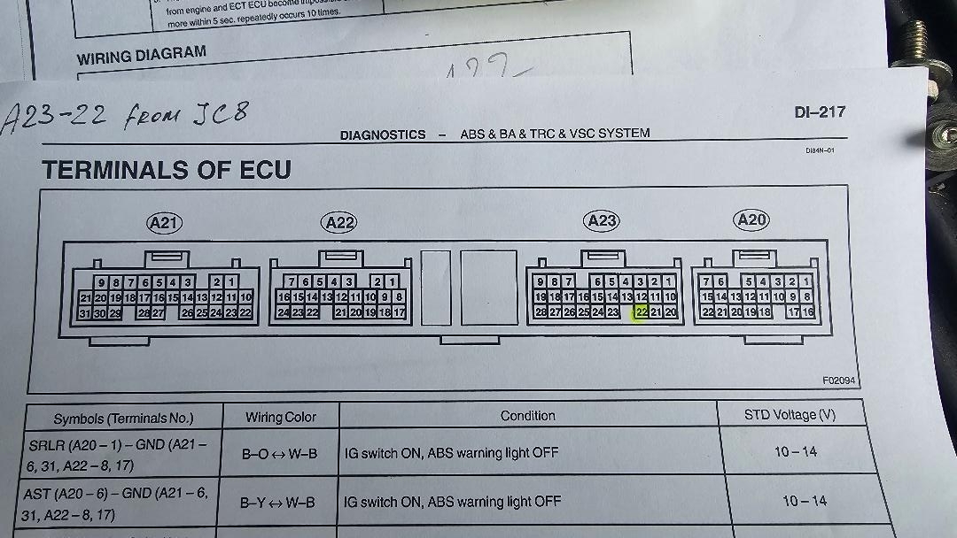

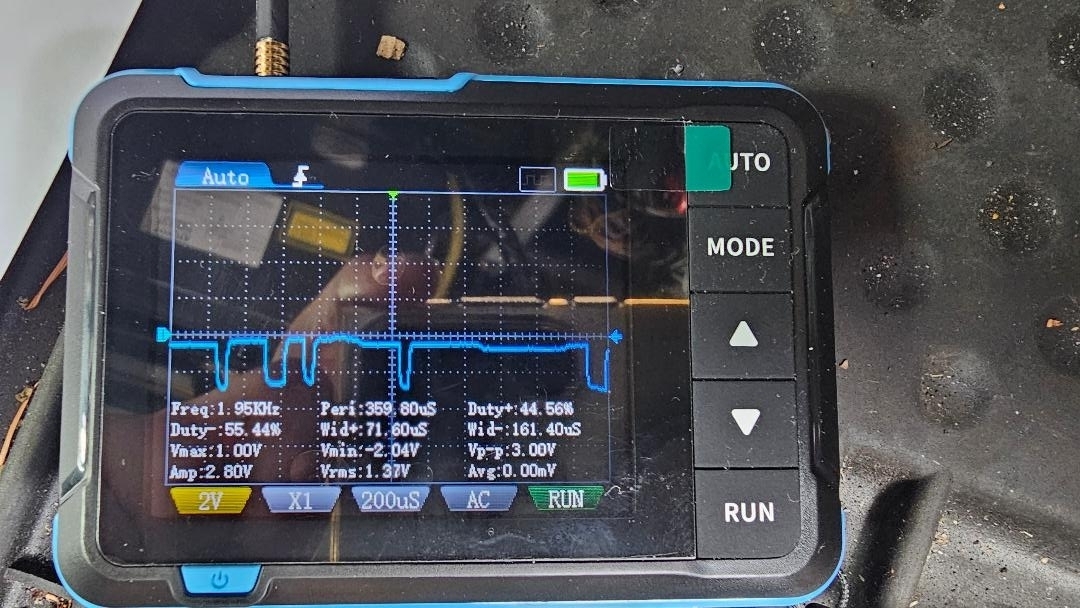

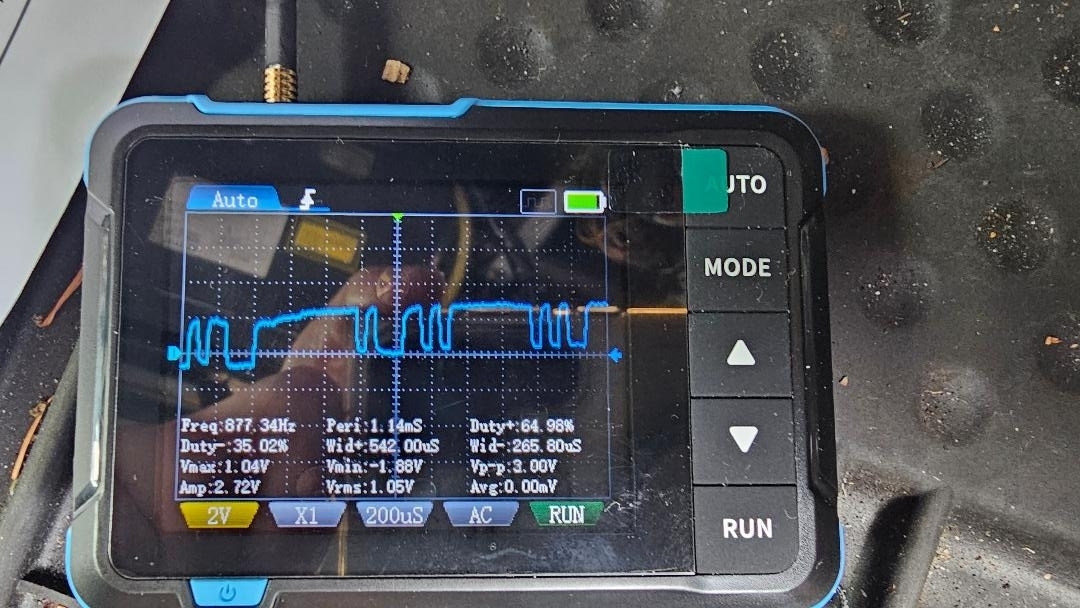

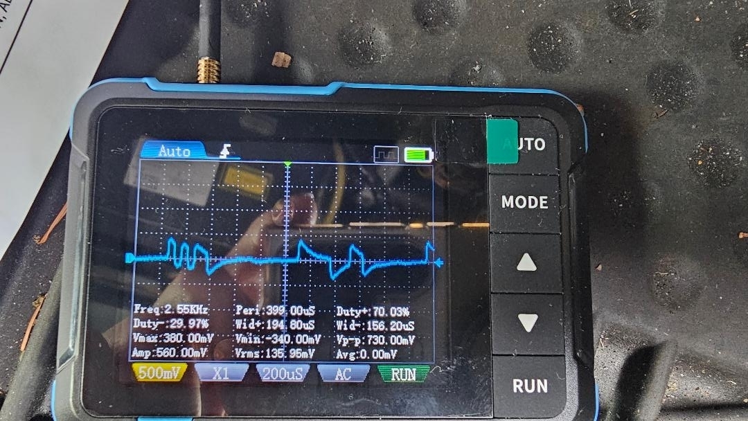

I believe tachometer needle begin jumping when I read this pin – E8-14 (ENG+)
Readings on oscilloscope on TRC+, TRC-, ENG+, ENG- - I already confused which one which, I believe I write down in correct order as pics taken.
Since on different parts even of the same manual connectors shown under different labels, I had to mark it in same way.
I feel this issue related to different readings of RPM’s on ECT ECU and SKID.

Add pics
Sep 23, 2024 at 11:16 AM
  • 55,423 POSTS
Yep, these reading look okay except for the VSC ECU. If the power, grounds and connections are good I would try a rebuilt VSC ECU.

Good morning, Ken,
I had not many time to work on this vehicle this weekend.
However, I re-check all power and grounds, all seems okay.
I unplug A22 connector from SKID - the one which holds communication wires from ECT ECU.
Start the vehicle and check signals (oscilloscope) with unplugged connector on communication wires: ENG+/- seems have same signal pattern, and TRC+/- seems have same signal pattern.
I know how is looking CAN-bus communication (mirroring signals) on oscilloscope, but here is different, +/- show same pattern.
NEO show something weird - completely random signals.
Is it suppose to be like that with unplugged connector? I thought TRC+/- and NEO is signals from ECT ECU and expected signals from it, but TRC+/- should be signals from SKID, which is unplugged.
Also, do you know what is NEO signal?
Had no time to check Steering Angle Sensor, but begin suspect root might be there, since everything else has been checked/replaced.
