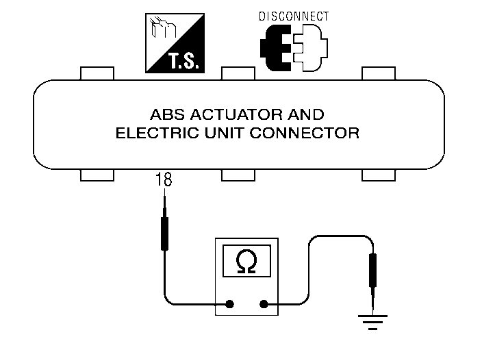

Not sure what TCS control channel “A” valve 1 subfault means?

The code that came up was C0001 TCS control channel A valve 1 subfault.
Dec 1, 2020 at 8:05 AM
  • 110,193 POSTS
I'm not sure why, but I am not showing that code for this year make and model. I suspect it is referencing the ABS actuator solenoid valve. BY any chance, do you know the two or three-digit manufacturer code?
Here are the diagnostics for the ABS actuator solenoid. Let me know if this helps. Also, the attached pics correlate with the directions.

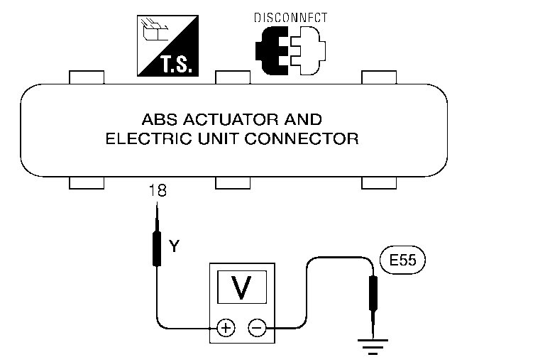

5. CHECK SOLENOID VALVE POWER SUPPLY CIRCUIT
1. Disconnect ABS actuator and electric unit connector.
pic 2
2. Check voltage between ABS actuator and electric unit connector E55 terminal 18 (Y) and ground.
Does battery voltage exist?
YES >> Replace ABS actuator and electric unit.
NO >> Check the following.
^ If NG, repair harness or connectors.
- Harness connector E55
- Harness for open between ABS actuator and electric unit and fusible link.

7. CHECK SOLENOID VALVE RELAY POWER SUPPLY CIRCUIT FOR SHORT
pic 3
1. Disconnect battery cable and ABS actuator and electric unit connector.
2. Check continuity between ABS actuator and electric unit connector E55 terminal 18 (Y) and ground.
Continuity should not exist.
Does continuity exist?
YES >> Check the following.
^ Harness connector E55
^ Harness for short between ABS actuator and electric unit and fusible link.
NO >> Replace ABS actuator and electric unit.

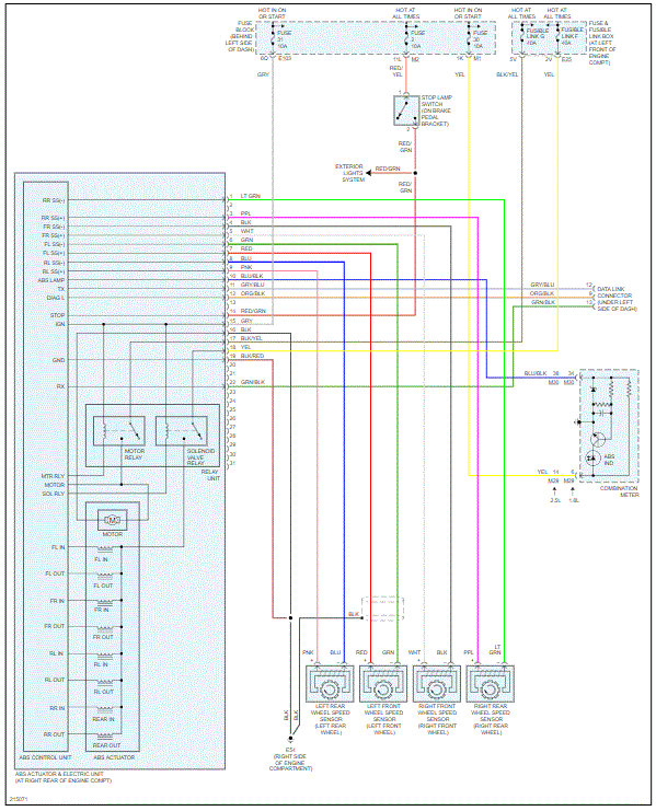

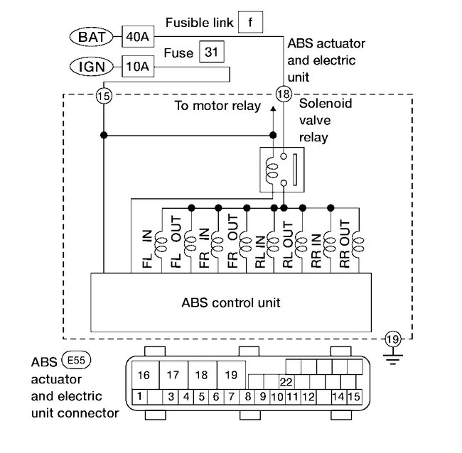

If you look at pic 4, it shows the entire wiring schematic related to the traction control and ABS.
