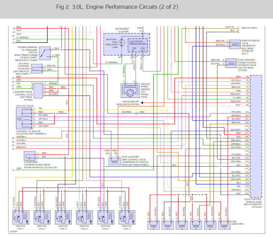

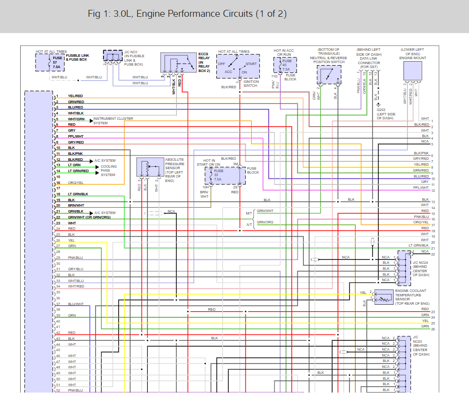

I didn't have enough time after the new year break, anyway I finished the skyline head installation last week. After the head removal we noticed the head gasket had been blown and couple of valves found leaking during the vacuum test. Head was repaired by a pro, the repair involved resurfacing, valve grinding and clearance setting. After completion of the head installation job the car started straightaway but the power was not enough when driving. The check engine light was on. ( check engine light was appearing before the repair work also.) I checked the sparks. Two of the spark plugs (5 and 6) had no indication of firing. As all spark plugs are new and after finding the power and earth good in the wire harness, I suspected the coils. After replacing the coils with the new ones the power is back but the check engine light keeps coming on. All cylinders have 180 psi compression. Car is running perfectly.
The error code is 21 which is for "Ignition primary signal" . Cleared the cord but reappears.

The valves and head gast are time/mileage related and there is not to much that can be done about that. As far as the code goes try to clear it now that the engine is running good. This code is triggered when the ignition system has a spike. Do you have new plug wires, coil wire?

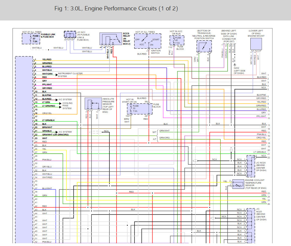

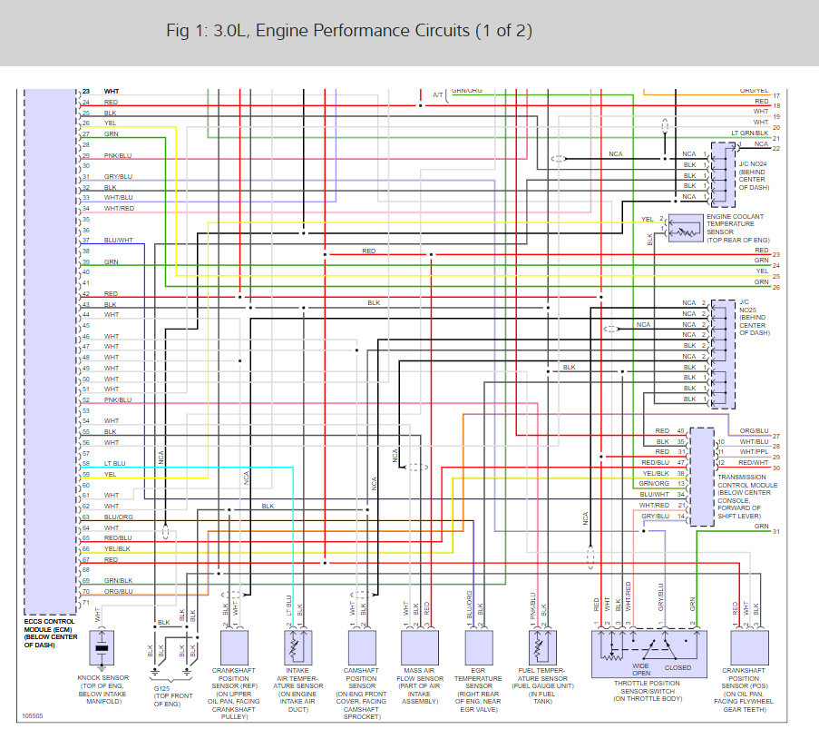

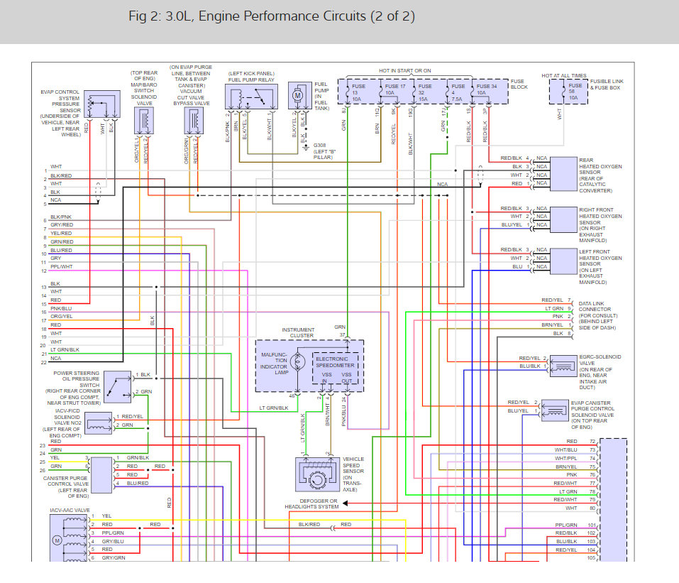

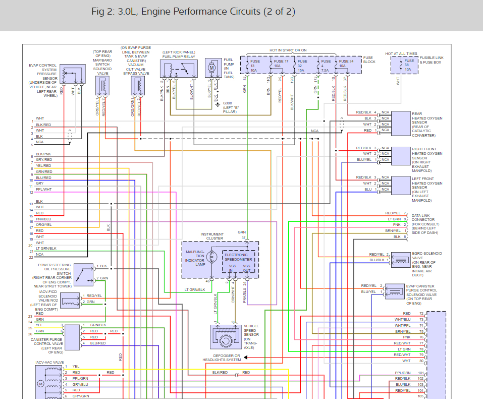

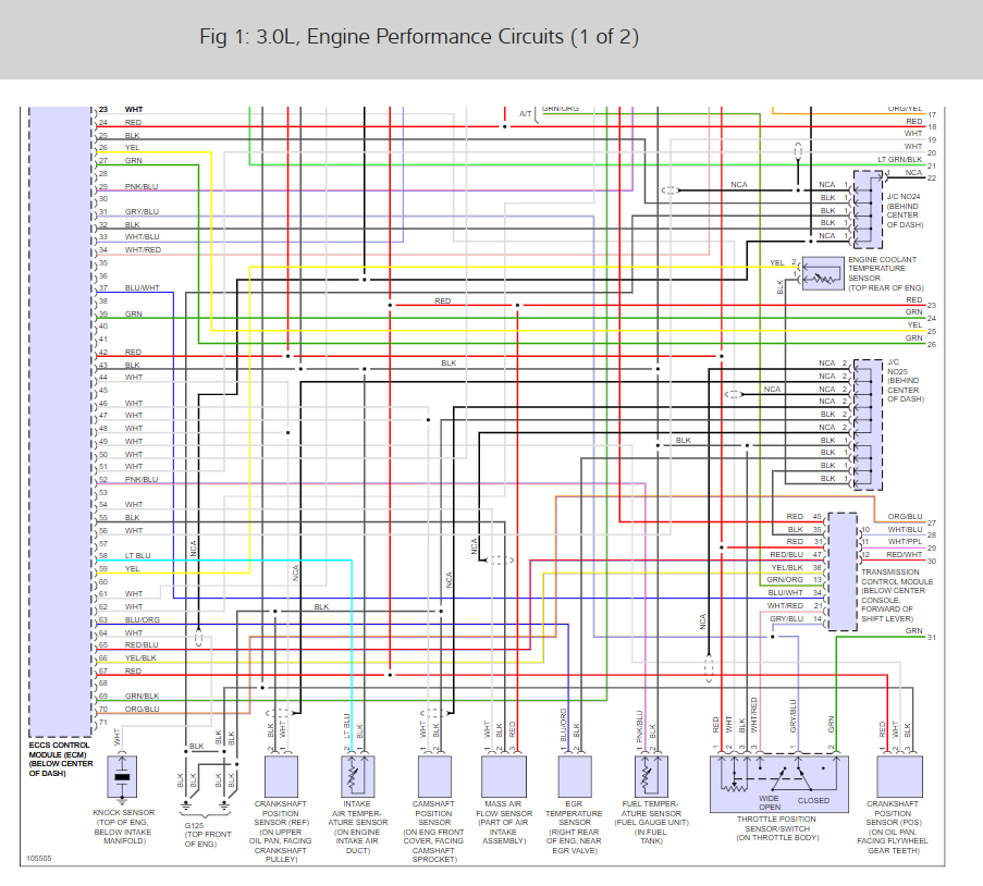

Coil on plug system. Replaced all coils with new one but the wire harness is not replaced. I think that the ECM controls the ignition and there is no ignition module.
So do you think the problem is with the coil wire harness?
Feb 9, 2019 at 8:04 PM
  • 55,214 POSTS
Yep, it sounds like you have high resistance in one or more wires. here is a guide to help you test with the engine wiring diagrams below:
Check out the diagrams (below). Please let us know what you find.
