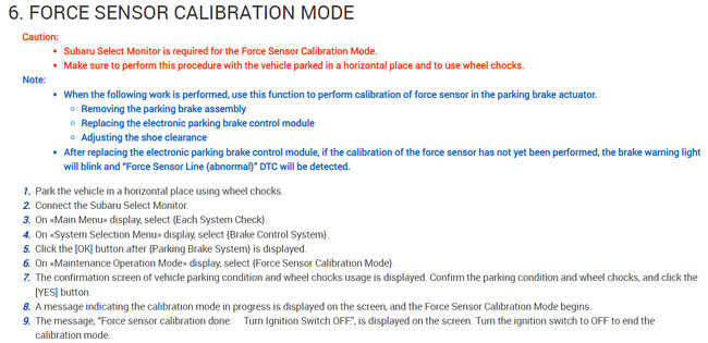

Replaced rear brake pads and rotors. The brake light is now flashing. After looking that up I found that it is for the electric parking brake. It is functional and the brakes work well. Everything I can find says I need a bidirectional scan tool to reset the light, but I am hopeful there is a cycle of buttons or key turns that will clear the codes without the expensive tool.

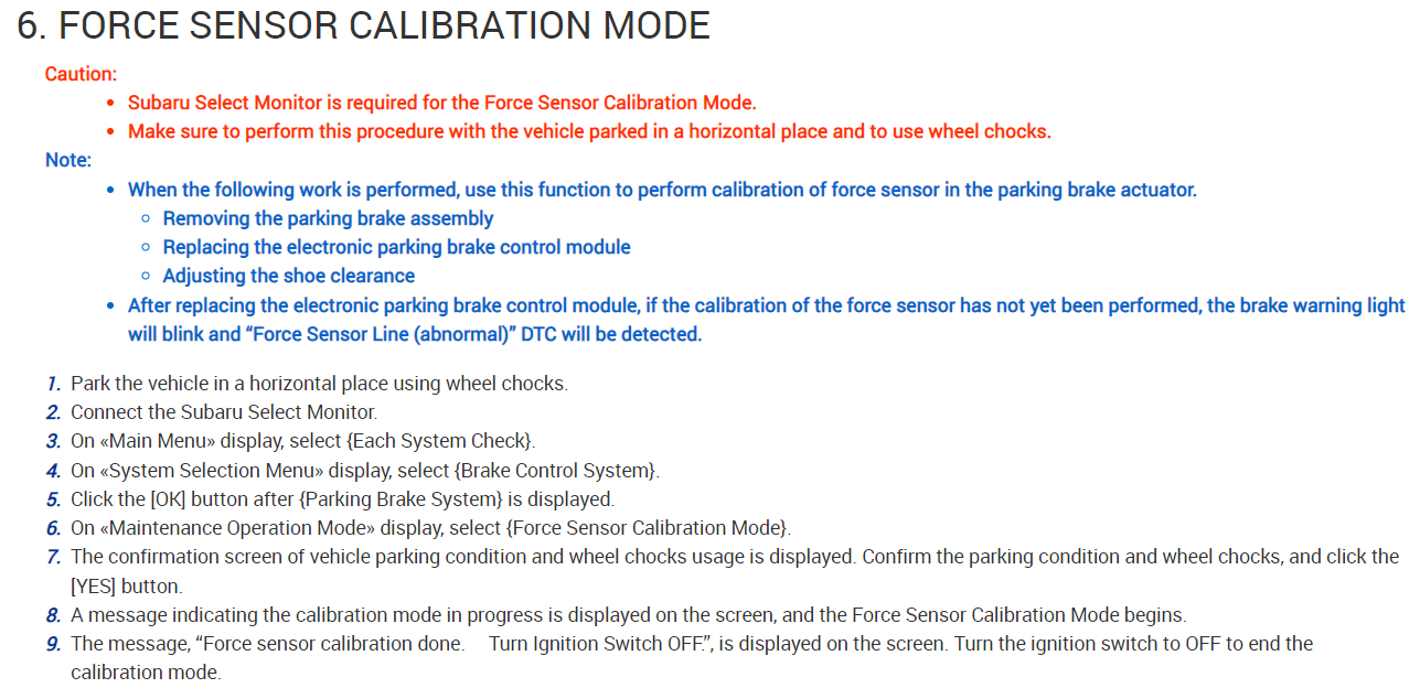

You can try leaving the battery disconnected overnight as well. Here is what AllData says for a forced reset. Check out the images (below). Let us know how it goes.
