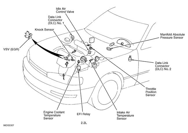

Cooling fans run all the time, Removed relays, fans stop, checked what I thought was temp sensor, was closed but fans still run, probably temp gauge, what turns fans on? Sensor? Location?

Hi:
The cooling fans are powered by the PCM. A temp sensor sends a signal to the PCM indicating coolant temp. Once a certain temp is reached, the PCM sends a signal through the fan relay which then sends power to the fans.
I need to know what size engine this vehicle has to provide sensor locations.

2.2 litre 4 Cylinder, 1998 Camry LE
The A/C is unplugged also, the condenser coil took a hit and I have not replaced it, would this also cause the fans to run constantly?
+1
Friday, August 29th, 2014 AT 4:06 AM
  • 109,896 POSTS

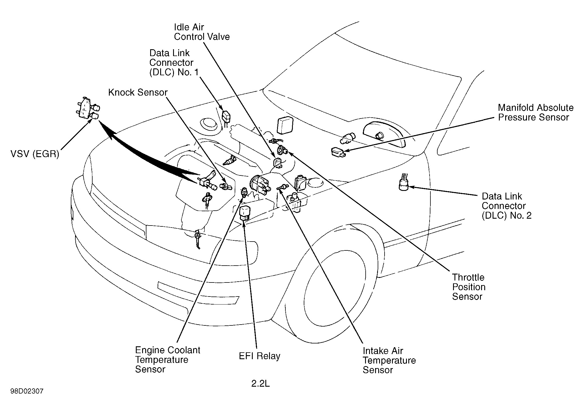

I don't feel that would cause them to stay on. As far as the sensor, it should be located on the top rear of the engine. See the pic attached.
