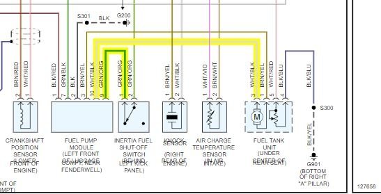

Good afternoon,
Do you have a voltmeter or test light to do some checks?
P1237
Descriptor
Fuel Pump Secondary Circuit Malfunction
Probable Causes
Circuits Associated With Fuel Pump Relay (For LS6, LS8)
Fuel Pump Circuit Open or Shorted
Fuel Pump Driver Module (FPDM) Damaged
Fuel Pump Power Circuit Open or Shorted
Fuel Pump Return Circuit to Fuel Pump Driver Module (FPDM) Open
Fuel Pump Rotor Locked

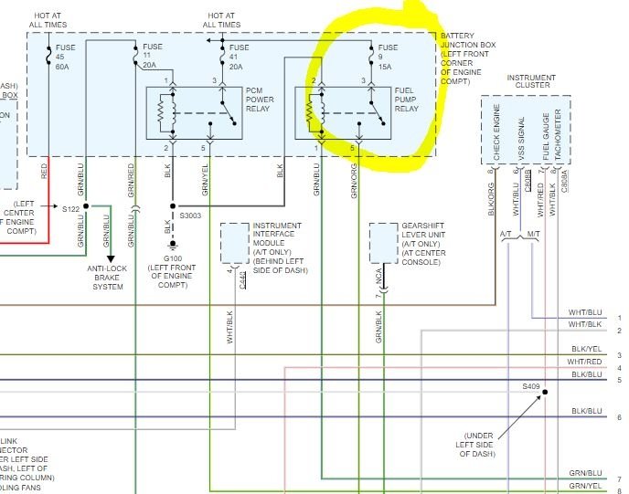

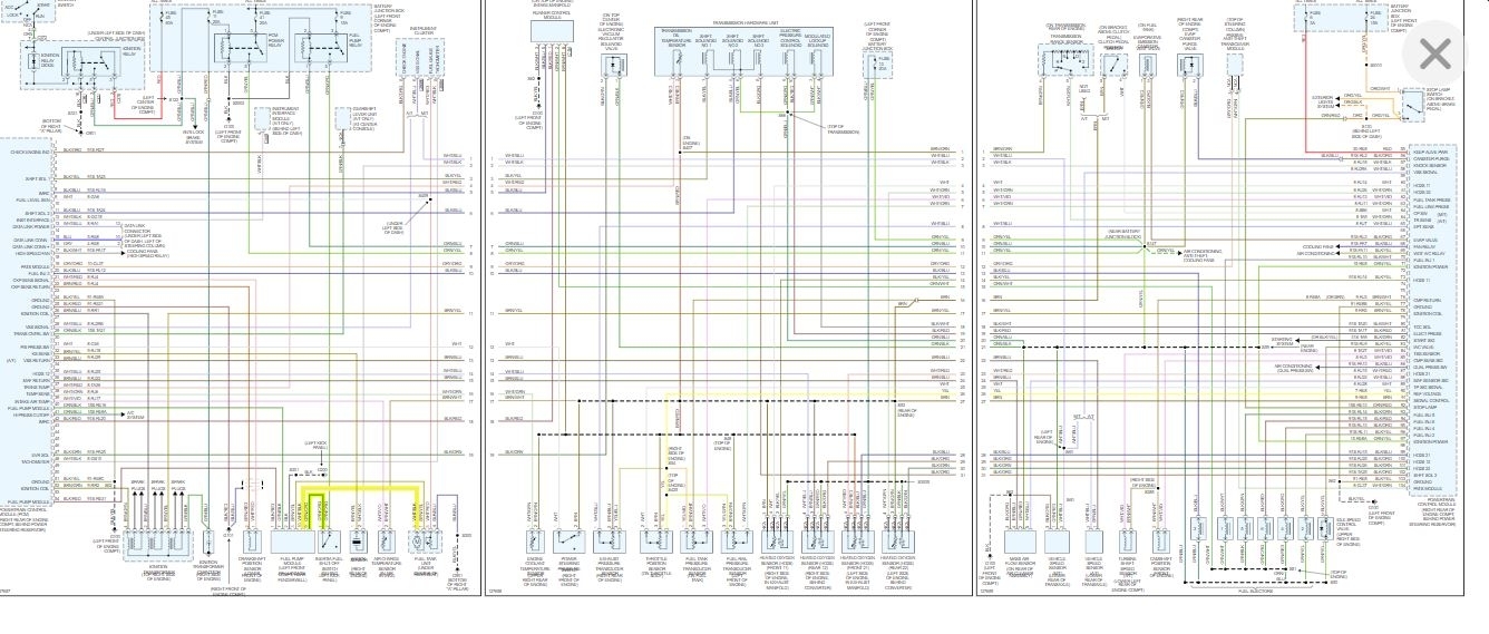

I attached a wiring diagram. You need to verify the fuse circled has power on both sides. The wires at the module need to be confirmed as well. They should be hot in the start mode.

Put the black lead on a good body ground and the red on the terminal. Check the voltage at each pin.

It looks like you have power to the pump from the module.
I would replace the pump.
